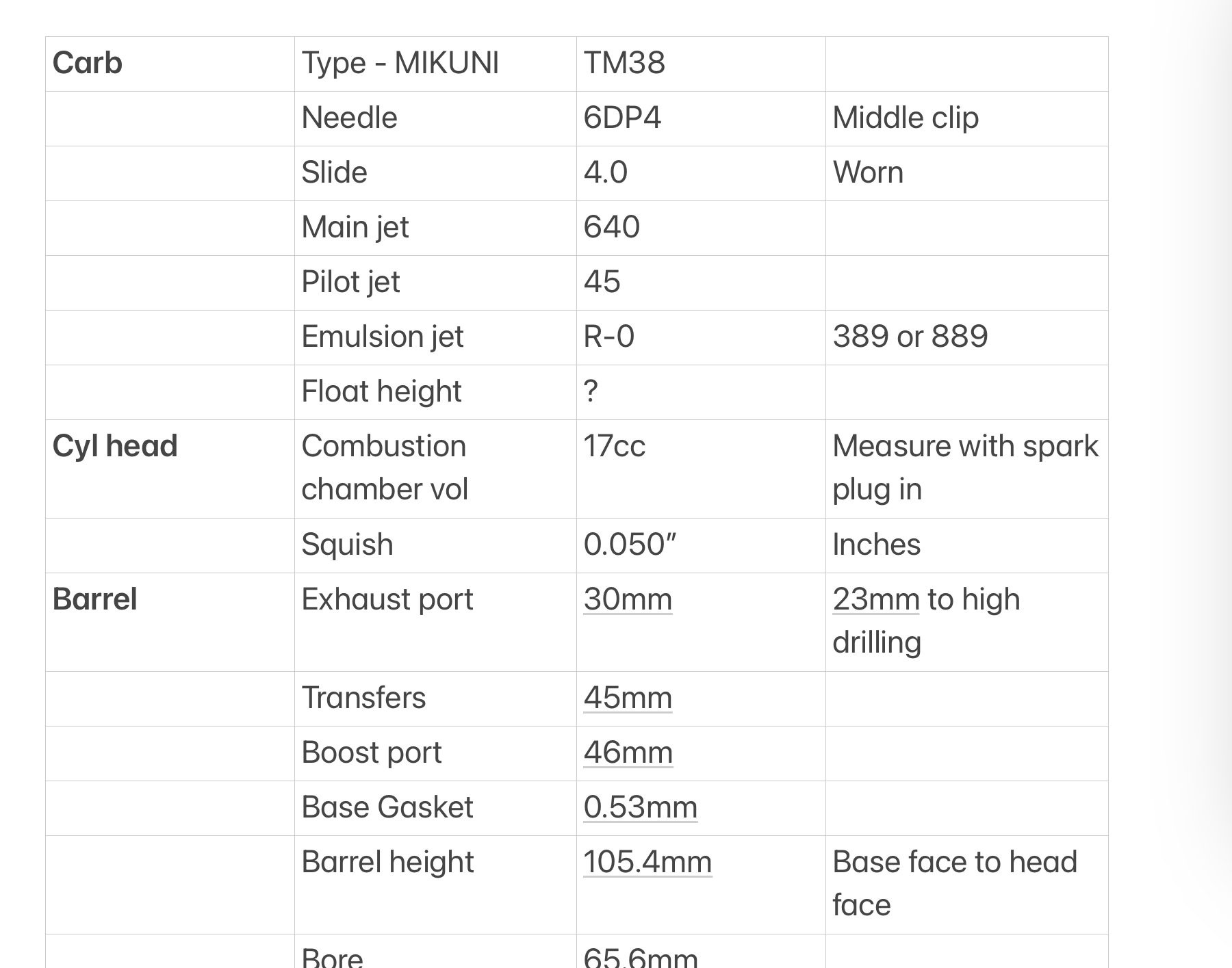

I have been trying to track down the original engine tuner (Harry Barlow) since I collected the bike, just so I know what’s been done and what to watch out for when put it on the dyno..
Even though he did this RD engine and pipes in the mid to late 80’s, I was able to see that he had gone to America for a few years and worked there tuning RD s and LC race bikes before combing back to the uk and working more in the scooter tuning and race world.
But Despite the power of the internet, every lead on RD and scooter forums and googling his name only came up with landlines that are no longer in use, but last night someone gave me a mobile number that they had used 2 yrs ago to talk with Harry.
So I called the number and it just rang out, no voice mail etc :( , but before I gave up on that as another dead end, I send a text message describing who I was and why I was after him….. 10 hrs later I get a reply :D
Turns out he is in Thailand at the moment sourcing new suppliers & tuning parts and combining it with a long holiday, and he still has his old RD400 drag bike which he still intends to return to the track to reclaim his class record with some serious upgrades like billet cranks etc.

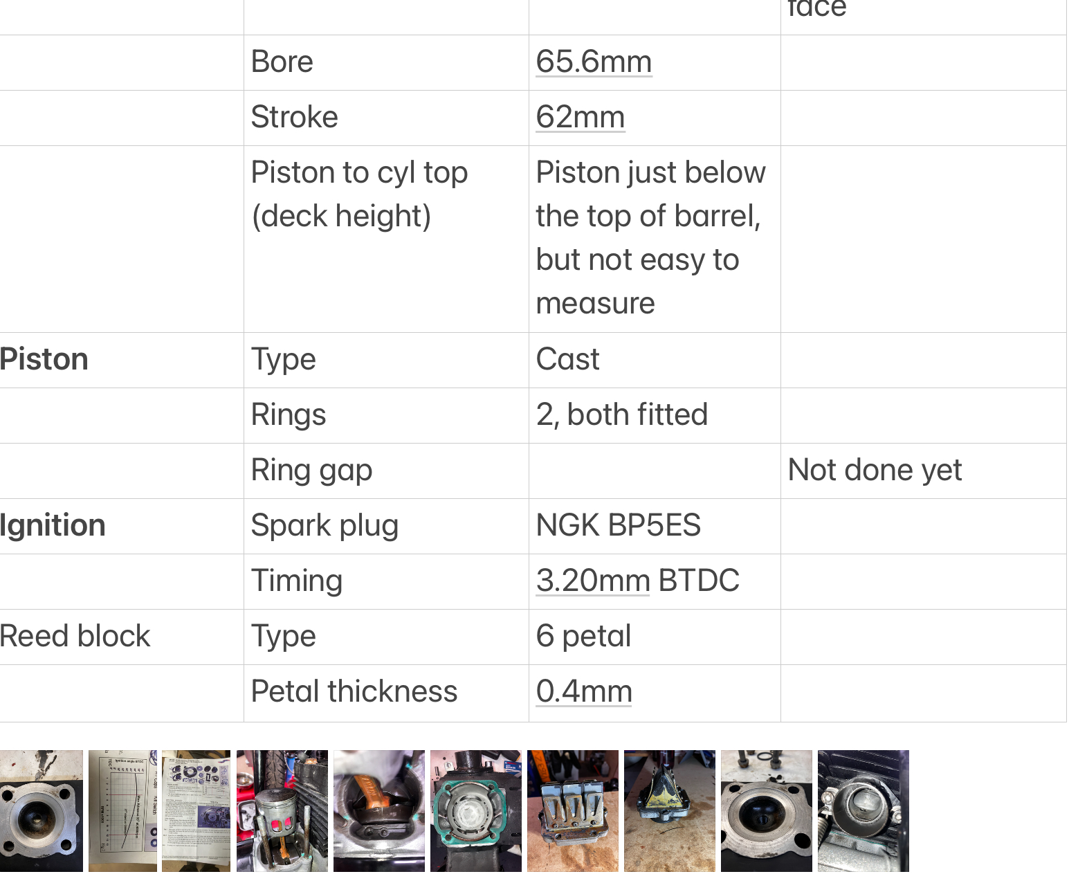

So as you can imagine, he can’t remember what specification was state of the art thinking back when he did this engine, so after a 30min conversation at midnight his time, he made me realise this is a serious motor that will need careful setting up, and he needs to know the baseline he is starting from. So he set me a lengthy list of measurements that he needed from the internals of the engine and once he has got them we will talk again :thumbup:

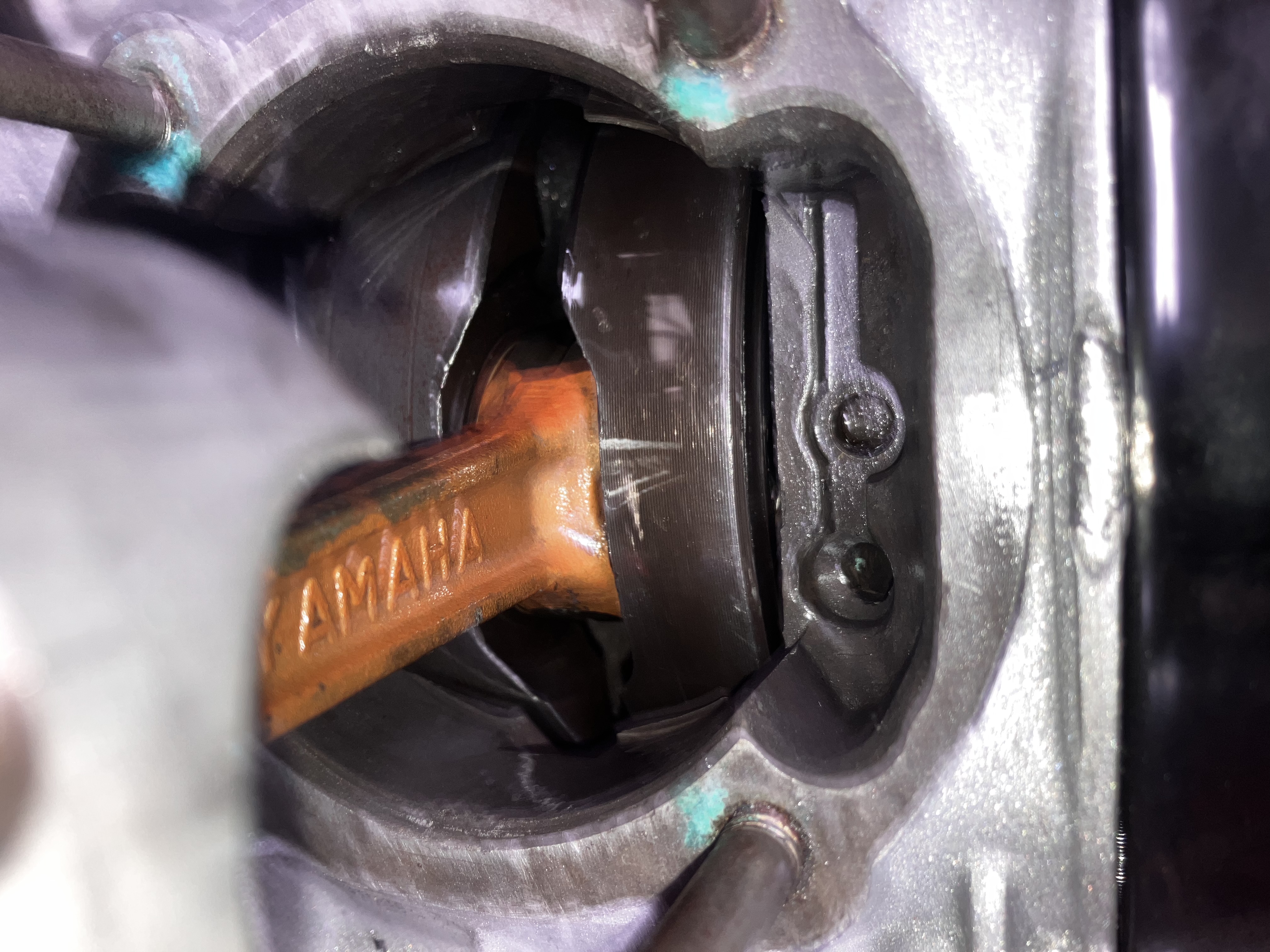

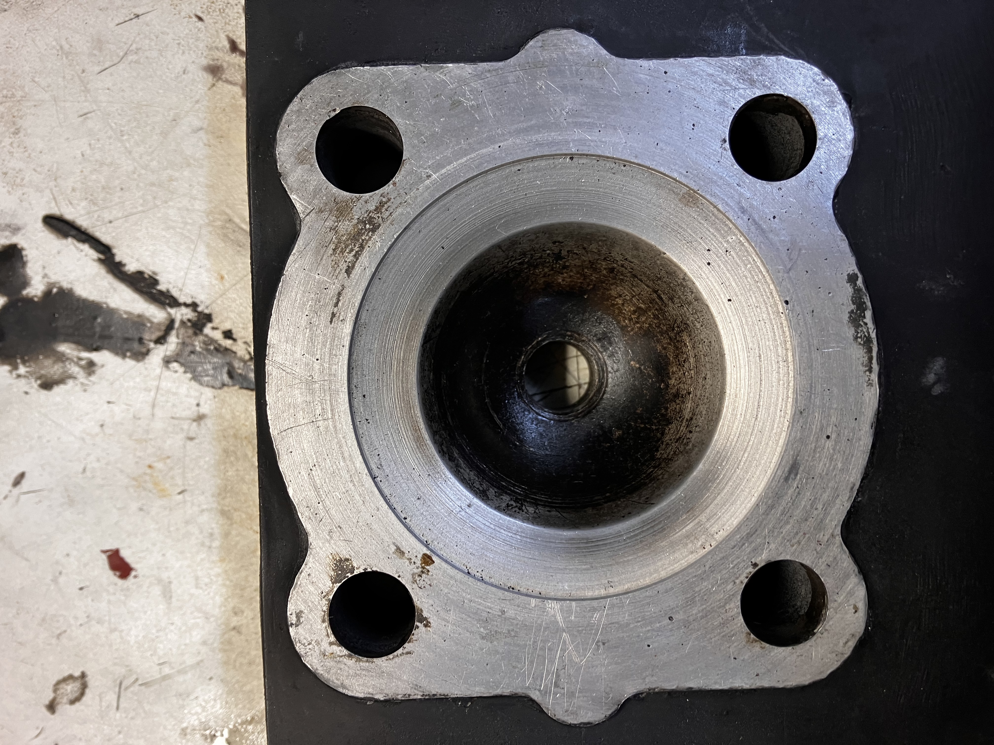

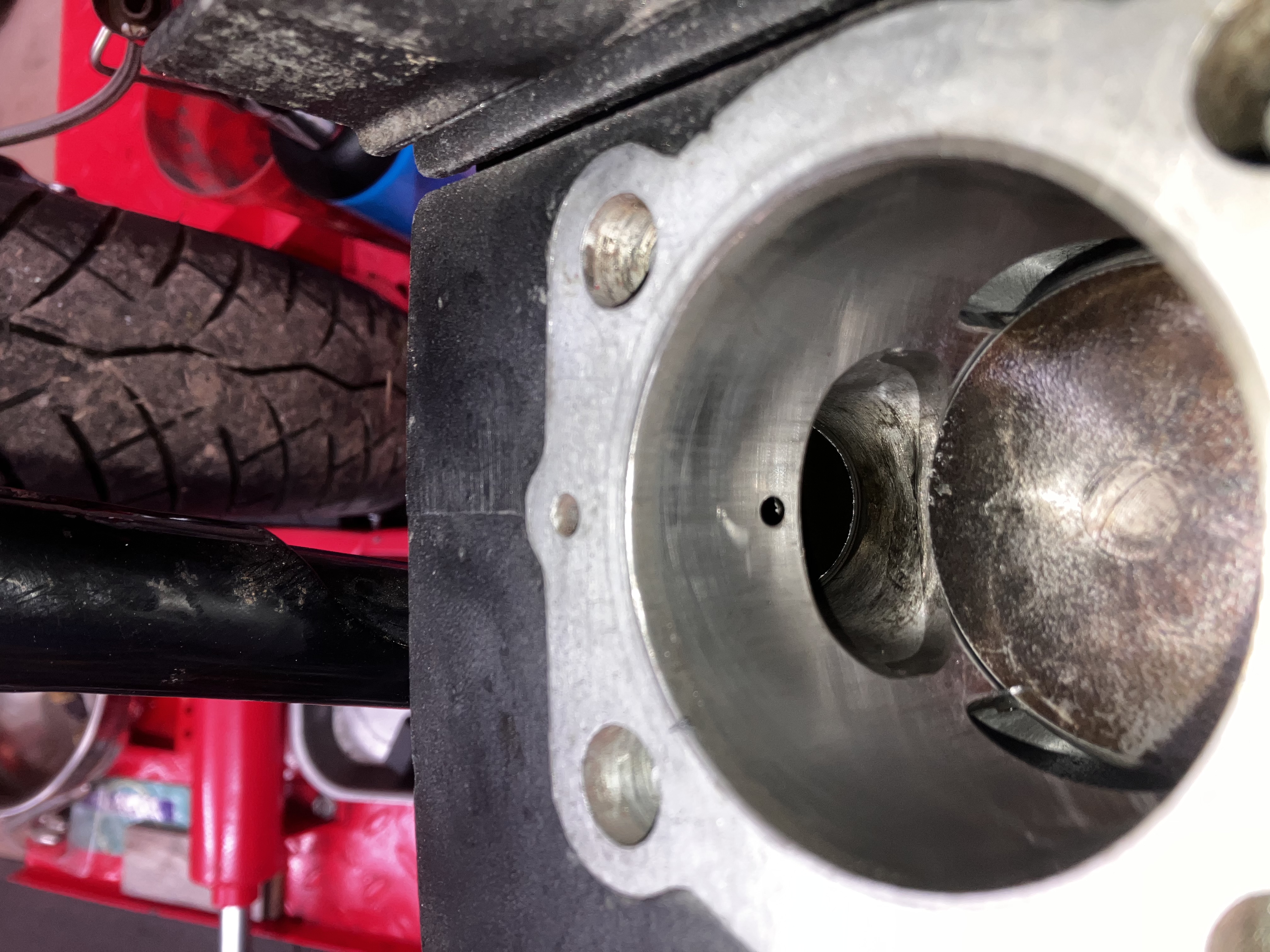

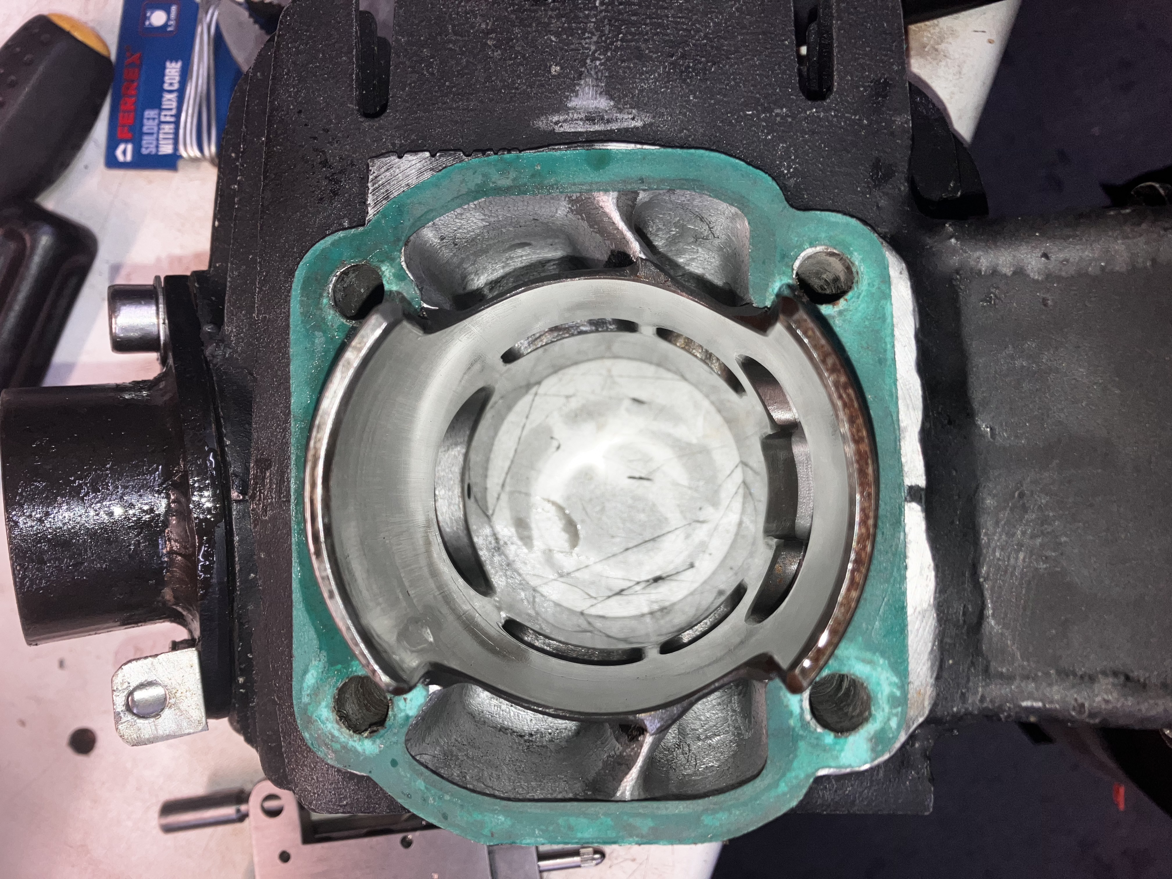

So where my previous plan was to get some dyno time and then race, I have now gone 1 big step back and stripped the top end off to get a baseline.

looks like a serious motor, love the pre exhaust port drilling, we used to do that to the 200 race bikes :thumbup: .. looking at the list its strange to see the plugs? 5es? you would think it would be running at least 8S?
Posts: 16732
Re: The RD400 drag bike
Yes the tunner said the should be 9s for the race but 8s to warm
It up
AMCQ46 wrote: Mon Feb 13, 2023 7:19 pm Yes the tunner said the should be 9s for the race but 8s to warm
It up
that solves that :thumbup: :thumbup:
