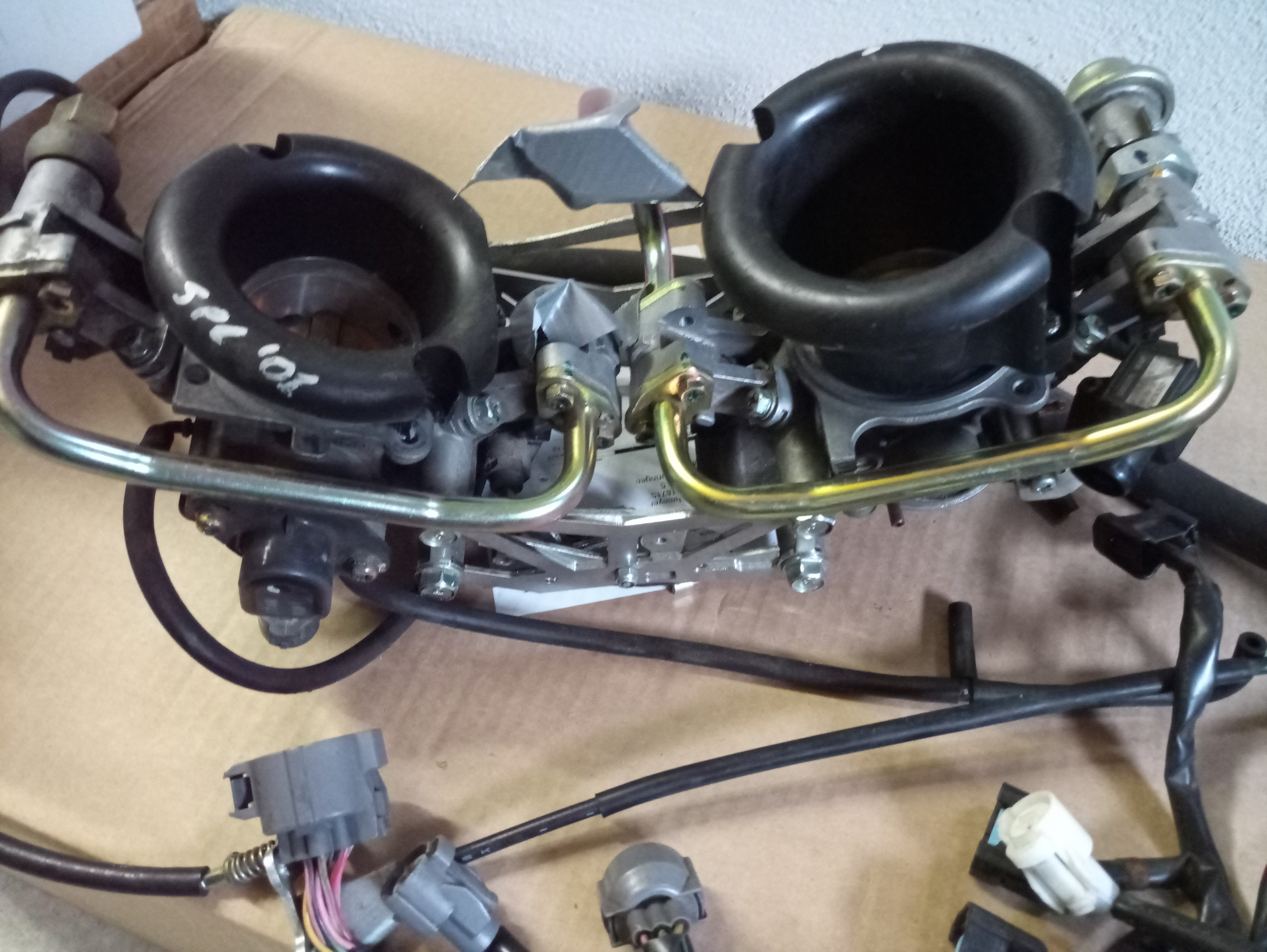

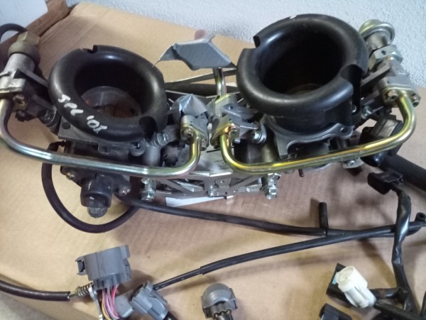

My set up was the RC51 throttles........fitted with side plates matching for the VTR F.
The plan was to use the fuel pump from the VFR 800. AS a result the injection data table from the RC 51 can be used for the base.........
The Honda VFR and RC5 fuel pumps deliver the same pressure.
