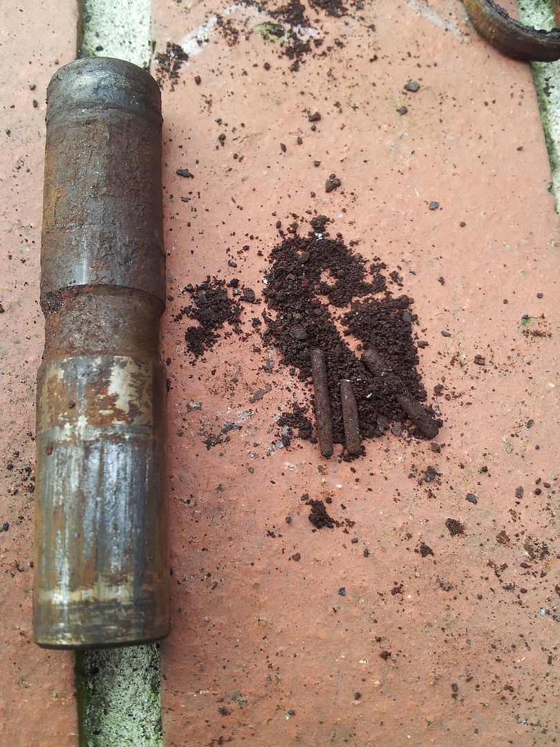

Posts: 22377
Re: Suspension linkage seized
artee wrote:Bolt is now free.
used a small butane torch on the swingarm where the allen key sided bolt goes through, then drifted the bolt from the other side.
Now I'm waiting for parts.
Roger

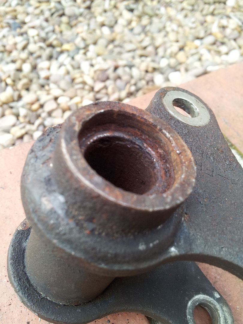

Post by artee »
Bit of a mess aren't they
Anyhoo...
Replacement sourced and fitted with new bearings, seals and a grease nipple.
Roger
