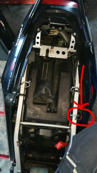

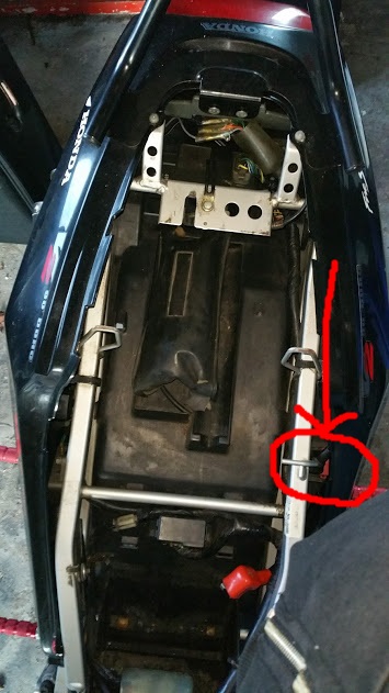

I am facing the same problem now.
Disconnected my old battery very long ago. Tried to connect a battery from another bike, did not not realised it was wrongly connected. Did not smell anything fried. But the battery still work well on the other one
Now wondering what could be issue?
Re: No power to guages or lights when I turn the key
caen712 wrote: Fri Jan 27, 2023 3:17 am I am facing the same problem now.
1st thing to check is teh 30amp main fuse. Its in the red block on the starter relay. Follow the red/+ posiitve cable from the battery to left side of the subframe. You'll need the seat plastics off to access. There should be a spare fuse under the relay in the rubber boot.
