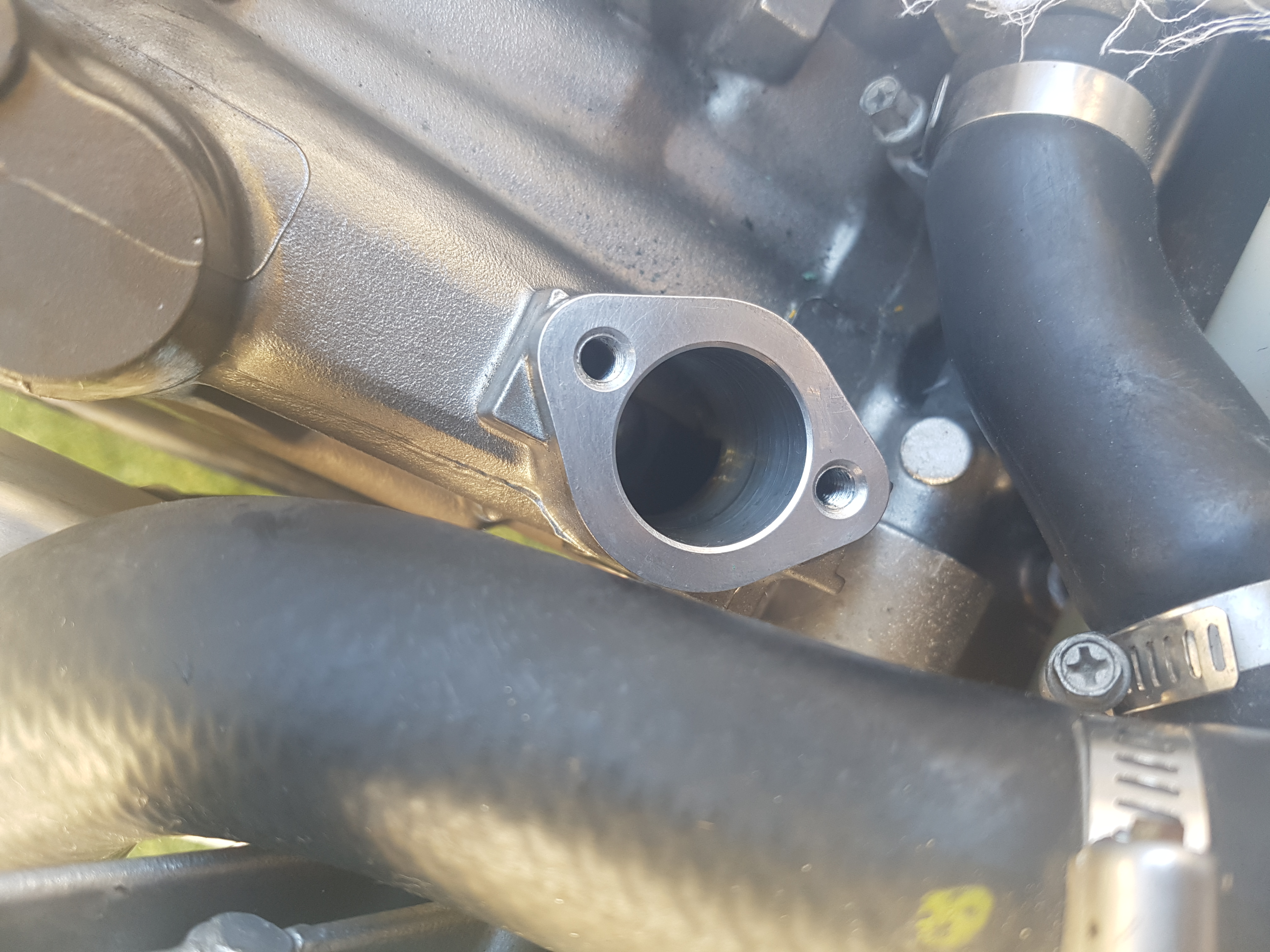

Rear CCT.
Rear CCT.

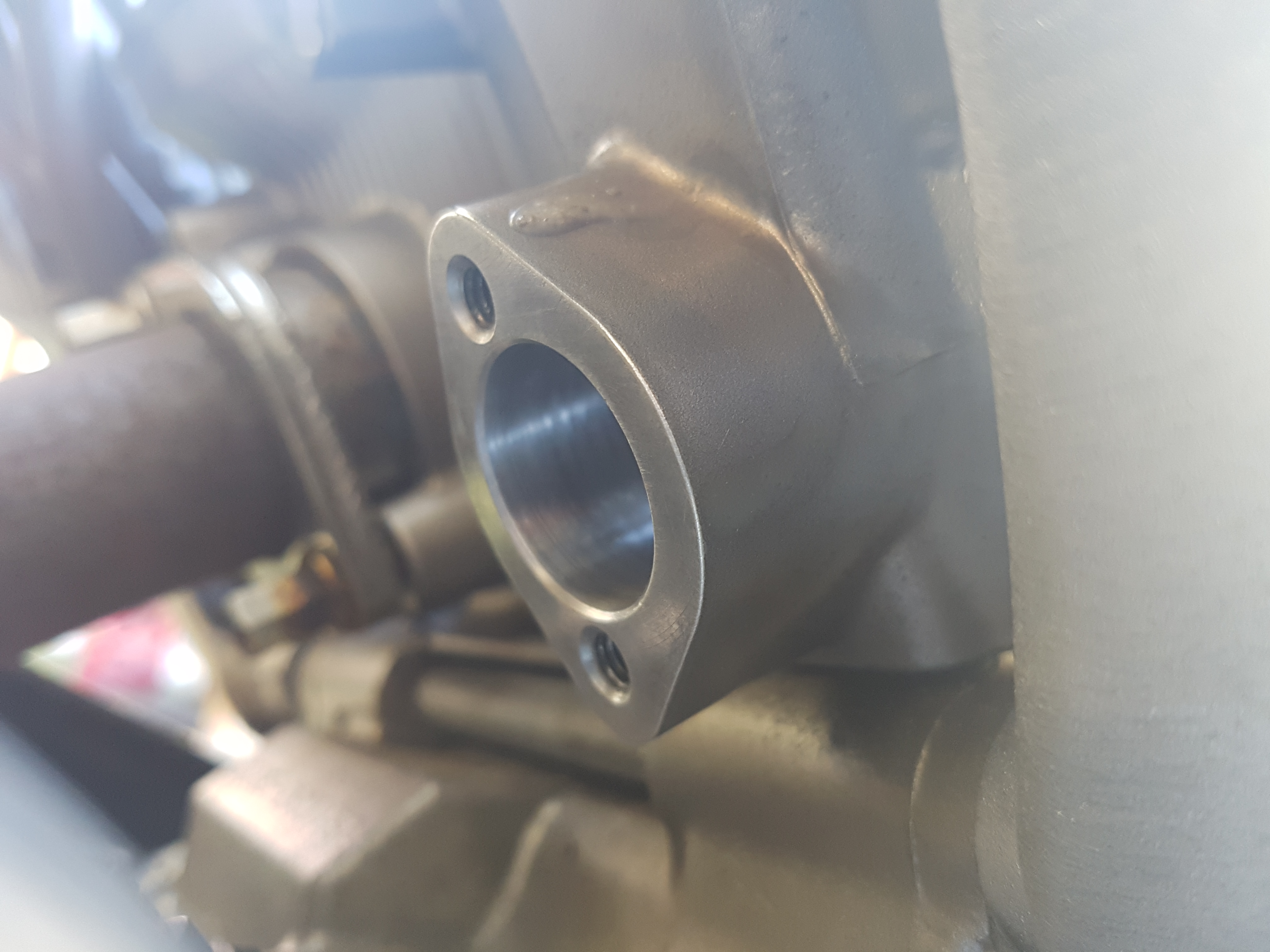

Front CCT.
Front CCT.

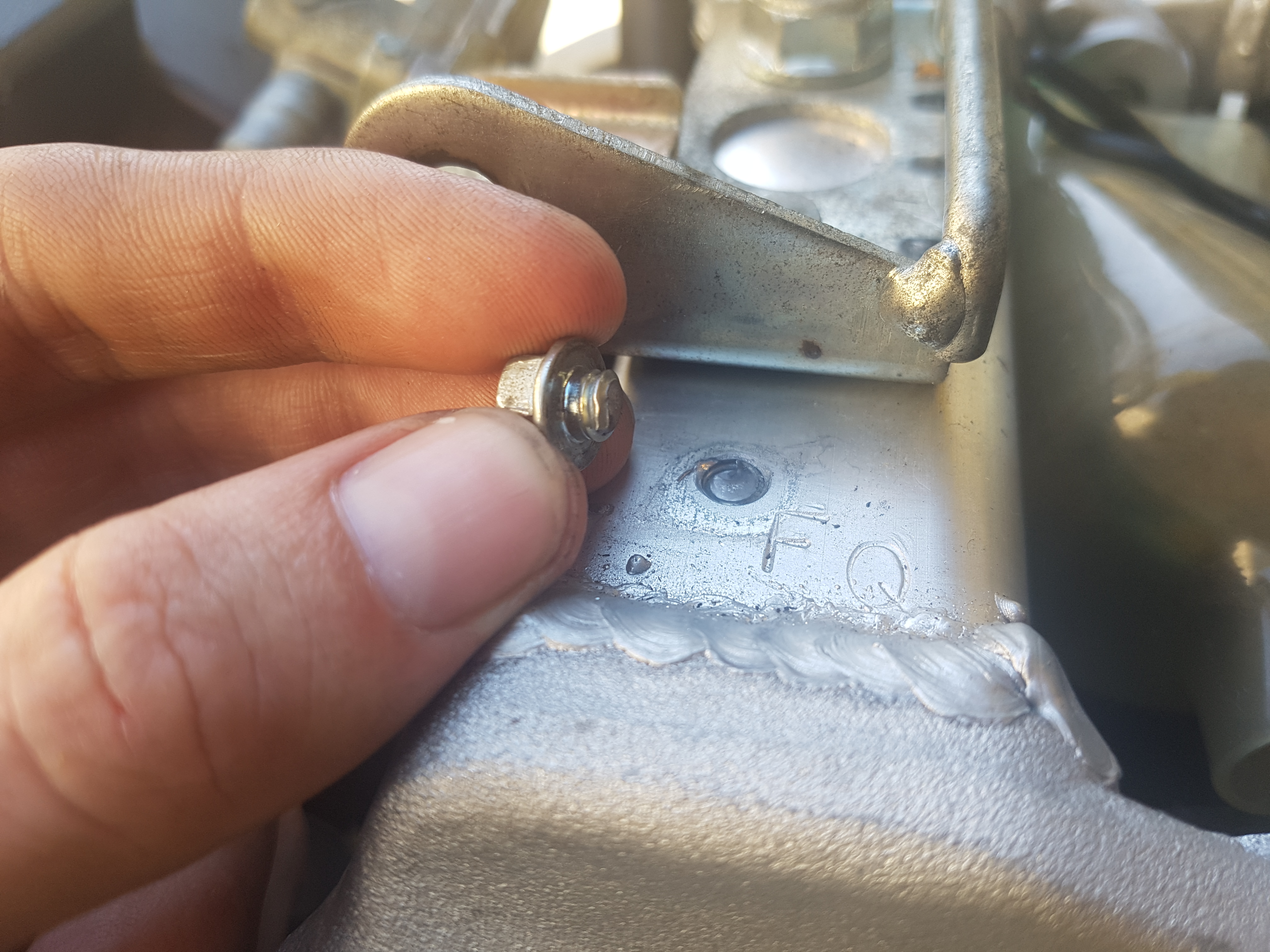

Shameful to say that this happened moments after refitting the cam covers... :oops:
Sheared bolt.
Sheared bolt.
Re: Mid MCCT Job - Rounded Head
Doh....Now that looks like the IIRC 8mm bolt, that holds the petcock diaphragm bracket onto the frame on later model VTR's. You should be able to use a centre punch or or large nail and a hammer to tap the old bit of thread out of the frame anticlockwise to remove it.

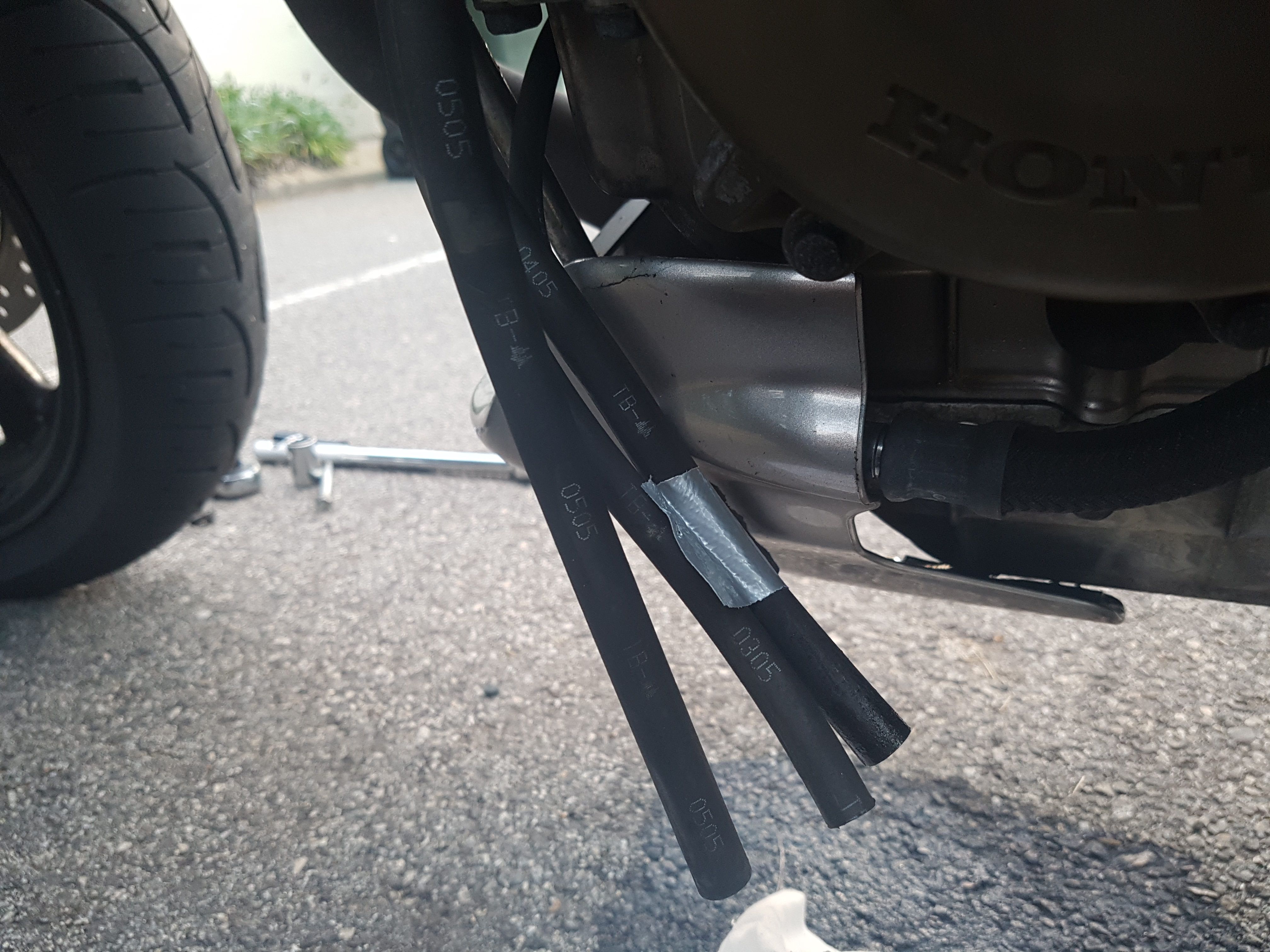

The bike is back together and started up fine, but I have a fuel leak :/. Petcock is dry and no leaks around it or the fuel line, but am getting a good bit of fuel coming out of the bottom of the bike. Any ideas where I have gone wrong? :?:
Is it coming from the tank overflow hose which exits nr the belly pan?
Is it a small dribble or continuous?

Also no petrol around the carb rubbers, fuel just seems to be coming straight out of a hose at the bottom, but only when the bike is running.
Marked with tape.

Contunous, when bike is running, stops when bike is not running. Fair amount of fluid coming out too, not just drips.
Track the hose back to its source under the tank to see if it's the breather or tank overflow hose
Wicky wrote:Track the hose back to its source under the tank to see if it's the breather or tank overflow hose
The fat one of the two is the overflow. The smaller one with the white conector at the tank end is the breather.
Has the bike been standing a long time ? it could be the floats in the carbs are stuck. When the engine runs the vac on the pet rock opens it to let fule flow to the carbs, if the floats are stuck the carbs will overfill.
As said trace the hoses back find out which one the fule is coming out of is attached to...
