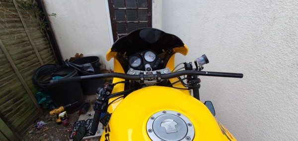

It has begun! (I'm working from home so this is a slow process right now..)
Just need to fit the controls and longer brake lines, and see what else needs tweaking.

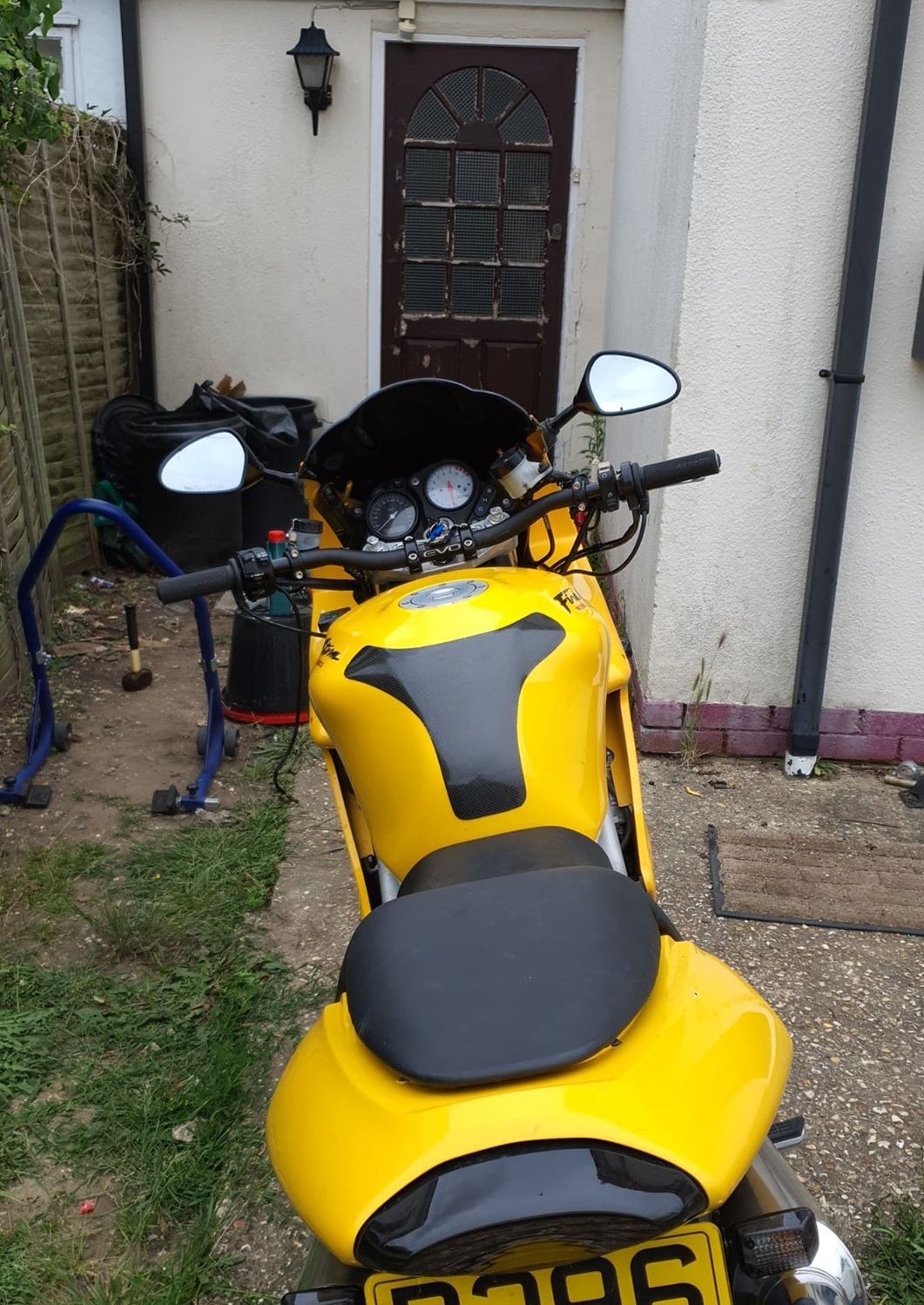

Post by Rhughes945 »
And here we are, all finished.
Bleeding the brakes was a pain in the butt, til I bled the MC then all good.
Just need to extend the wiring for the horn and that'll be it.
Have sat on it in the driveway and it feels good being higher up, spin to the office later this afternoon to see how it goes
Re: Rob's Build Log
looks like a good job there and a hammer and a bin in the photos, so you have all the tools needed.
what I found when I did the flat bars on mine was that it helped to pull the forks up through the yokes a bit more to make up for the reduction of body weight over the front wheel. about 5mm should make a difference
Re: Rob's Build Log
oh and you might find that you need to move the mirrors out wider
1) because you will hit the top of your gloves on the mirrors on full lock
2) because all you will see is elbow
