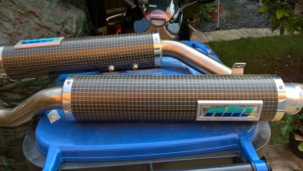

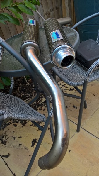

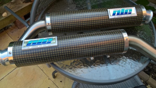

More high level MIG talk from me.
I've just managed to scoop an excellent condition set due to my eBay trawling. As many will know these are no longer made and the company is defunct. I could do some fabricating myself, and/or make a cardboard template and get hangars made, but I want to mount them from the frame and not the pillion hangar.
Any parts hoarders able to help out here? :wink: (Pics for reference) Mandatory bin shot included :D

Nice catch! 😃👍

You can fab a mounting bracket easily enough, using the rear footrest mounting points.
Mig cans have threaded mounting holes, but once the internal mild steel plate with nuts welded on it rots away you'll have to make a new set from stainless with rivnuts. You have to disassemble the whole can to get them in place, but it's not a big job.
Because they're only 100mm diameter, and thicker than normal carbon, nothing else fits.
But they're worth keeping going, because you can't get new ones, and they're becoming very collectable.
I still have a ratty shortened pair of sleeves from my first set, but the mounting holes are oval.
But a slightly shortened set, to avoid the wheelbarrow effect, assembled with a nice new perforated stainless inner tube with no baffle material are a thing of joy, aurally.

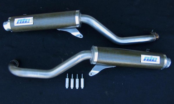

Thanks very much for that. I have spent more time looking on Google images and it seems (as you'd likely agree) that there's a few different methods used, from pillion hangar mount to a bespoke bracket attached to the rear end somewhere.
I have found this pic which is obviously from the pillion hangar and includes the spacers.
Don't trouble yourself with more pics. I might devise something or I might even stay with the Remuses.

On mine I removed the rear hangers and used the longer bolt with the spacers. Now if you don't have the spacers, and I don't even know where my 3 are, you can either cut another tube, or just double nut out the bolt to the required gap.
