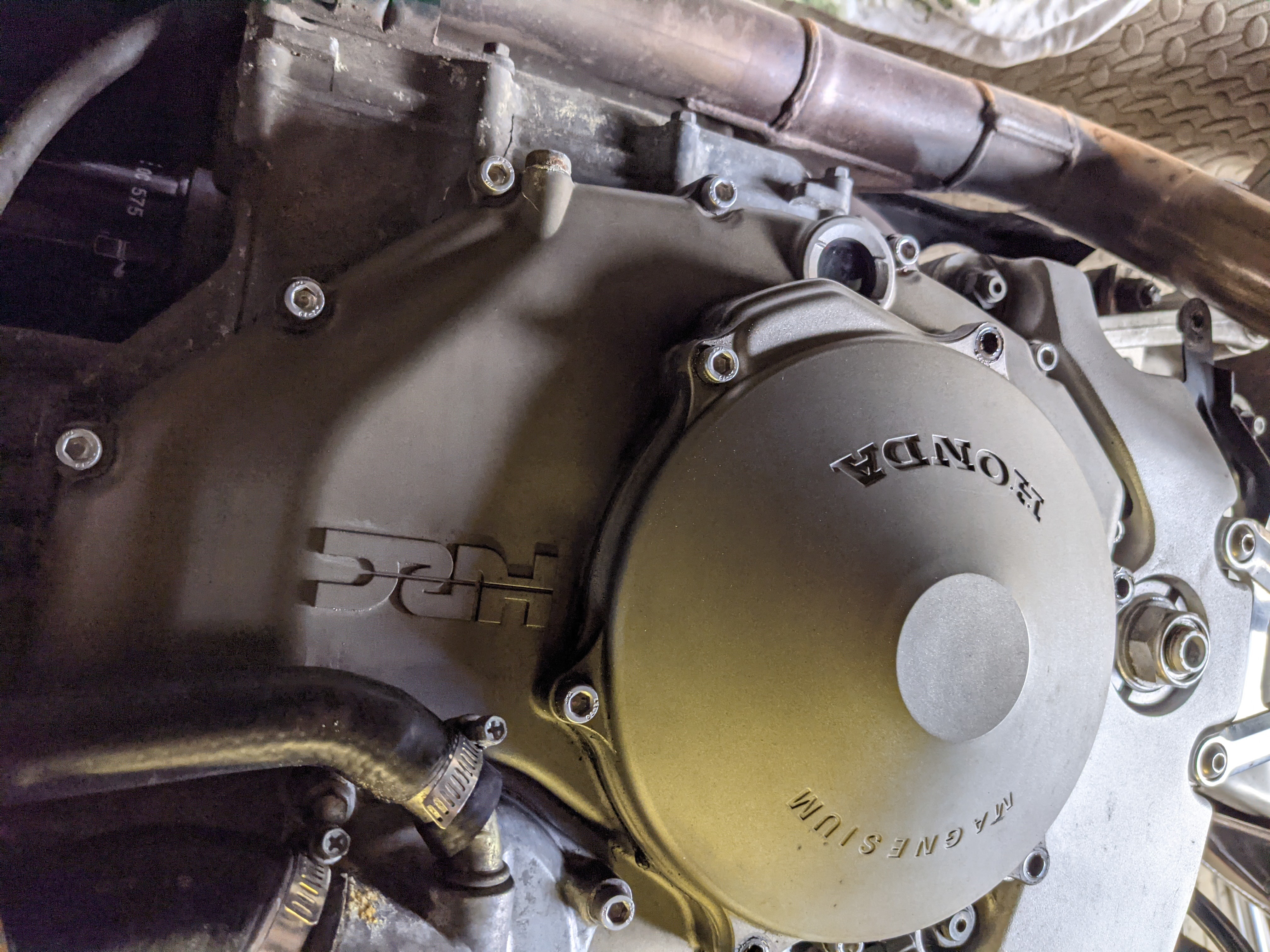

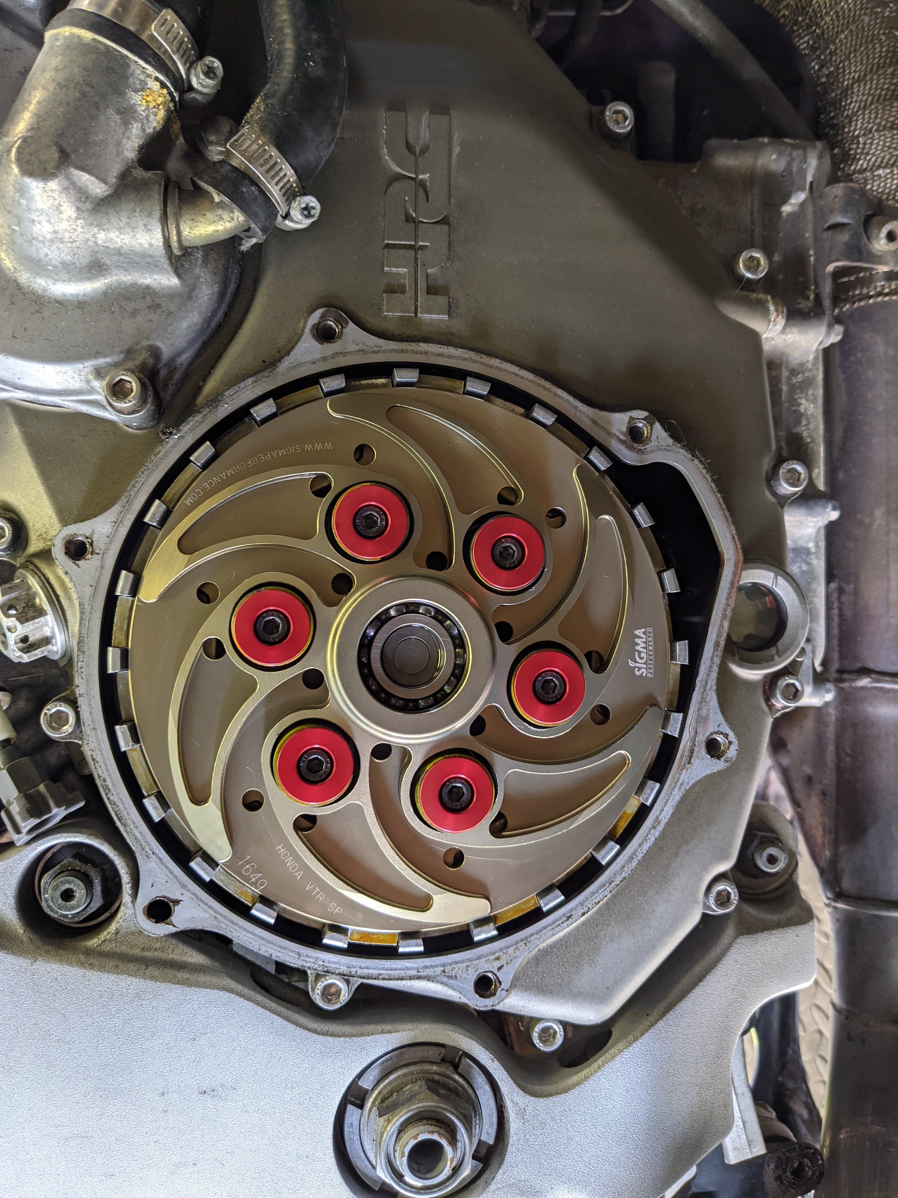

Re: VTR track bike conversion
This is what I meant. The SP2 clutch cover is split into two pieces, so in order to access the clutch you only have to pull off the circular cover, instead of the whole clutch cover and water pump.
So if you cut the base from an old Storm one and welded on the SP outer section you could access the clutch more easily- plus you could fit the larger SP clutch.
And no, the oil level isn't low, it's on the sidestand so you don't need to drain the oil, or risk drips of coolant dripping into the sump as you remove it or reassemble.

tony.mon wrote:This is what I meant. The SP2 clutch cover is split into two pieces, so in order to access the clutch you only have to pull off the circular cover, instead of the whole clutch cover and water pump.
I understand, thank you. I seem to remember the Stage 3 bike having a separate bolted on clutch cover, probably for easy access for the reason you mentioned.
