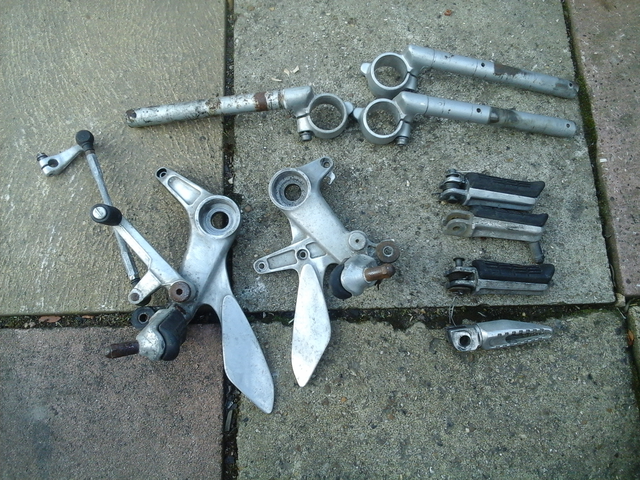

Re: VTR track bike conversion
So I pulled me finger out & 5 Storms & got to the spares cache...
Dug these out...
L/H front hanger compleat.
R/H front hanger no brake pedal.
1 pair of std clipon's.
1 single right hand clipon.
3x std foot pegs & an odd after market one.
I think the foot pegs are all r/h one's I dont think they can be swapped over .
Incoming PM...
gilson
Post by gilson »
MacV2 wrote:So I pulled me finger out & 5 Storms & got to the spares cache...
Dug these out...
Incoming PM...
Thanks Mac.
No bike (yet).
