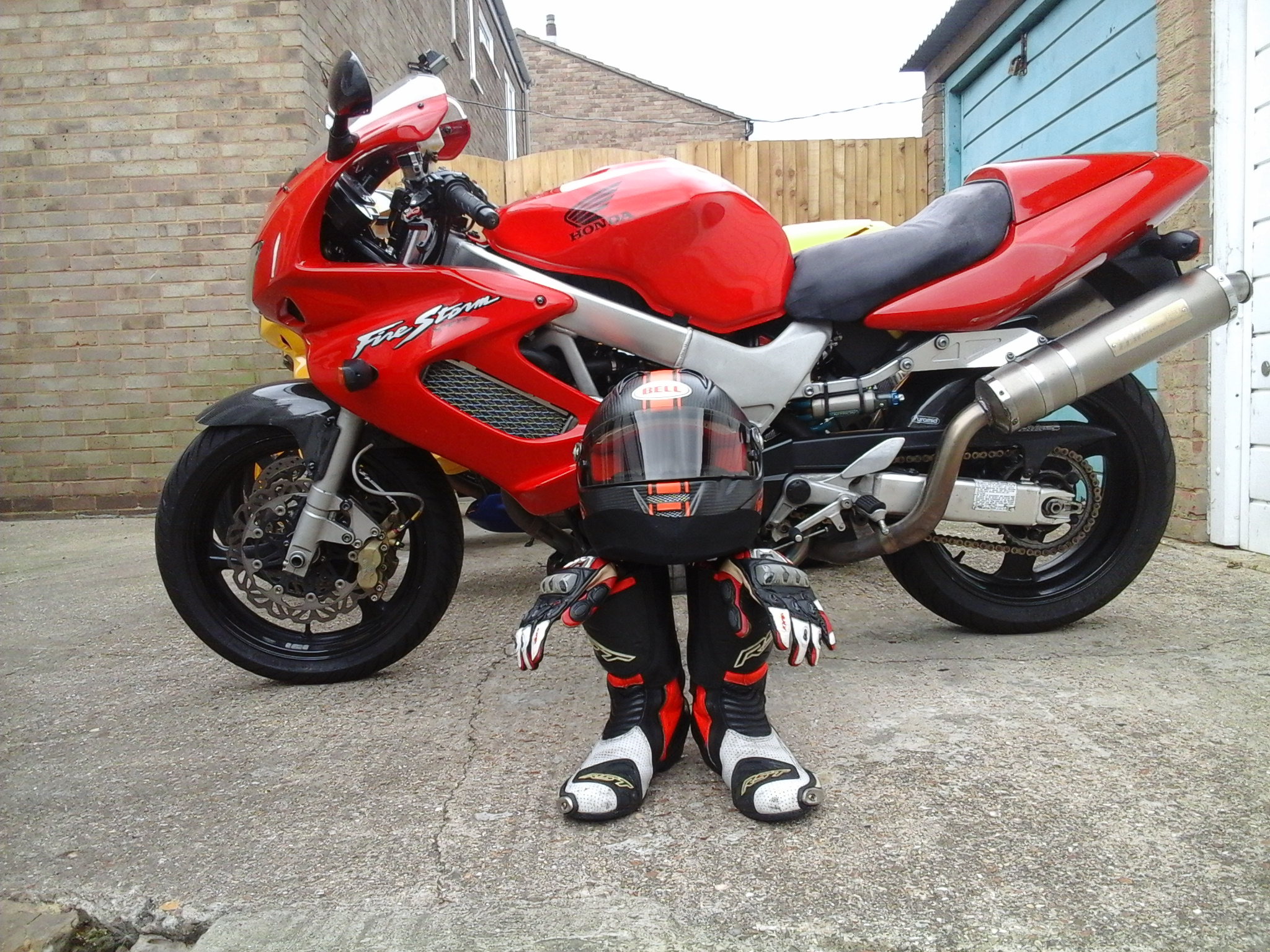

That surely is one of the better (best?) examples of how good these bikes can look. Kudos to you!
Hahaha...Well TBH thats as much as I bought it, just tidied it up a bit...
The story as I was told a P PO had the work done apprently by Harris Engineeing. Although I'm not 100% on that, it is a US import as far as I can tell...'98 bike with a PAIRS system on it... Maybe the major work was done in the US...It has a few Two Brothers bits & bobs on it...
He then had a minor spill & it passed to a mechanic. The body work is OEM but the paint is not 100% match to the factory colour R-157...The belly pan is deff a different shade.
The PO whom I bought it off traded in a bike he had for it at the time with just 4k on the clocks now has about 9k on it...
Needs MOT & tyres then I might get it out for a ride... :lol: :lol:
Still things to do... I need to do the TPS, it has security bolts not torx head bolts. Strip & clean the brakes, strip, check, greese the linkage...& sack the PAIRS System...
