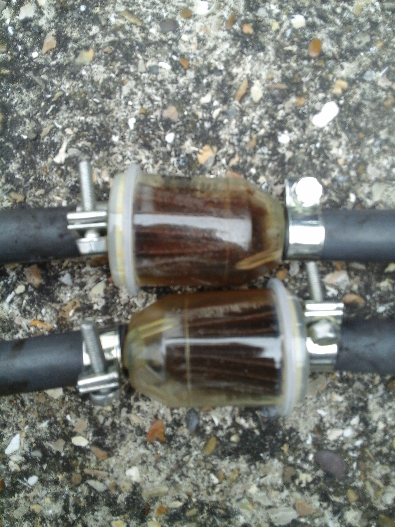

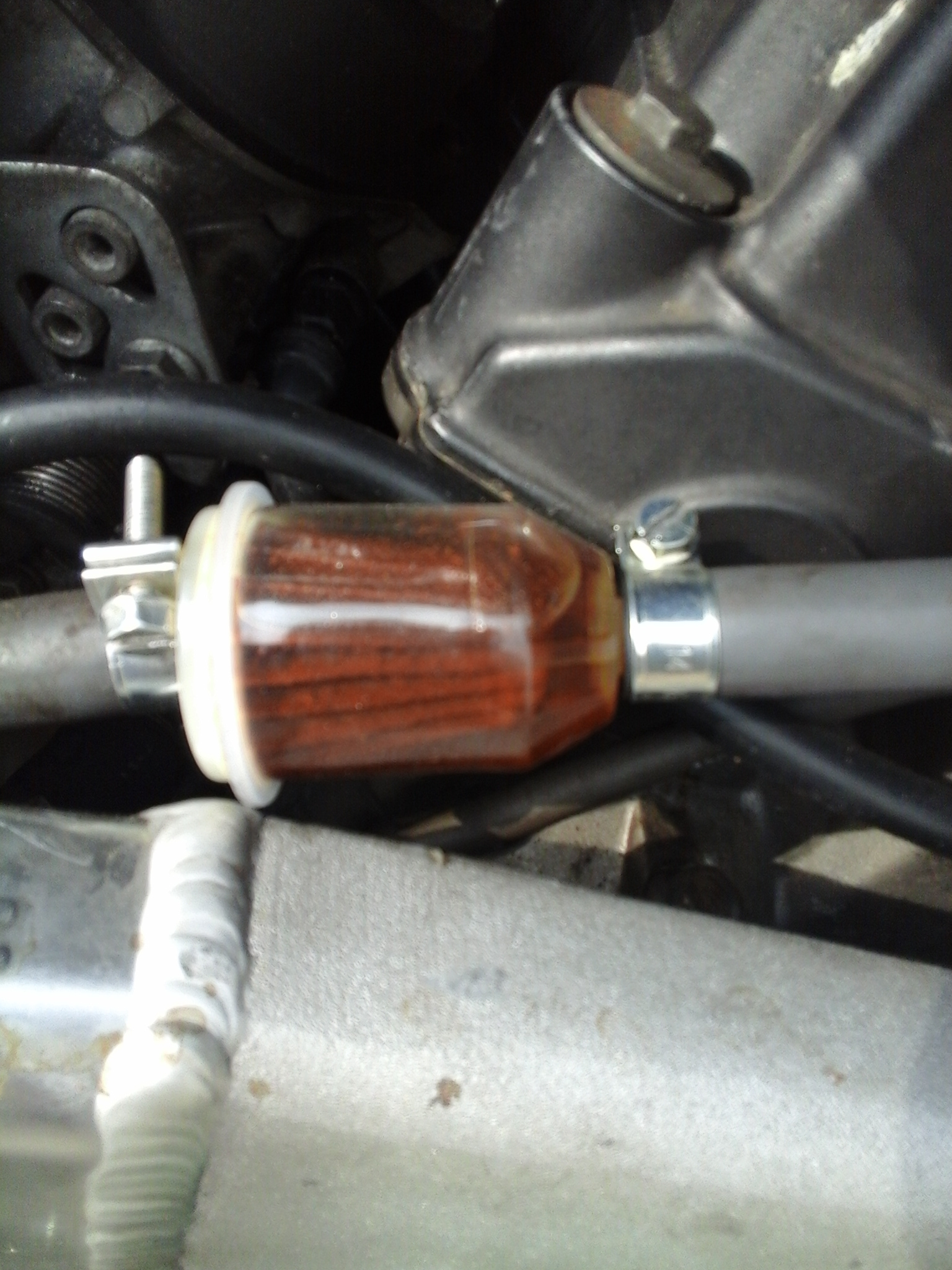

So that turned out a bit easier than expected.
As I was thinking electrical the first port of call was to check /swap the plugs.
So lifts up tank...
8O 8O
Seems the rust treatment I did on the tank wasnt that good after all... Bloody good job I put the inline filters in...
So I did what I should have done in the first place & swaped the tank from Dresden over. Had to faff about sorting some replacement fule lines out. Boxed it all back up bunged some fule in... Fired up & ticks over nicely... Started raining of course so I will take it for a spin/test tommorow...
Might have been easier just to pop out & get some new fillters but thats them feked after just about 800 miles...
Oh & the brand new £40 OEM in tank fillter is also already too swollen to pull it out...
Still look on the bright side... see next post... :wink:

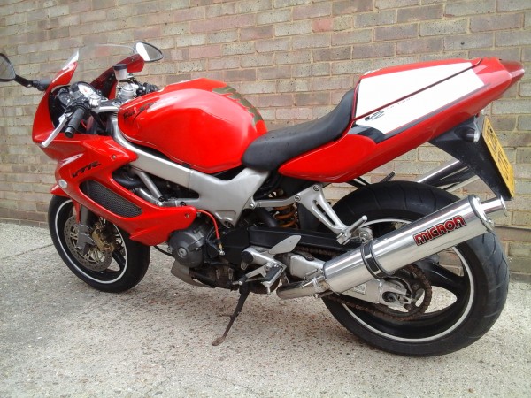

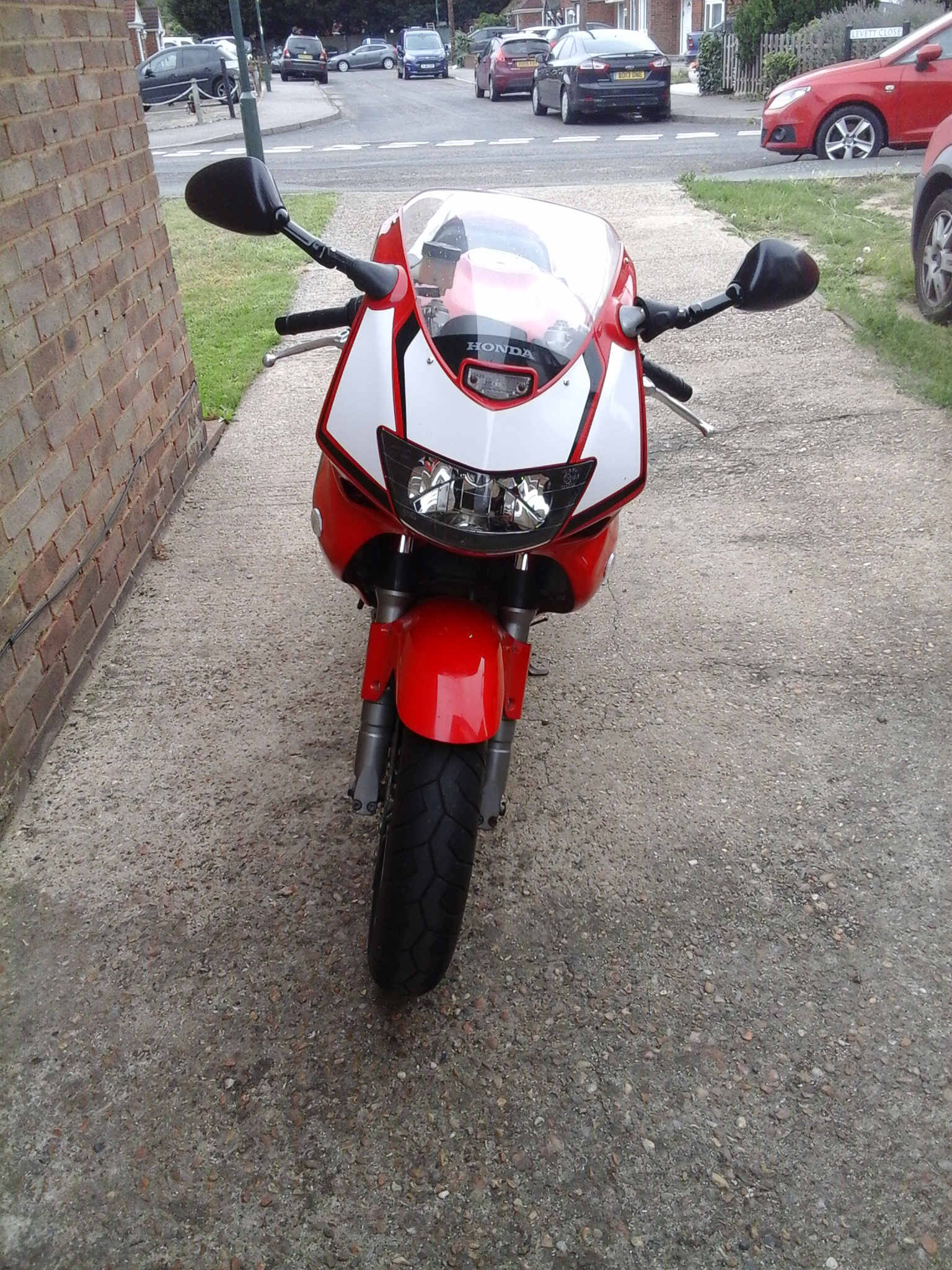

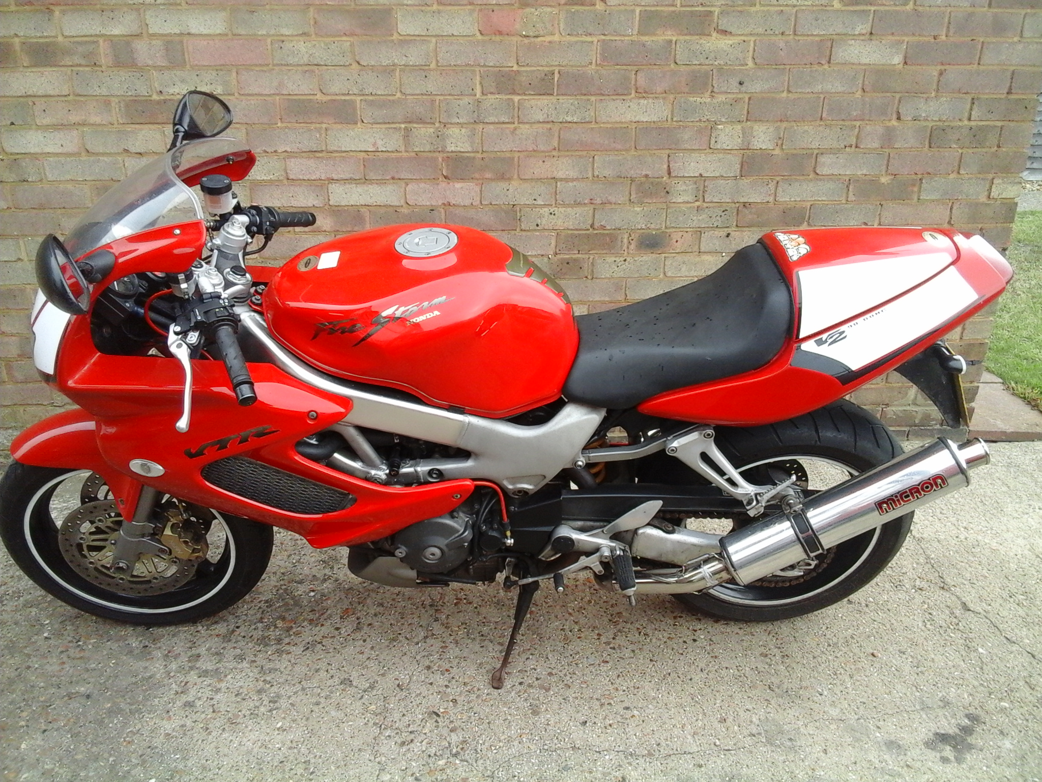

Yep another Storm for the collection...
Our freind Murv decided he wasn't using this enough & was gonna E-bay it I made an offer & he accepted it.
Rode it over today.
Nice cans, needs a few bits doing some rusty bolts, rear tyre is a bit low...Rim stripes may have to go. Not sure about the mirror extenders... I'll give a going over as soon as I get time wait till Sept 1st & tax & insure it...Maybe... :lol: :lol:

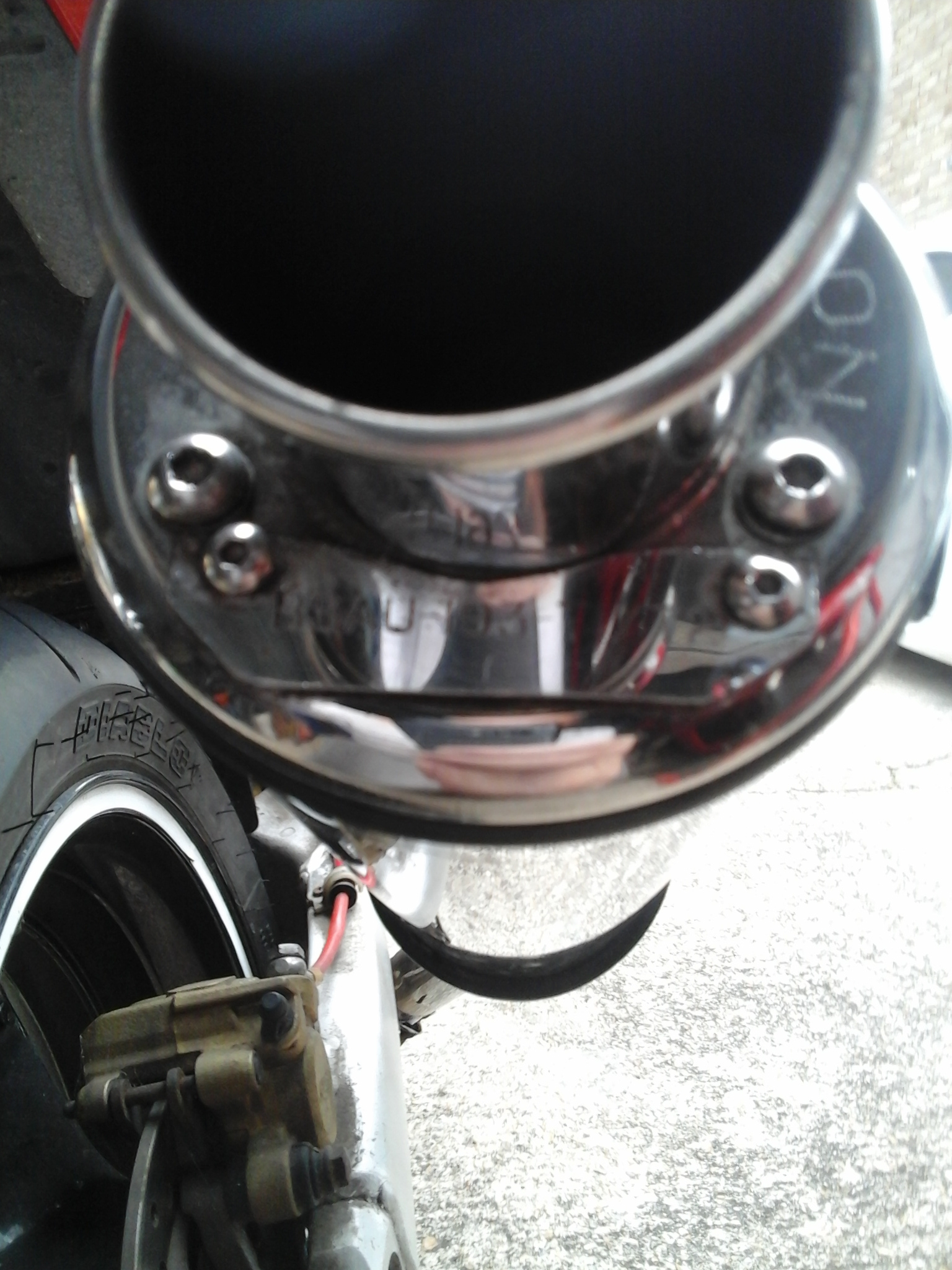

Meanwhile on No.15...

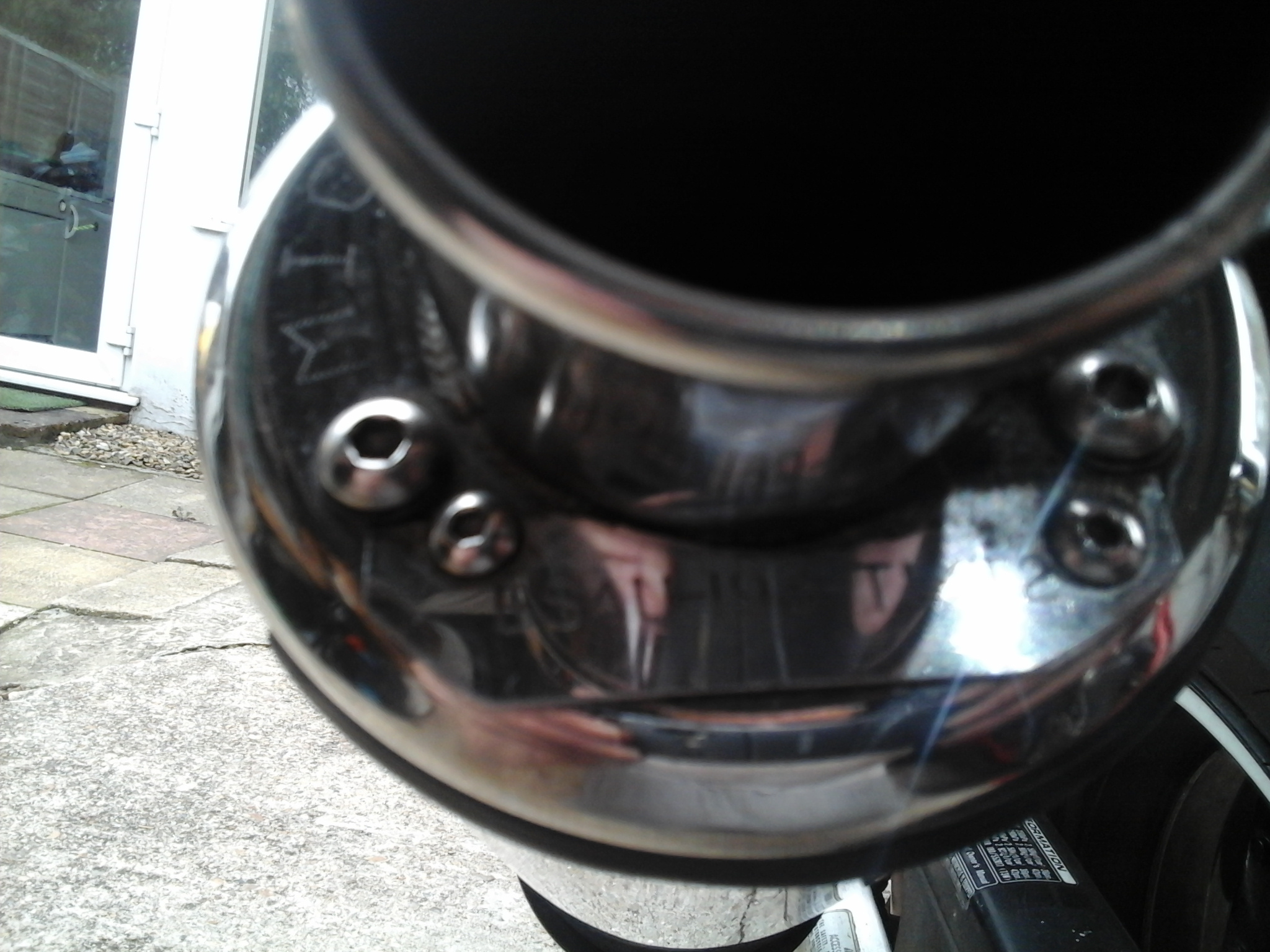

Think these are legit :lol: :lol:
Snide BS engraved plates over the not for road use markings...Probably...
