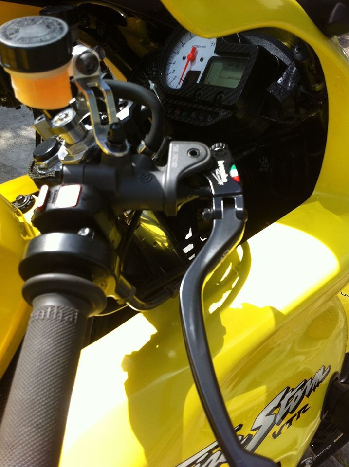

starting to get the hump with my front brakes.
after fitting a lovely radial master and bleeding the buggers, 5 bleed nipple in total... :roll:
last night I cable tied the brake lever. and this morning there's a big brake fluid stain on the floor and no fluid in the reservoir....ffs!!!
this happened before in spain. the banjo bolt on the lhs caliper needs to be ultra tight, which doesn't seem right to me.
anyways I re-bled the feckers today, i'll cable tie the lever again over night, fingers crossed.

You shouldn't really need to be pulling the lever in overnight and putting extra stress on the seals. That's why you have so many bleed nipples. The lever trick works with the standard setup because they are sh1t to begin with and don't have a master cylinder bleed nipple. Maybe some tassels will help. :lol:

Put some PTFE tape on the bleed nipple threads...Over tightening it wont help you'll just damage the threads therefore making it worse...

the bleed nipples are fine, it's the banjo bolt on the nearside caliper that's the issue. after devon i'll try a different bolt with even more new washers.

have you put new washers there?
