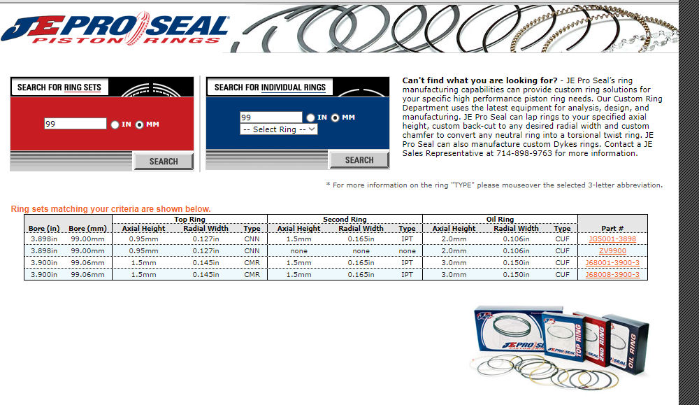

mik_str wrote: Sat Feb 03, 2018 12:02 am 99mm? what rings will you be using? the largest OEm rings are 98.5mm...
Why would he not use JE rings they sell for their pistons?
Why would he use OEM rings with a JE piston?
Every JE piston I have bought (3 this year so far, but none for a VTR, so maybe Im just missing something here????) comes with a set of rings.... Im confused by the question I guess.

I am still waiting to hear back from JE, but im assuming that they will provide the proper rings, if not I think that 98.5mm rings would likley be sufficient?? Or would tge end gaps be too large?
I talked to them on the phone last week, they did mention that those rings may not be available in that size.
Worst case I guess they can be made...

in the case of the VTR, JE has you use Honda rings. Here you go, from their Web site (http://www.jepistons.com/Catalogs/Power ... _1000.aspx)
Ring # - OEM (not included)
Obvious they offer custom rings too...

Yes, got it, on a VTR 98mm piston offering, you use stock OEM rings... But on a 99mm piston, Id bet they provide rings, as 98.5mm rings in a 99mm bore are going to have a large end gap
Marquez Motorcycle Services
Post event services
Total Rider
And advanced Rider training
Re: Engine rebuild - cylinder re-sleeve
I hope you're right, it won't have a good cylinder wall seal otherwise.
Might be worth contacting JE to ask what other engines use their 99mm pistons, and whether those rings are available.

It's not just about the size but also the material of the rings. AFAIK rings for iron vs nikasil cylinders are not the same material

Im fairly sure they will have ring options available for any size piston. They could cut the ring lands to fit which ever ring set is suitable.
I could also go up to 100mm, and use sp rings. but as it was mentioned, they are likely designed for a nikasil bore
JE will contact me tomorrow..Ill let you guys know what happens.
