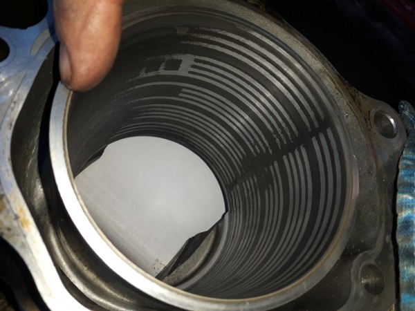

Im in the process of a rebuild of my Storm. After deciding to use & ordering JE high comp pistons, I realized my bore was not perfect.... I either needed a set of os high comp pistons made, or resleeve the bore and use the ones i have.
After going to 3 machine shops, I've finally found one capable of doing a resleeve job.
I havent found any info about resleeving a storm, so I thought id share the experience.
After sending the block to the machine shop they told me that these sleeves cannot be pressed out, they are actually cast-in sleeves. So far, Ive had them bored out and im waiting on custom ductile iron sleeves from advanced sleeve.
Heres a pic of the block after bore job. It shows the remaining ribs left in the cylinder; used to hold the sleeve in the casting. The new sleeve will be installed with a 0.003 interference fit and sized to the JE's.

There is no need to re sleeve if only going a single or two size overbore, the motor as is can easily handy it.
If the motor had a catastrophic failure that significantly damaged the bore there are still other options than re sleaving.
The OEM case/ cylinder can be bored and honed
It can be bore, plated, honed.
Or repaired though welding then bore and plating.
Why did you choose to have new cylinder sleeves installed?

E.Marquez wrote: Fri Dec 22, 2017 4:06 pm There is no need to re sleeve if only going a single or two size overbore, the motor as is can easily handy it.
I had ordered the JEs in standard size, assuming it would work out.. but the bore wasnt in good enough shape to uses them.
Its very expensive to have custom high comp pistons made..and I cant return the ones already purchased. So it made sense to me to do a resleeve.
I see now that it would have been smarter/cheaper to get it apart and measure the bore before getting pistons.. Its a lesson learned, re-sleeving will work out just as well.
The resleeve will cost $900 total...custom pistons are more because you have to buy 4.

Chris58 wrote: Fri Dec 22, 2017 5:53 pm I had ordered the JEs in standard size, assuming it would work out.. but the bore wasnt in good enough shape to uses them.
Ahh, got ya...
May never come up again, but having them Nikasil plating then honing to size takes care of most wear situations... though not damage which can be repaired though welding before plating.
But hey, re selaving is going to work as well so your getting it done.... Just another option for ya.
