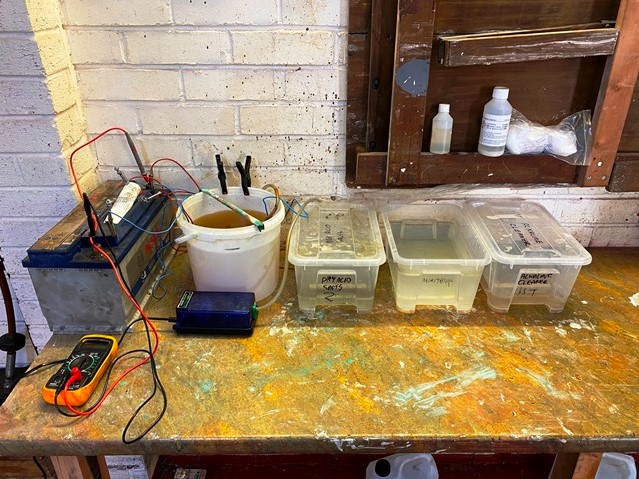

I’ve used the zinc plating kit on my GT250, FS1E and step sons TS50x and was very pleased with the results. I started using them for the reasons as you, lost parts/crappy finish from some players.

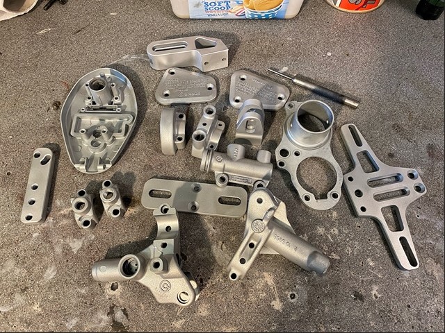

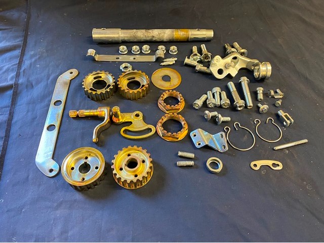

buzzer wrote: Fri Jul 31, 2020 10:17 am One of the things I have always struggled to get done is plating... I have had some terrible jobs done in the past, and lost critical small parts to the bottom of someone's plating vat!
so about 4 years ago I bought a plating kit to do zinc... Have to say it's VERY good and I have used it time and time again! its a bit time consuming, but time is something I have, particularly at the moment...
Here are the results for my latest build. the kit can do clear and yellow passivation, you can see the difference.

Nice work with the plating 8) :clap:

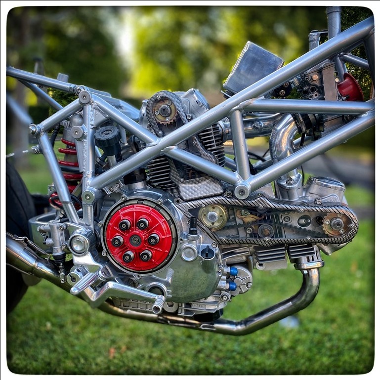

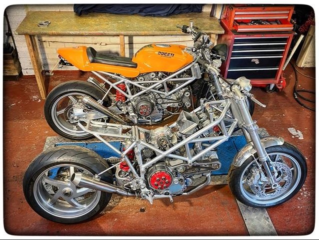

Now for the nice bit… putting it all back together! the frame came back from the powder coaters and as ever its a superb job! I know its a 50 mile round trip to this guy but his work is worth it, especially after the poor jobs I have had done in the past at local companies… Must be the easiest engine to put in a frame!

Re: Well you asked for another Ducati build
Nice for the engine to go in that easy 8)

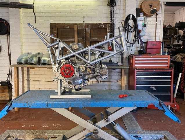

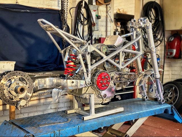

More progress... no holidays, and no pressure to go out means more garage time... its a good job I have this project or I would be climbing the walls by now!

Posts: 953
You do know an awful lot of people would happily holiday in your workshop!!!!!
Cracking project
I am only a nut twiddler and overtightener, but just love to see this stuff. Especially for the skill level and end results are too notch.

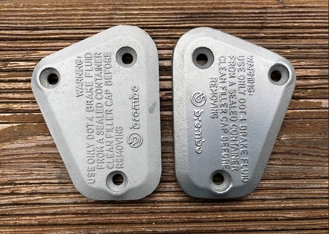

One of the benefits of having a blast cabinet is the ability to clean parts up easily... But I have always struggled to get that nice shiny finish the professionals manage to get with glass bead. I went to the bead supplier a while ago and said that I was having problems, and he asked what pressure I was blasting at, to which I replied 120 PSI. he said that's your problem... its too high and you are shattering the glass beads and the broken beads are giving you a matt finish! he said to turn the pressure right down, and then up until you got the finish you want! its so much better, you can see the difference in the reservoir caps! it also gives a closed finish that dirty finger prints just wipe off, on the matt surface they are difficult to remove!

That's handy to know :thumbup: who would have thought that,

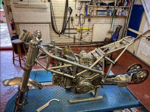

Back in its wheels now...

Looking very very good👍👍😁
Looking very tasty.I want one.
