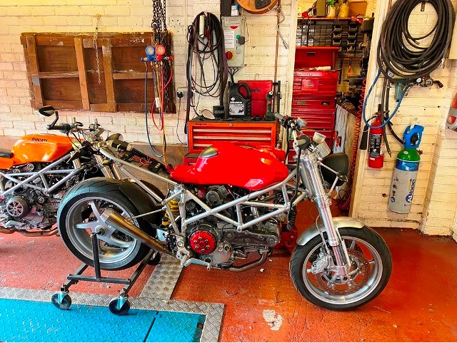

I bought this bike a few years ago... and over the winter 2018/19 I built it into this you see below... over the summer of 2019 I put quite a few miles on it... and actually loved the bike! it feels light and nimble, handles and brakes really well! I normally sell my bikes on, but this time I decided to keep it. A couple of things bugged me though... The tank I used was a compromise, it looks wrong to me, and although the carb conversion worked well... I felt the Monster 38mm Mikuni CV carbs held it back performance wise.

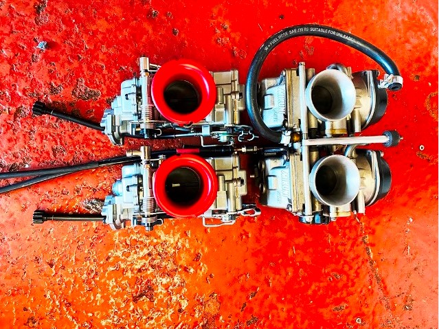

So its in for another rebuild/refresh... cosmetic only as I did the engine last time, and that is running well. I will be fitting some 41mm FCR carbs, a new tank (999) and making a new seat. And maybe change the exhaust...

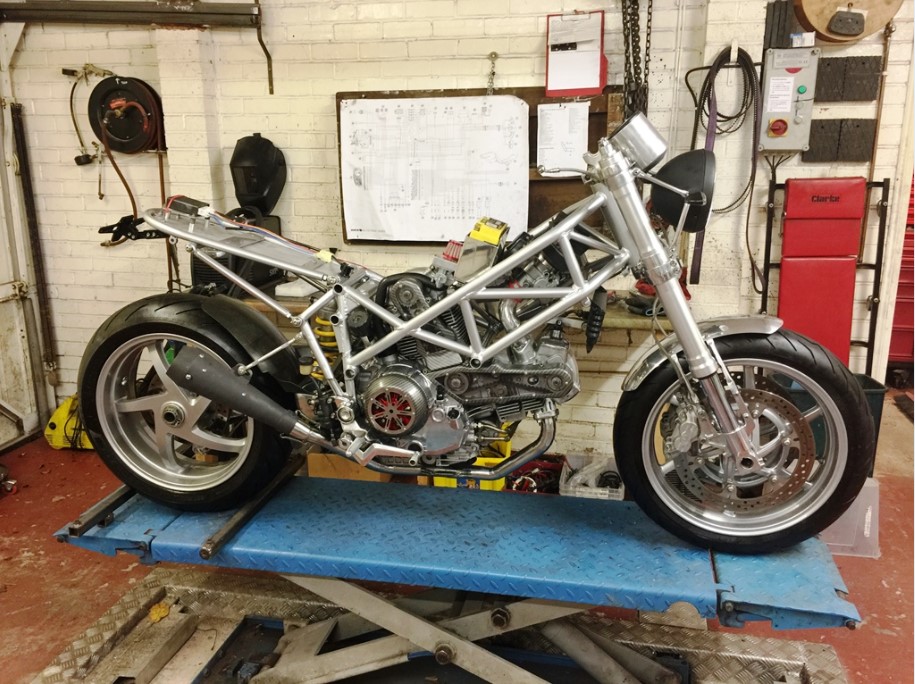

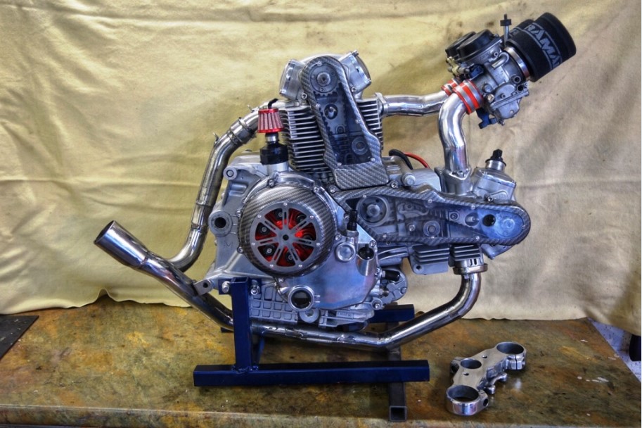

Here are a few pictures from the first rebuild...

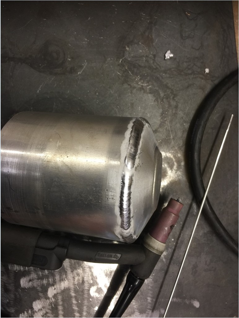

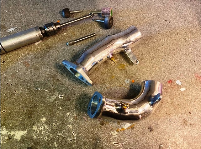

Been working on making the manifolds from scratch… it’s been quite difficult to get the shape and angles right, while maintaining approximately the same length.. there now though and I am pleased with the results. took a while to smooth the bore with the die grinder where I had penetrated with the TIG welds....

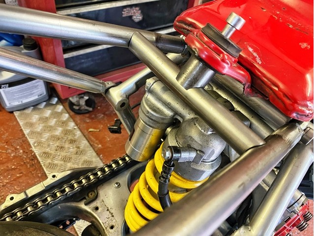

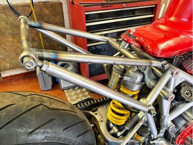

here is the subframe i have been making the last few days… I have deliberately kept it short as this will be a short single seat, which is the next job to do… I have used Rose Joints for no other reason than I just like the look of them!

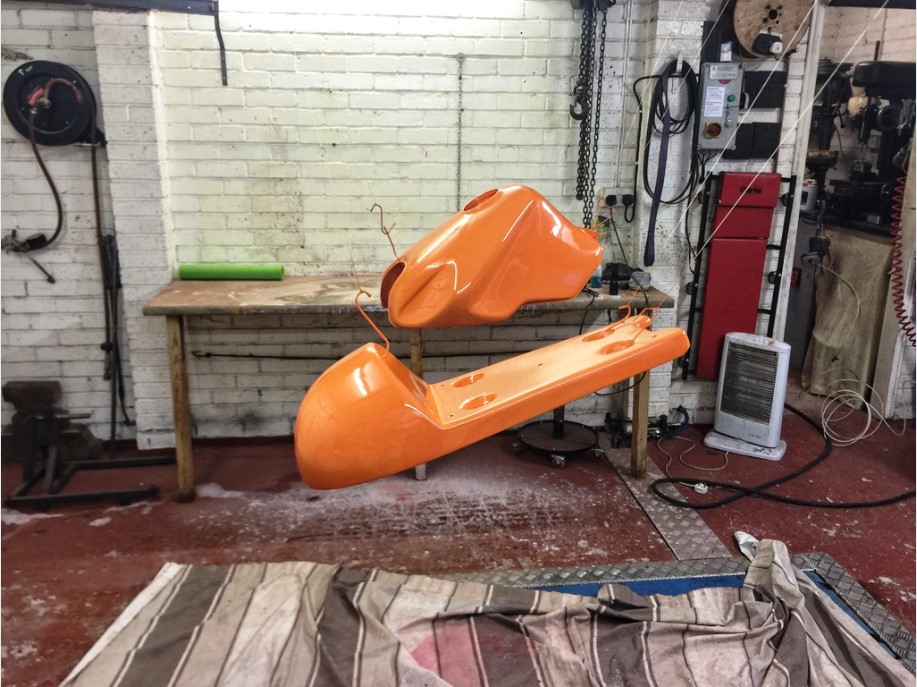

Having another read of this thread I can see how the red petrol tank will look better than the orange one with it being not so tall, although the orange tank looked okay to me until you posted a photo of the red tank on the bike :wink:
Posts: 953
Re: Well you asked for another Ducati build
sirch345 wrote: Sun Jun 28, 2020 5:31 pm Good work, well done 8)
Or will it be orange 🤪👍
