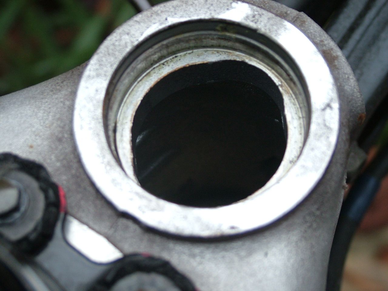

I was going to do this at the weekend but seeing as the weather is good and I had a couple of hours to spare I started on changing my head bearings and wheel bearings.
Front end of bike is stripped down and forks off.
Got all the remains out the headstock, easy peasy lemon squeezey.
Top one out.
Bottom one out.

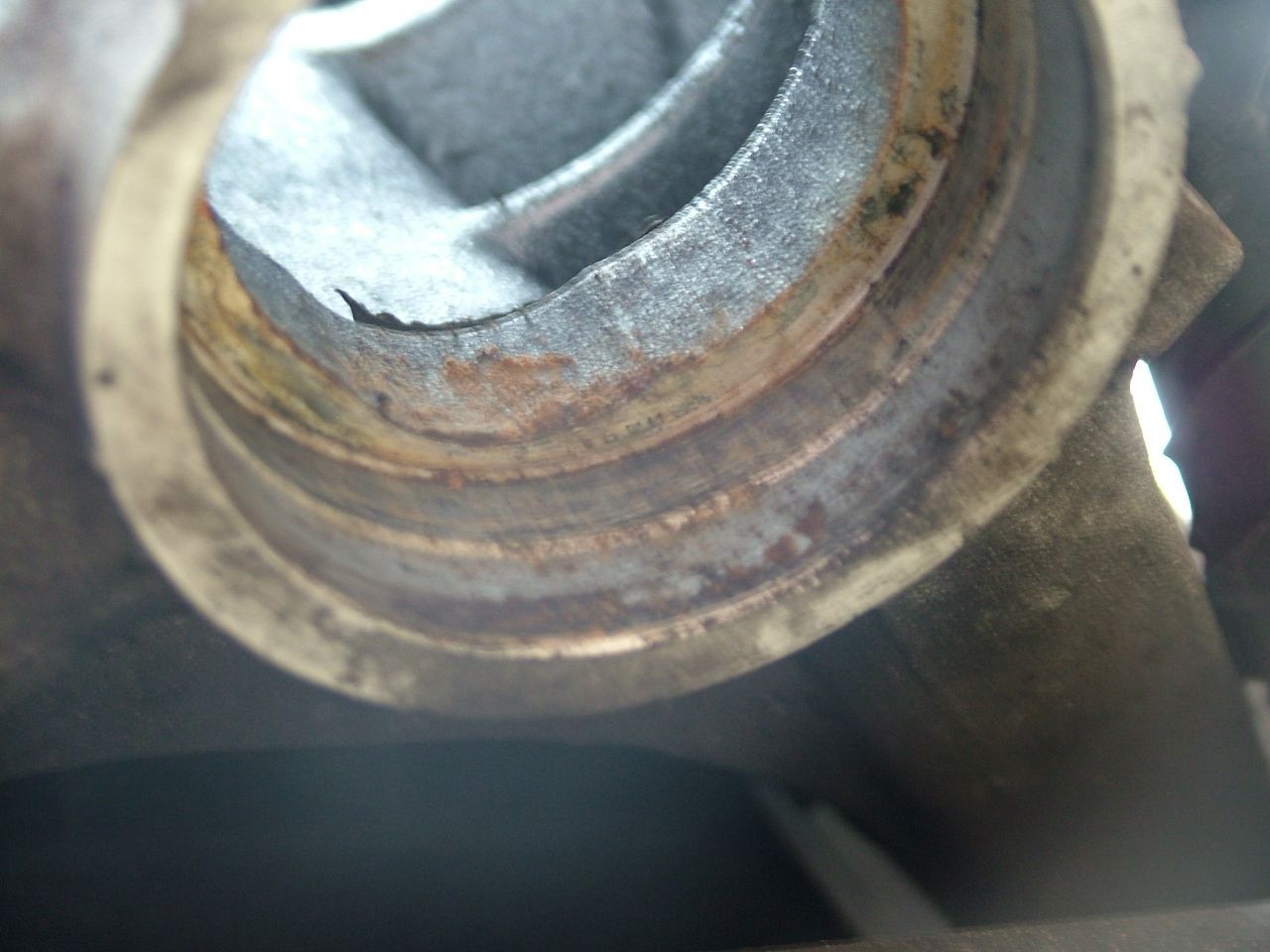

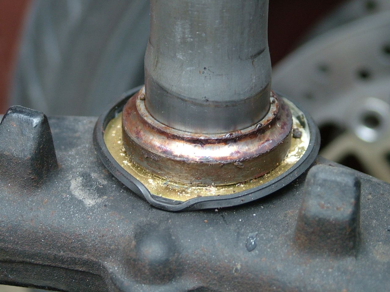

This is going to give me grief. :(
Old bearings where still intact to my surprise and not falling apart, but I wanted to change them for tapers anyway. Wheel bearings shouldn't be a problem and I have packed up for the day.

Carl,
good work so far :thumbup: on that bottom inner race you need to grind it through till it is almost cut through, then hit it with a hammer and chisel till it cracks
