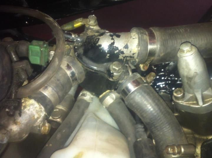

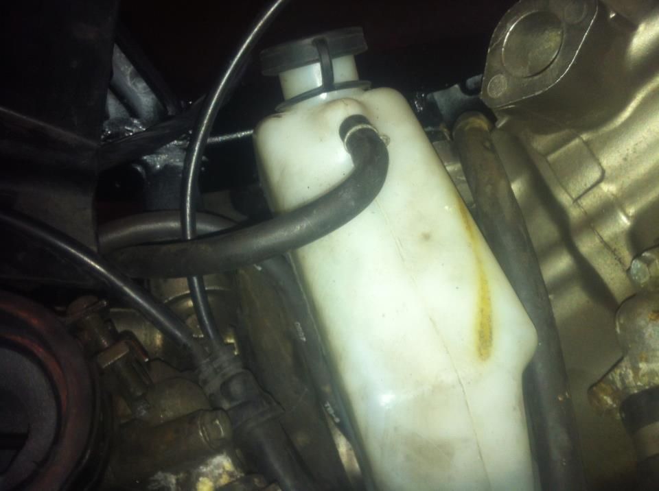

Here's a clearer pic.
It looks like that is the hose for the front carb, but should be run around the other side of the reservoir bottle. Note the one from the thermostat housing on the bottom left of pic that goes across to the other side and curls up round to connect to the rear carb.
The breather hoses will run from where the tank sits along the left side of frame and hang loose down there somewhere.

Just one thought, on the thermostat housing there is a pipe which looks as if it should connect to one of the coolant pipes, but on close inspection is actually blanked off.
AFAIR it's the smaller rearward-pointing one.
It's easy to connect a coolant pipe to it and then be confused by having a connector but no pipe to connect to it.
Check by seeing if you can poke anything up the pipe.
Caught me out once, following an engine swap.

nope i now realise these 2 hoses are the ones for the fuel tank the breathers and overflow so there are no spare hoses for this aparent coolant pipe that goes to outside nubbings as is there no spare pl;ace at all on any collant related items in the engine to put a hose from to carbs im far 2 confused nothing makes sense

My bad that's okay - I mistook the thermostat housing as the water pump :oops:
