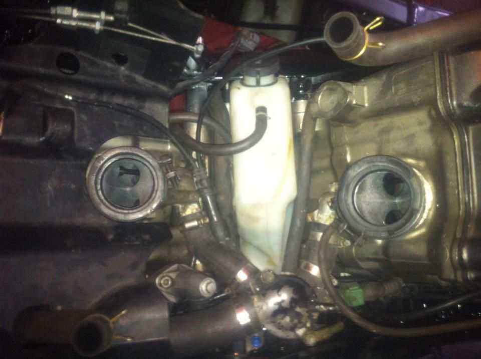

ive got it out the carb now but obviously i now cnt tighten the choke into carbs as can see in next pic the plastic has snapped away from over tightening

Bummer about the choke cable. Common mistake people make that one. You need to be very careful and not overtighten those nuts and the thread is very fine. And to make it worse they didn't need to be disconnected as the choke can be undone at the bracket by the knob on the frame, then cables lifted out with the carbs.
If cash is tight you may be able to make a bodge repair to the broken bit with a bit of glue and then gentley thread it back into the carb. It would also be a good idea to put a bit of silicone around the outside of it to hold it all in place. Not ideal though. Better to get new cables.
This pic here
The choke cable on the left should run over the top of the pipe coming out the top of the coolant bottle. Otherwise it makes it tricky when removing or replacing carbs, as like I said the whole choke can be removed still attached. What's the hose coming from the left by the choke cable there, going over the bar? :confused
Now see the hose to the right of the coolant bottle by the cct blank on the engine case. On yours it is leading down to the thermostat housing which looks wrong to me. Disconnect that from the thermo housing and that connects into the nubbin on the front carb. Now you should have another hose the same diameter that goes into the thermo housing there, and that connects to the nubbin on the rear carb.
Have another look at my pic and you can see it clearly
Click on pic to enlarge.
That's the correct way to put it back together. Lloydie is right you could get rid of them all together and bypass the carbs which is what it looks like has been done. You don't necessarily need the coolant hoses or carb heater hoses as they are sometimes called, which is what their job is. Basically IIRC what they do is, in cold condition's below zero, they pump warm water into the carbs which helps aid the cold starting of the bike and helps the fuel burn by pre warming it up before it goes in to the intake/cylinders. A bit like a de-icer.
Hopefully that clears things up and all make sense to you now. I think it's the missing hose from the thermostat housing that was confusing things. :wink:
Now where those breathers. :lol:

This is the carb heater pipe and it looks like you have bypassed the carbs already Image

so basically my carbs have been bypassed then so as it stands it is correct as it is ?
Re: alternative way to get fuel into engine
correct as it is
correct may be the wrong term :lol: but yeh it seems like it's all good. I'm a bit confused to what the hose is that comes from the left over the top of the frame and then seem to disappear near the coolant bottle. The on the top left of your pic by the choke cable. Where is that connected and where's it coming from.?
Post by scottyhatchi »
from the filler cap on radiator going to the bottle
Argh that's good then, except it should be running under that bar and the other hose that runs parallel with the coolant bottle. It may help with the flow of coolant if it's on the bottom.
