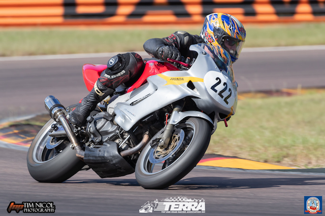

Another round this weekend.... I also haven't used the rear brake at all while racing on either my CBR300R or the VTR. i always use both brakes on the street so not sure why I've never used it on the track - too many things to think about. We've a private practice sesion in another couple of weeks so might try using the rear brake through some of the corners and see what happens....
Have also figured out how to attach photos but then went and attached it twice and can't figure out how to delete one. Doh!

No harm in seeing those twice! Nice one.
I notice you've tapped in some bobbins, I must do that.
I also notice you have an unusual engine casing, well I've not seen them before, and you've extended the oil filter protector too.

by 'engine casing' do you mean the clutch cover or the belly pan thing?
The clutch cover is standard and has now got a Carbonadi cover glued on, but I still have to have the bolt-on home-made bit on there to pass scrutineering. Looks a bit like scaffolding, but will hopefully do the job when needed.
I extended the oil filter protector with alloy strip and then fibreglassed a skin over it as we have to have a belly-pan to pass scrutineering and I couldn't get one from any of the fairing suppliers in Australia despite them advertising them still. It's a bit ugly but matte black hides a lot of sins....
Will change the clutch plates in the off-season and look at getting the fly-wheel lightened. I know of someone in Darwin who has it done and had to send it to Melbourne to get it done but not sure what's happening at the moment with the covid lockdown down there. Hopefully engineering shops are classified as essential workers!
I was also going to remove the airbox and all the associated crap inside it, but , looking at fabiostar's post about the Spondon VTR and the troubles he and others have had with that I'll just leave it alone for now. Really, it's fine as is... the track has a km long straight and the rest is fairly flowing. I lose out to the 600s down the straight but generally catch 'em at the first turn 'cos i can brake later.
