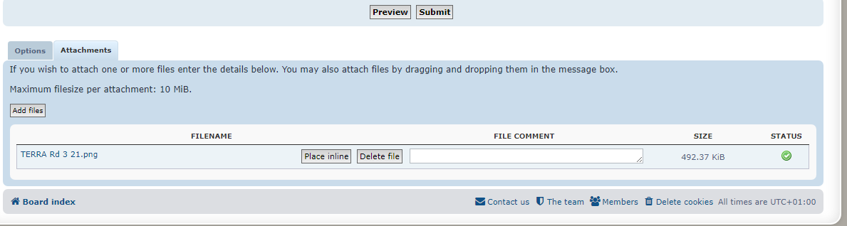

Have also figured out how to attach photos but then went and attached it twice and can't figure out how to delete one. Doh! :problem:
Just below the "Add files" button you clicked to add your photo, your attachment will be seen, you have the option to "delete file" there.
I've done it for you this time. I like your photo 8)
