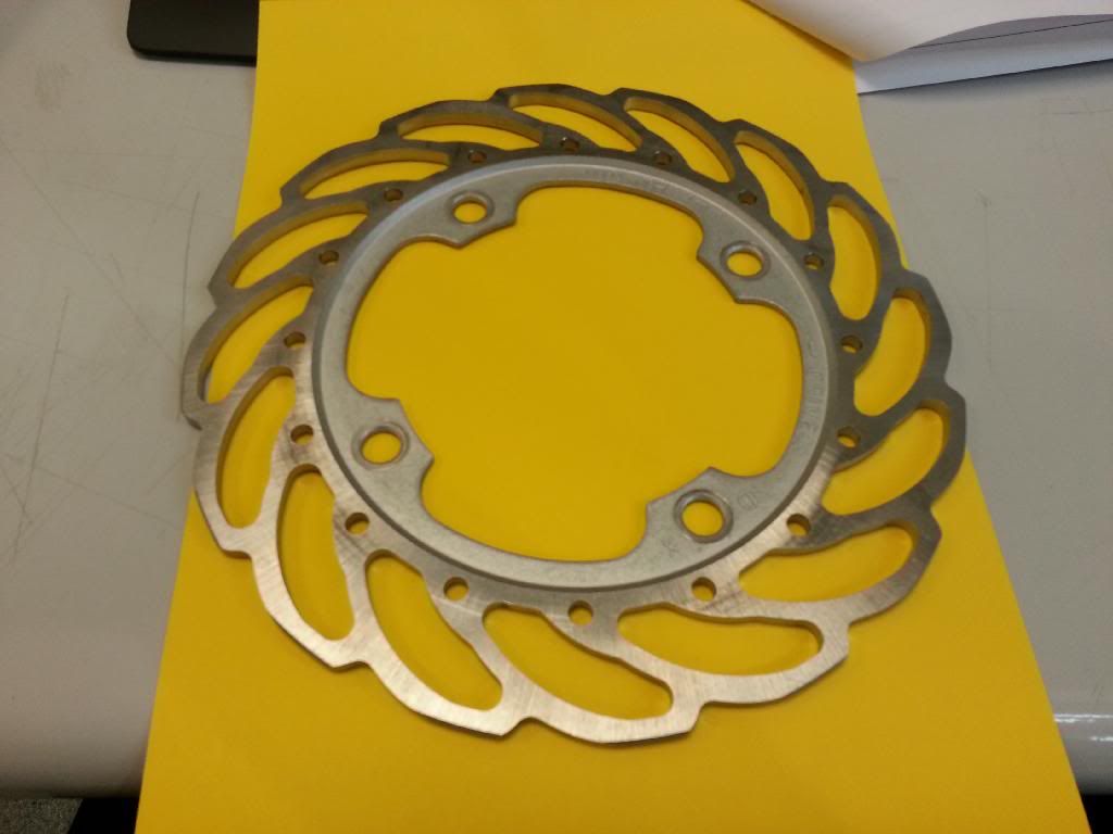

gl_s_r wrote:As I don't usually use the back brake if at all unless I have to I machined a standard rear disk I bought from Lee to make it look pretty.. well to me anyway. I will probably fit it at some time and have a change of look.
What you think, fit it or forget it?
Nice!!!! Jeezus I wish I had access to a machine shop.........
