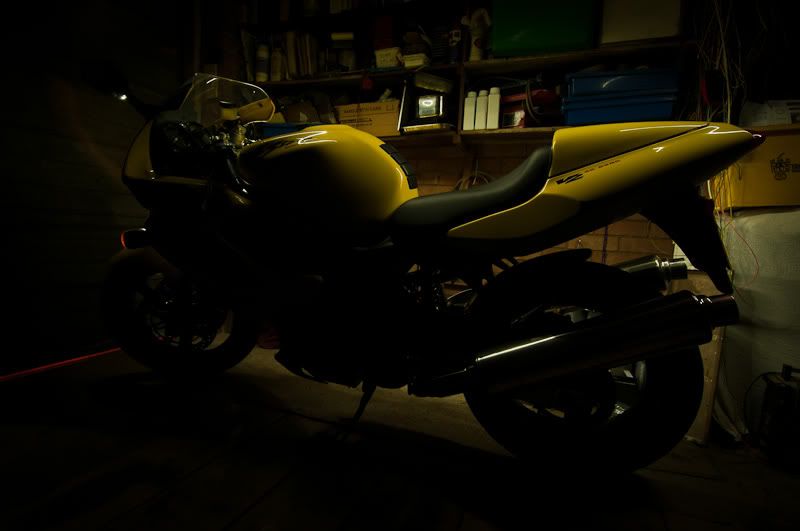

I was feeling a little artistic tonight, so I got the camera out and decided to have a play.
