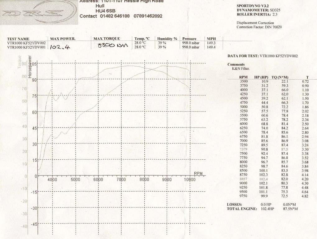

Well I went for my first Dyno run today. I knew it might throw up small probs with having the K & N in and a bit of popping at low revs (more than "normal") so was quite looking forward to it.
I used a mobile one, run by DRS in Hull and went to their shop.
The bloke was great, James. He talked through the process and did a few runs before the final one that produced the power/torque print out. He flicked through other screens whilst doing it and said that it is overall running quite lean but the K & N explains that, also it misfires lower down (you can see its unhappy at 4k-4.5k); now only 2 weeks ago I changed (after the failure) the rear coil, so this poss could be plugs or the front coil giving probs but ive got new plugs ready and I want to do the stick coils mod at some point so this will help I guess.
The peak results are pleasing - 102.4bhp and 87.5NM tq so happy. Ill take the K & N out for now and plan my cans/jetting for the new year maybe, then. I am mostly a happy chap!!! :thumbup: :thumbup: :thumbup: :thumbup: :thumbup:

thats good power........did he give you the fueling curves as well? they are the most useful

Al. No I looked at them but plan to use him again so will ask next time! (I forgot to get them off him I mean!).
He said its a strong engine. I'll prob get him to Dyno it with a kit once I've got new cans. I like Arrow but don't think they do for many older bikes? Love the Akro's!! Plenty of time to look!

nice power curve there. out of intrested when your bike sits on idle does it pop then

That's a great torque figure, you will be having fun with that...

Tony, Remember this is in Nm so it converts to 65 ft lbs in od money

Was just thinking the same, had me thinking then as mine came back as 74 ft lbs with the same power 102.03

Dave. When you blip throttle it pops a bit. Not all out of the ordinary for a firestorm!? Having the dyno run done has amplified what I was feeling but assuming was normal. Ill change plugs & consider the stick coil mod!? Griff.

I'm disappointed there's no A/F scale, it the most exciting part. :( Kinda interesting looking at the HP/Torque at different RPMs on the tight though.

the stick coil conversion will help, just ask carl, he's done just done his, imho its one of the best £30/40 you can spend on your firestorm..... :thumbup:

Nice, just keep her in that 5 - 8k rpm band and enjoy :D :D :D

Yep, new plugs & back to original filter. Haven't been out on it but hope to tomorrow. A quick blast around Yorkshire I hope! Griff.
