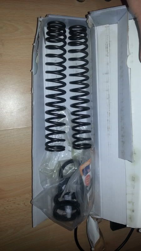

if you do get some 929 forks i have these for sale
£35 progresive fork springs for and seal kit the 929 perfect for UK roads :thumbup:
New and unused
