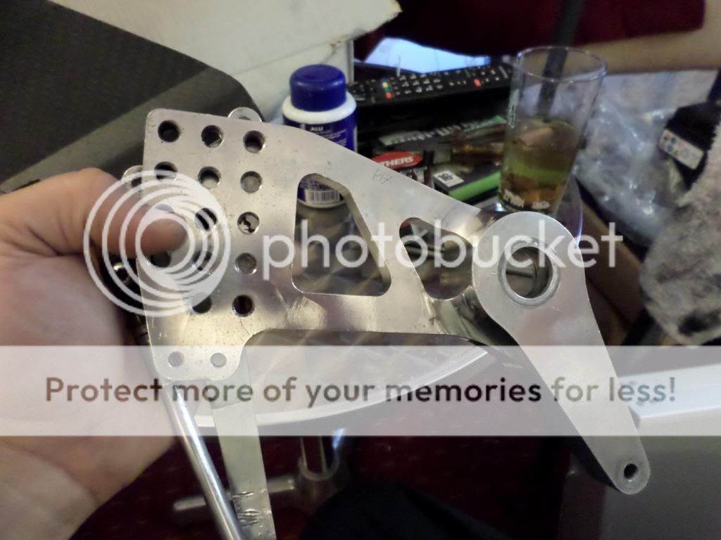

Can some one check I have all the parts please

All looks to be there as far as im aware just redo some of the old screws
Re: Can some one check I have all the parts please
Yep apart from a couple of nuts and bolts, but nothing your mechanic wont having hanging around in the garage. IIRC I used a slight longer nut and bolt on the bottom of the master cylinder link.
Get them all polished up and sealed beforehand. They are not perfect yet as I can see marks :wink: You wont want to be doing it when on the bike as it's a right faff.
Oh, and make sure the peg bolt on the back are nice and tight and threadlocked. If they work loose and you get wobbly pegs you pretty much have to remove them again to tighten them back up. :eek2

cheers carl you should have seen them befor right faf about with them had to wetsand gear rod it was that bad polish alone would'nt budge it
