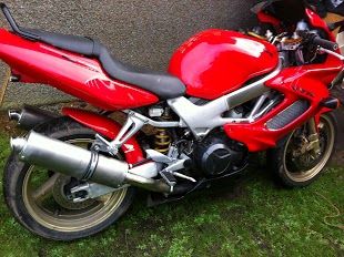

Last week I ordered some new stainless sleeves for my Art cans.
here they are fitted before the refurb.

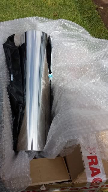

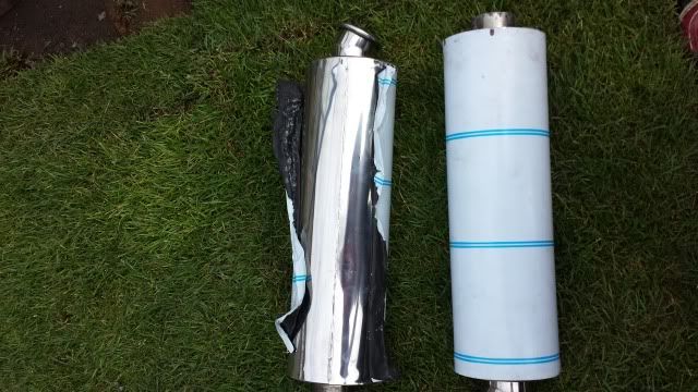

New sleeves arrived in the post

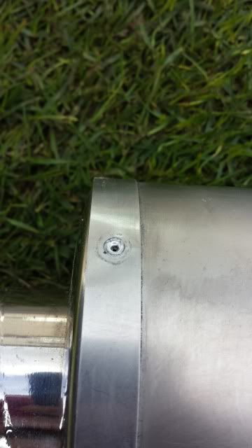

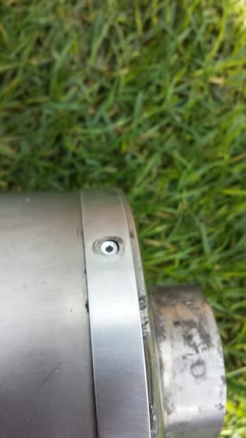

drilled the old rivets

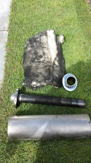

Took the cans apart. Packing was still in decent condition so I reused it.
Fitted old endcaps and wadding into new sleeves.
New rivets fitted into end straps and the jobs done.
