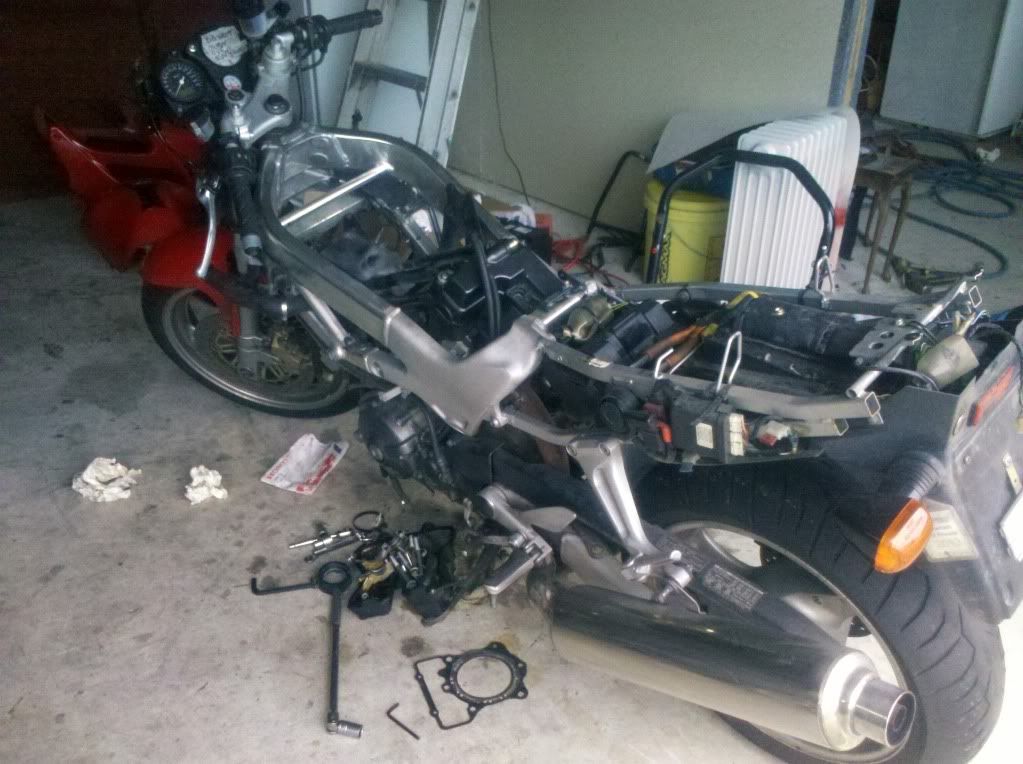

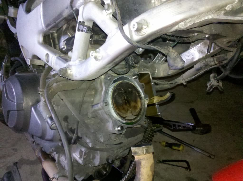

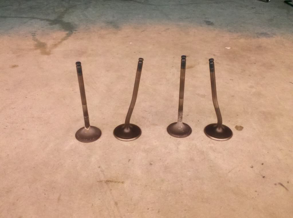

It's the best way to buy one of these, lightly damaged and a £120 fix. Less if you buy a rear head an cannibalise it for valves.
That just costs you the head, head gasket amd a couple of shims.
Oh, and a pair of manual CCT's.......
Easy to sort in a day.
