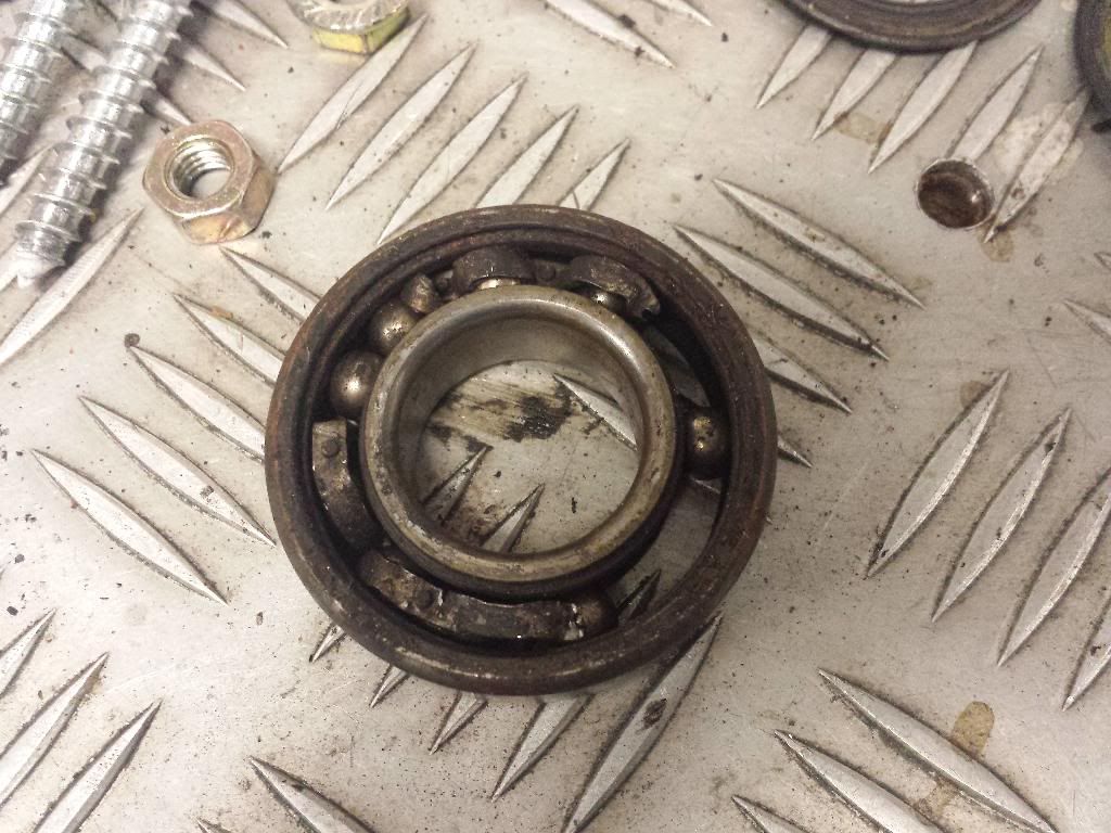

I have had the new GSXR in the garage for the last couple of weeks, the guy hasnt had much time to look at it as he's been busy, but called in today to check on progress....
Issues:
Front wheel bearing totally shot. One of them literally had half the ball bearings missing and was burnt out from friction....he has changed them 8O 8O 8O
