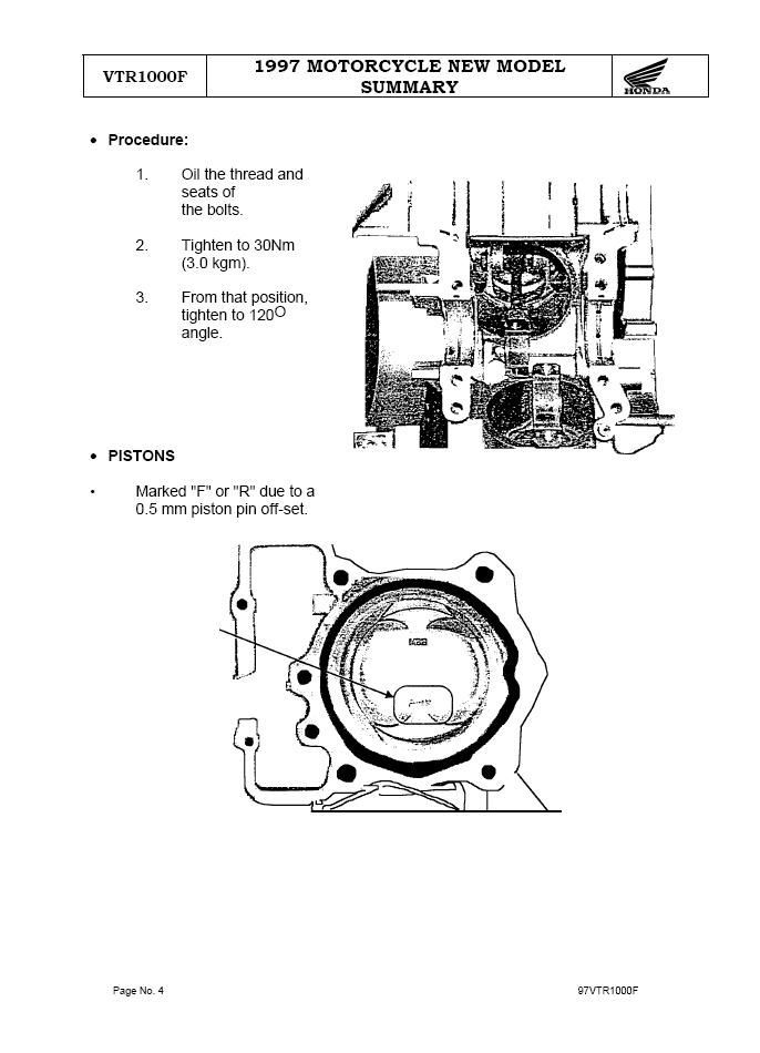

im referring to the JE high compression pistons. ive seen the stock pistons which say F and R on them, but the JE's i have arnt marked at all. ive read that someone had major problems after installing the pistons in reverse.... is there a way to tell which is which?

There's a snippet of info in the following referring to Gudgeon pin offset. Not sure if it the same with the JE's
