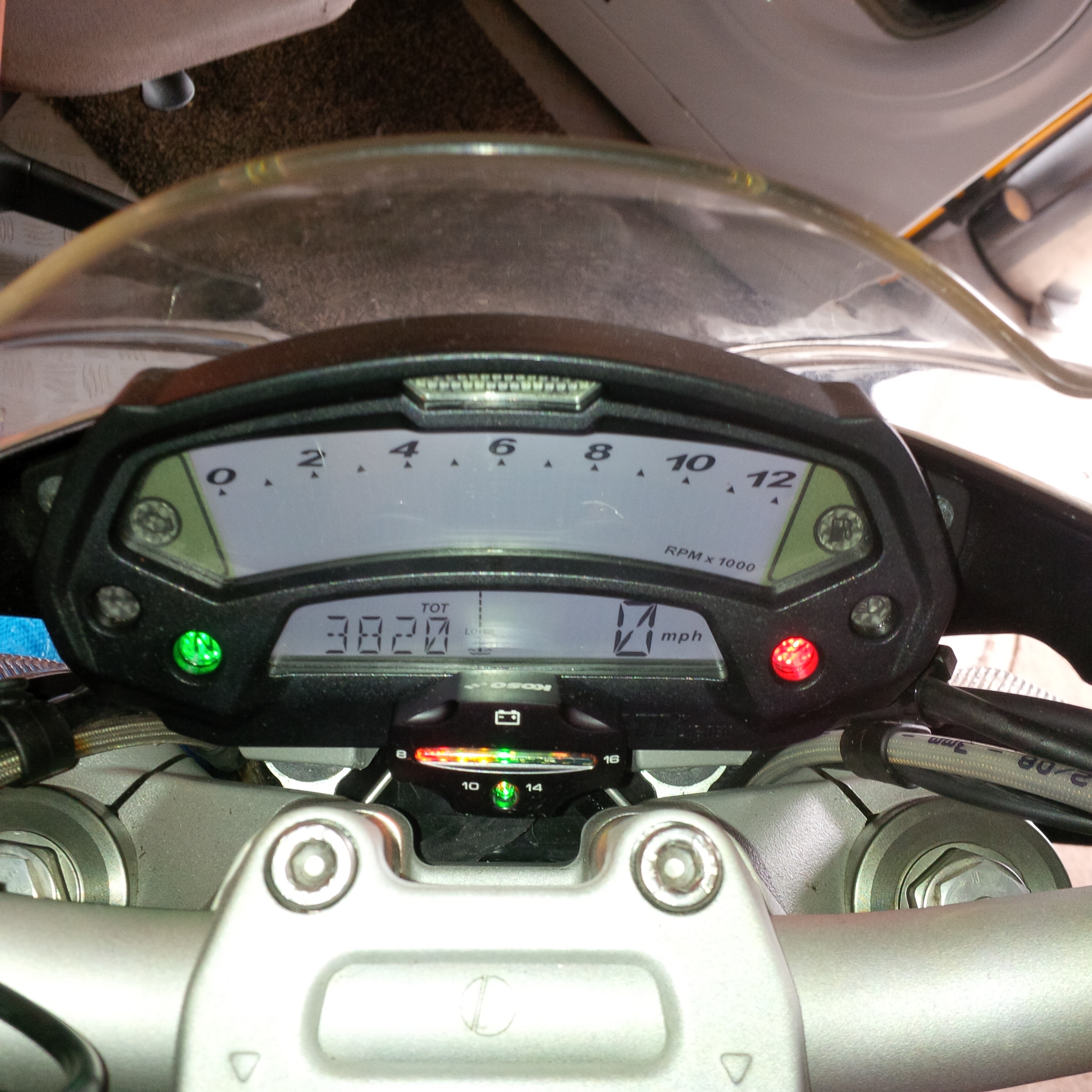

Re: Practical classics - reg/rec fix ????!
Hello al
Could you show us where you fitted the voltmeter - I hunk that is a great idea
Brian
Brian
Here it is -BrianC wrote:Hello al
Brian
That's a very tidy voltmeter that and I like where you have mounted it. Almost looks integrated into the dash.
