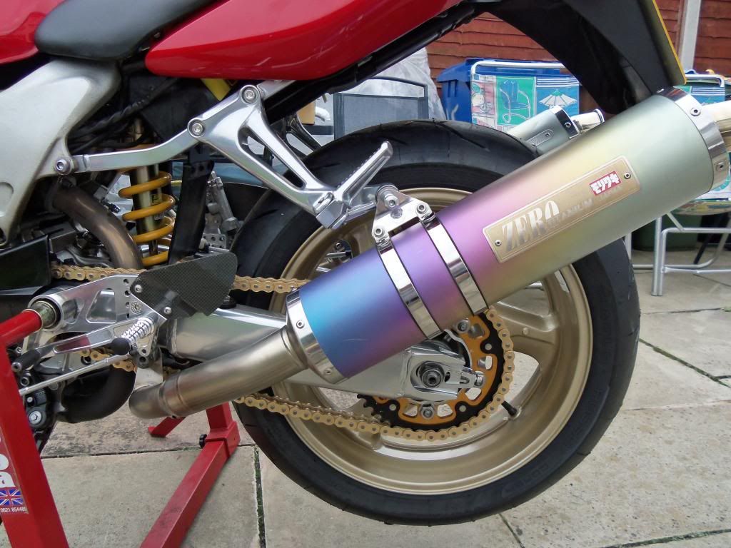

Is the smooth part of the rear swing arm painted?
Seeing as it's off might as well tidy it up
Re: Swing arm - painted ????
Has a lacquer over it so takes a bit of rubbing to get that off and buff the swingarm up to a high polish.
Post by kev64 »
Did mine recently, as was said takes a bit of effort, i used medium sand paper, then 800 wet/dry and finished off with 1200 WD
Then polished, does look better, but does take a bit of effort
