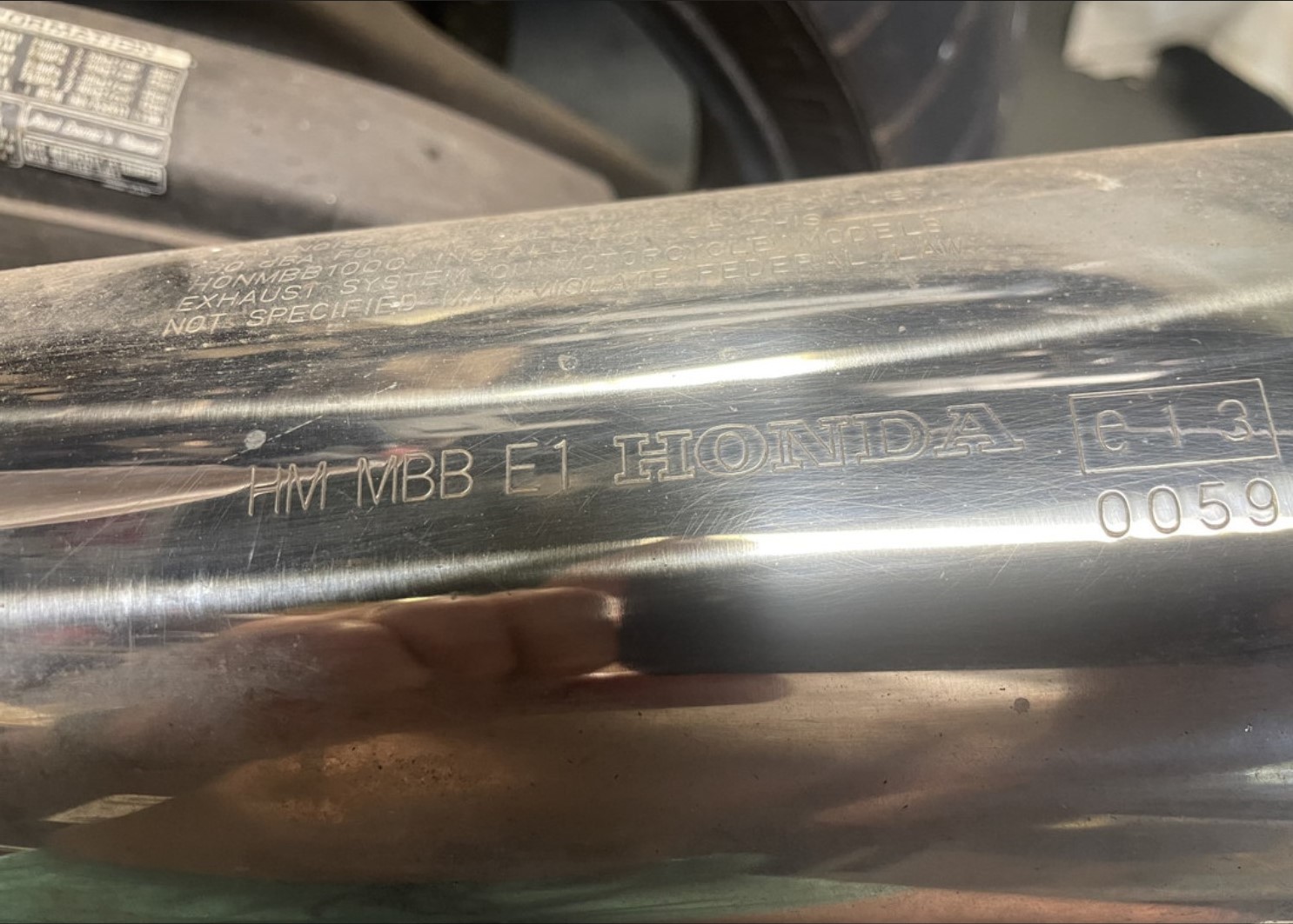

My 1997 has the original pipes and both L and R have HM MBB E1 stamped on them. Apologies for upside down photo

,,,,and just taken the airbox of the '05 bike to fix a cracked coolant reservoir and I see the same number that is stamped on the exhaust is also on the bottom part of the airbox:
Now I'm confused. :eh:
Re: 2003 exhaust
RodneyT wrote: Mon Sep 04, 2023 8:52 am ,,,,and just taken the airbox of the '05 bike to fix a cracked coolant reservoir and I see the same number that is stamped on the exhaust is also on the bottom part of the airbox:
Well spotted :clap:
I have never noticed that,
Re: 2003 exhaust
Those numbers are probably homologation numbers relating to that model's emissions or sound level certification.
If you look up the actual part number they will be different.
