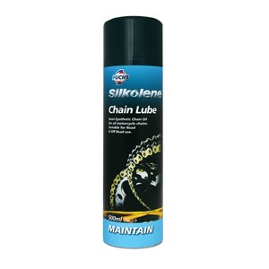

Personally, WD40 sprayed on a soft cloth (like a microfiber) does it for me every time. You don't need much, and a little goes a long way. After wiping, I usually apply Turtle wax Extreme (paste), which makes for a thin barrier of protection that also makes it easier for the lube to wipe away next time. (erm, I'm still referring to the chain, not me elbow).
You don't have to waste good WD40 though, as most poundshops have the "151" brand of WD40 style lubricant/degreasers.
If there's a lot of chain lube splatter on the plastics, you can be sure that behind the sprocket cover is jammed pack full of months of lube, and dirt, and grit.
I've tried a lot of "Anti fling" chain lubes over the years, and I've not been happy with most of them. But, my 2 top choices for chain lubes are BikeTek and Silkolene. The Bike Tek stuff was £10, and the Silkolene comes in at around £8. Both go sticky really quick, and the mess at the back end is now just little splatters.
To cut down on chain lube fling off, always lube yer chain when it's warm (bike just been ridden), as the lube "melts" easier in to the chain plates. Lubing on a stone cold chain (before you ride) will see it fling everywhere as soon as you set off!
