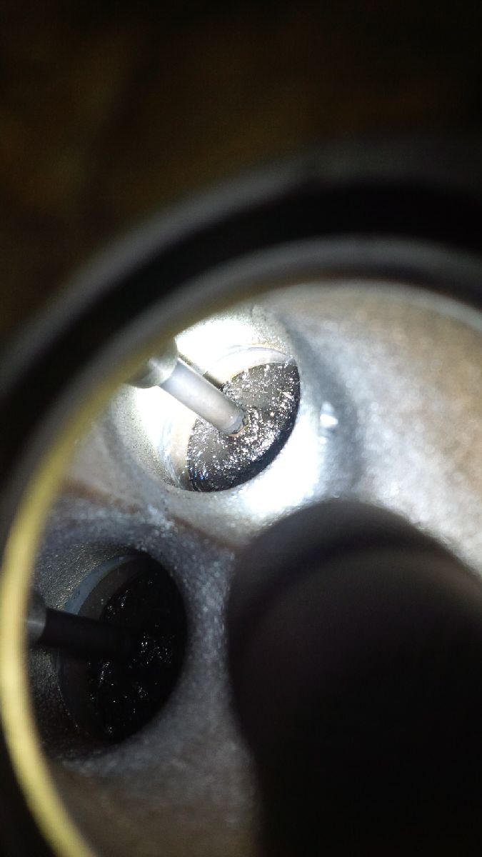

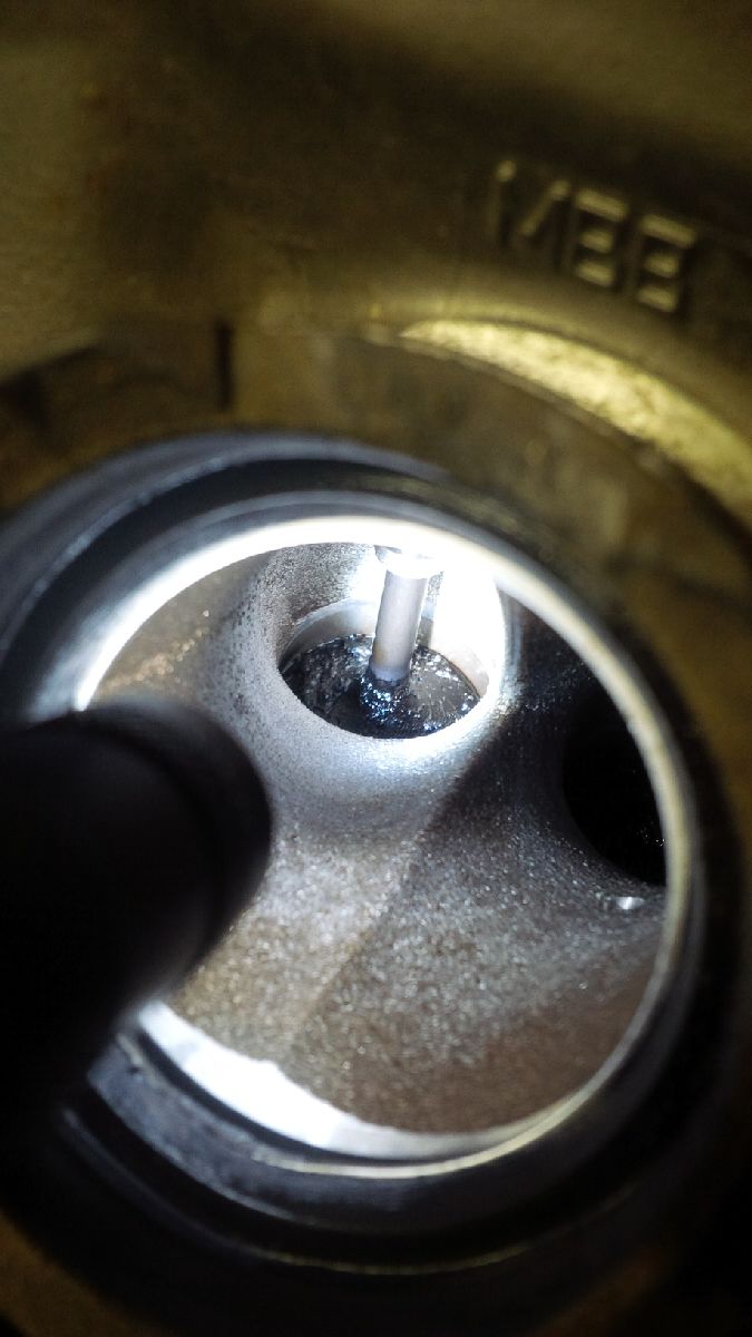

While the carbs were off, I inspected the intake valves and was surprised how gummed up they were, it doesn't look normal. Old/bad gas run through it? I added seafoam to my tank to help clean it up a bit over the next few months. Rich? Pics attached.

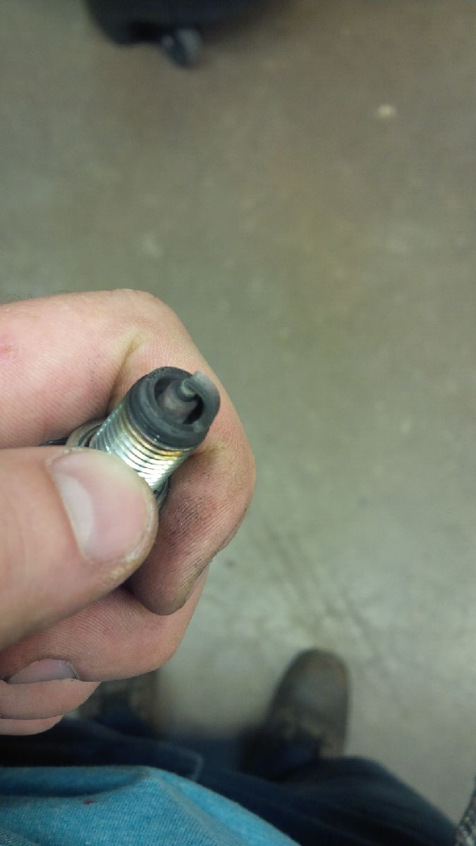

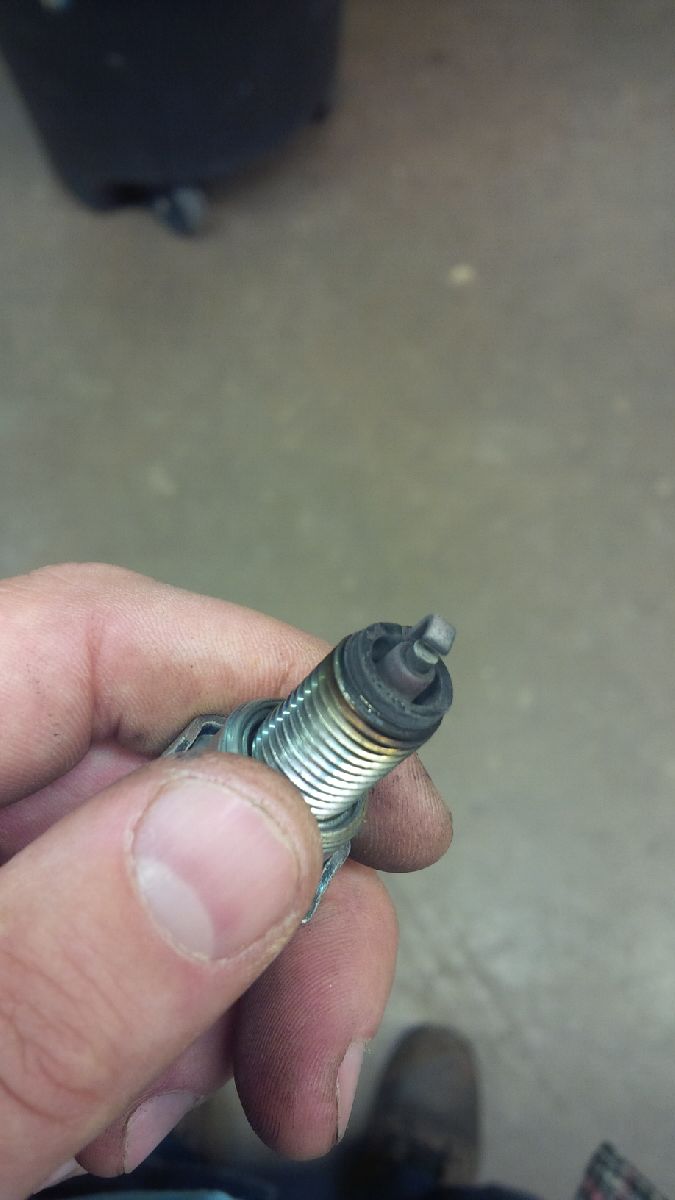

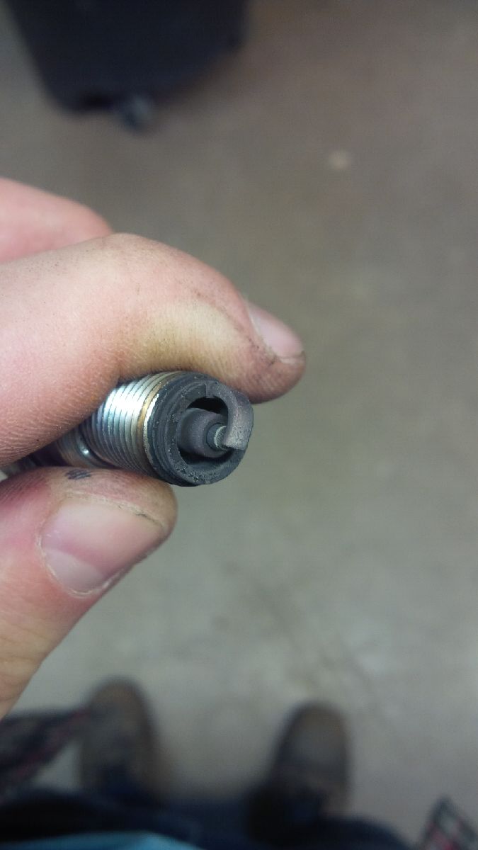

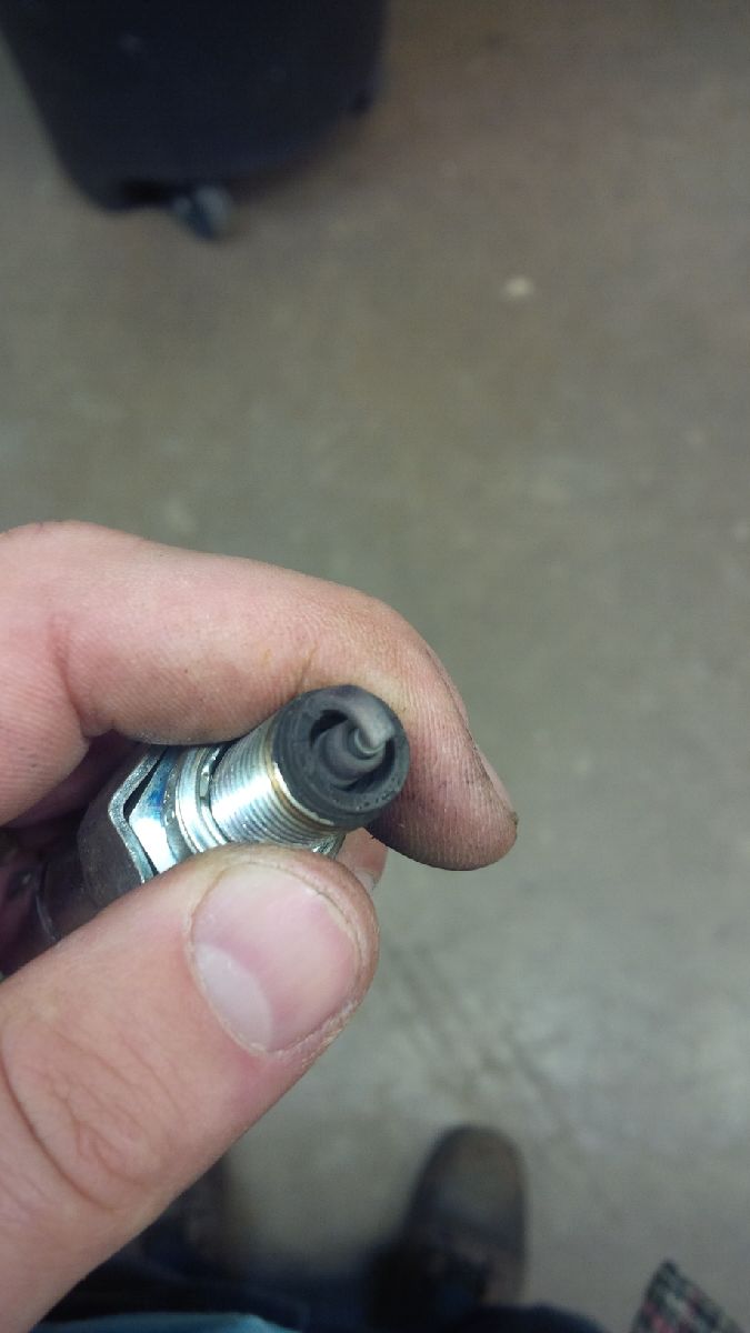

I pulled the rear plug and I thought it looked a tad white-ish. Lean? Pics attached.

The plugs look too rich to me. Also, they should be Iridium. I would change them.
The top of the inlet valves look horrid. Leaky valve seals perhaps? Letting oil onto them?

Wow those valves are yuk. I wouldn't bother with seafoam and stuff as often these kind of additives don't always help and can actually add to the gunkyness, damage oil seals etc. Sometimes a little gunkyness is a good thing as it helps block small leaks. If the bike has been sitting around a while it should all hopefully burn itself off with good use once dialled in and things are running nice. Leaky stem seals is a good shout so keep and eye on them.

I wouldn't worry about the plugs just yet. Keep them as they are easier to read while tuning. Iridium's are not reliable enough for looking at the colour when trying to work out what's going on.

I assumed those were the factory stock plugs. One thing I noticed when I took the K&N filter off there was approx 2 tablespoons of filter oil pooled in the airbox. I wonder if it's possible the filter was over oiled and some of that was breathed into the engine. Maybe a bit of a stretch. Would bad gas cause this issue? Wouldn't it be odd for such a low mileage bike to have leaky valve seals? I will run a compression test next time to verify this.
