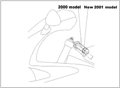

Later version has slightly firmer fork springs, still a bit soft but much improved.
Handle bars are in the same position but the downward angle is less so the bars are far more comfy.

Re: Mk1& Mk2 comparison
See the following link which includes the Honda sales brochure.
http://www.burniemorgan.com/firestorm/vtr2001.html

Ahh, yes, the flatter bars forgot about that good catch.
