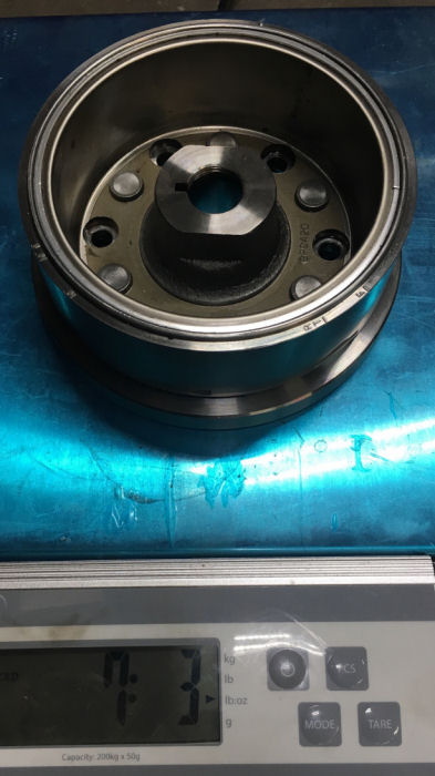

Was asked to do a Moriwaki cut on a flywheel this week..not something I normally do anymore, but as I was already set up for flywheels this week it was an easy deal to knock out.
I was a little surprised at how little weight it removed.
Started at 7lb 3 oz

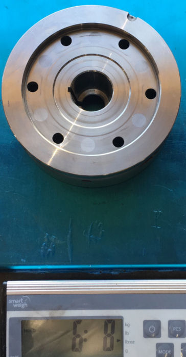

Removing 0.50" of OD from the weight disk only finished at 6 lb 8 oz
Reduced by 11 oz
