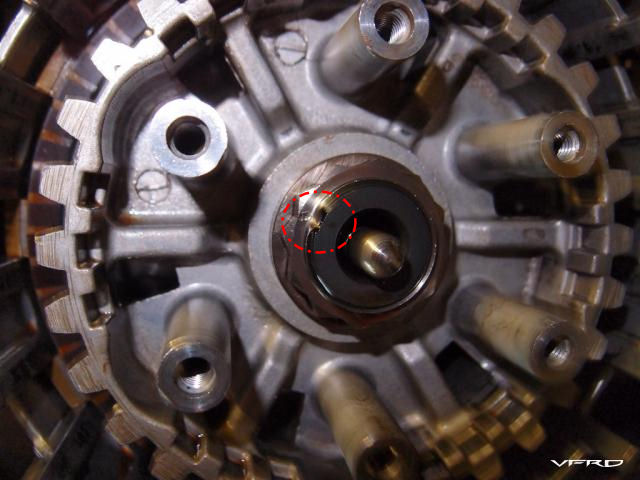

ok this one has my toolbox stumped :sad2 . trying to replace my worn clutch basket with a fitter one and new plates but the large star shaped nut holding the centre basket on? wtf kinda yoke fits that?
iv never removed one on a storm before.. tell me its not a honda tool of some sort??

A standard 12 point 30 mm socket fits on there, just remember you have to un-stake the nut before you remove it

unstake you mean were its been punched ?

Yes you need to address the bit that is pushed down into the groove. I use a dremel and just cut that bit out but you might be able to get something under it and lift it up.
Another clutch "trick" is to leave the clutch plates in place while removing the center bolt. This usually causes enough grab on the basket to be able to spin the nut off with an impact without a holding tool.
Grind off the small staked dimple on the nut before removal..be mindful not to grind into the shaft keyway
There are "tricks" to removing the nut with out a proper bought or homemade clutch holder,,,, but if you try it with something just wedged in the basket or hub, there are plenty of posts telling the tail of broken baskets or hubs..

You can push the dimple back out using a small cheap electrical screwdriver.
The nut can then be reused if it has no cracks at the dimple.

Honestly, in the 20 or so VTR clutch hub nuts I have removed......I used an impact..... the "stake" moved well enough on its own with no damage, marks or evidence on the shaft at all.
Reinstalled the same nut using high strength thread lock , and re-staked the nut. :biggrin
