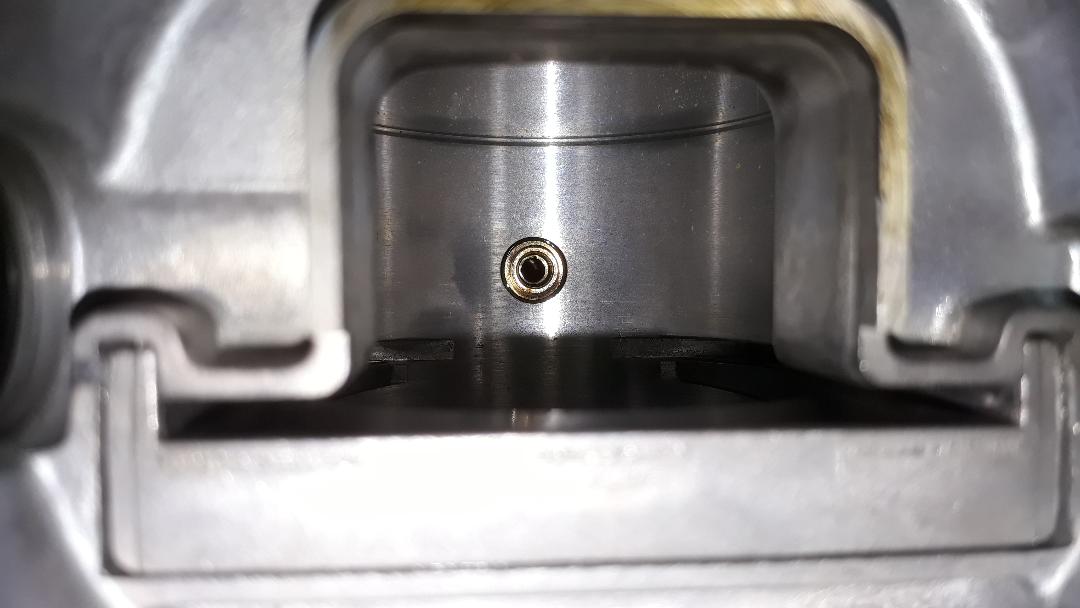

Have just pulled the carbs apart for another look and checked the needle jets (guides) as suggested my a workmate, they are definitely worn oval in particular the rear one.
As previously mentioned the bike has only done 14K, but there was a lot of old hard petrol varnish build up on the needles which I managed to clean off.
It appears that the needle jet is not a replaceable OEM part but I have read on the forum that it has been done.
"The needle guide is pulled out with a slide hammer and pressed in with a guide rod machined fit to the ID"
I googled VTR needle jets and could only find "Factory Pro" in the states and they want the whole carburetor sent to them
Can someone please advise if there is a company in the UK that makes them and what is involved in removing the old jets (guides)
