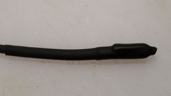

Here is a better way to seal off that unused wire end.
It takes two pieces of heat shrink tubing (or three if binding together more then one sealed wire)

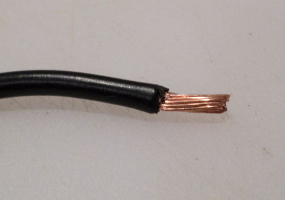

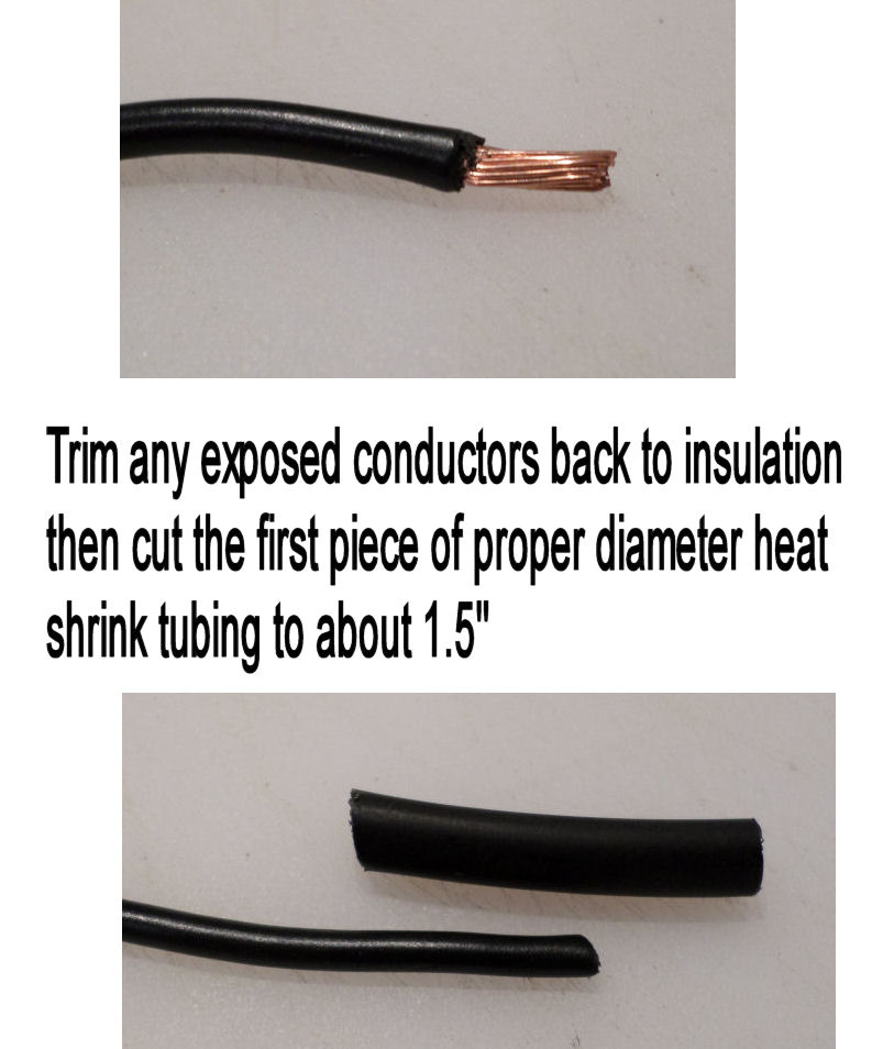

Trim any exposed conductors back to insulation, then cut the first piece of proper diameter heat shrink tubing to about 1.5"
Slide that piece over the wire about 1/2 way though tube.
Heat and shrink the tubing
step 2-5.jpg (46.24 KiB) Viewed 2710 times

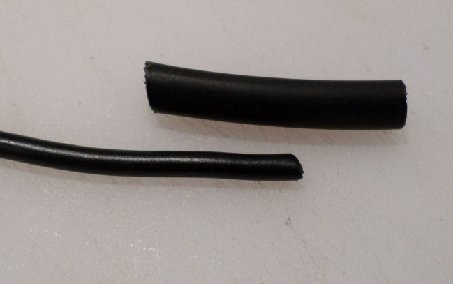

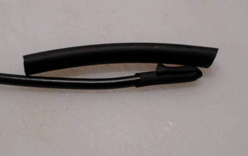

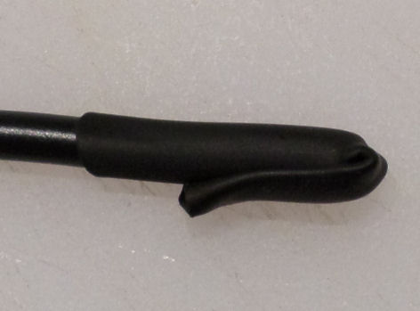

Fold back the end of the tubing that extended past the wire end
Cut the second piece of tubing long enough to fully cover the 1st piece plus 3/8 ~1/2"
Heat and shrink the second piece of tubing to finish the seal.

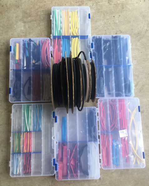

I prefer to use double wall adhesive lined heat shrink tubing for the job.. I use 3M Adhesive-Lined Polyolefin Heat Shrink Tubing and 3M non lined Polyolefin Heat Shrink Tubing, but many other brands are out there as well. Do a Google search for "heat shrink tubing" and "adhesive lined heat shrink tubing" then pick what you want in the size and color.Look at the shrink ratios and starting size to understand what size it will end up.
Regular heat shrink tube does a ok job as well for sealing an unused wire end, just not quite as weatherproof...Suggest you always use the dielectric silicon on wire tip in step one is not using adhesive lined tubing.
Heat shrink tubing.jpg (82.68 KiB) Viewed 2709 times
Consider buying just a little more then needed for the job at hand and soon enough you'll have a collection that gives you the proper size tubing most every time.

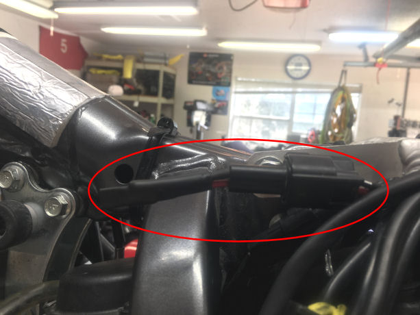

If you have more then one wire left over, you can slip a third piece of tubing over the wires and shrink down to create a niece secure, protected bundle that loose clean. Like this
For this particular task I was asked to keep the associated plug in place and terminate the unused wires after the plug. This gives the owner several options... If desired later at time of resale, or change of mind, a simple job of re-soldering the cut off switch and its wires returns the wiring harness and bike to "stock".
Also in this case that plug and its circuit is a key on hot 12v power and ground source the owner can use to power (though a fuse please) a low wattage add on device, like USB charge port, GPS, ect. and it has a nice modern sealed plug to disconnect that added mod as needed.

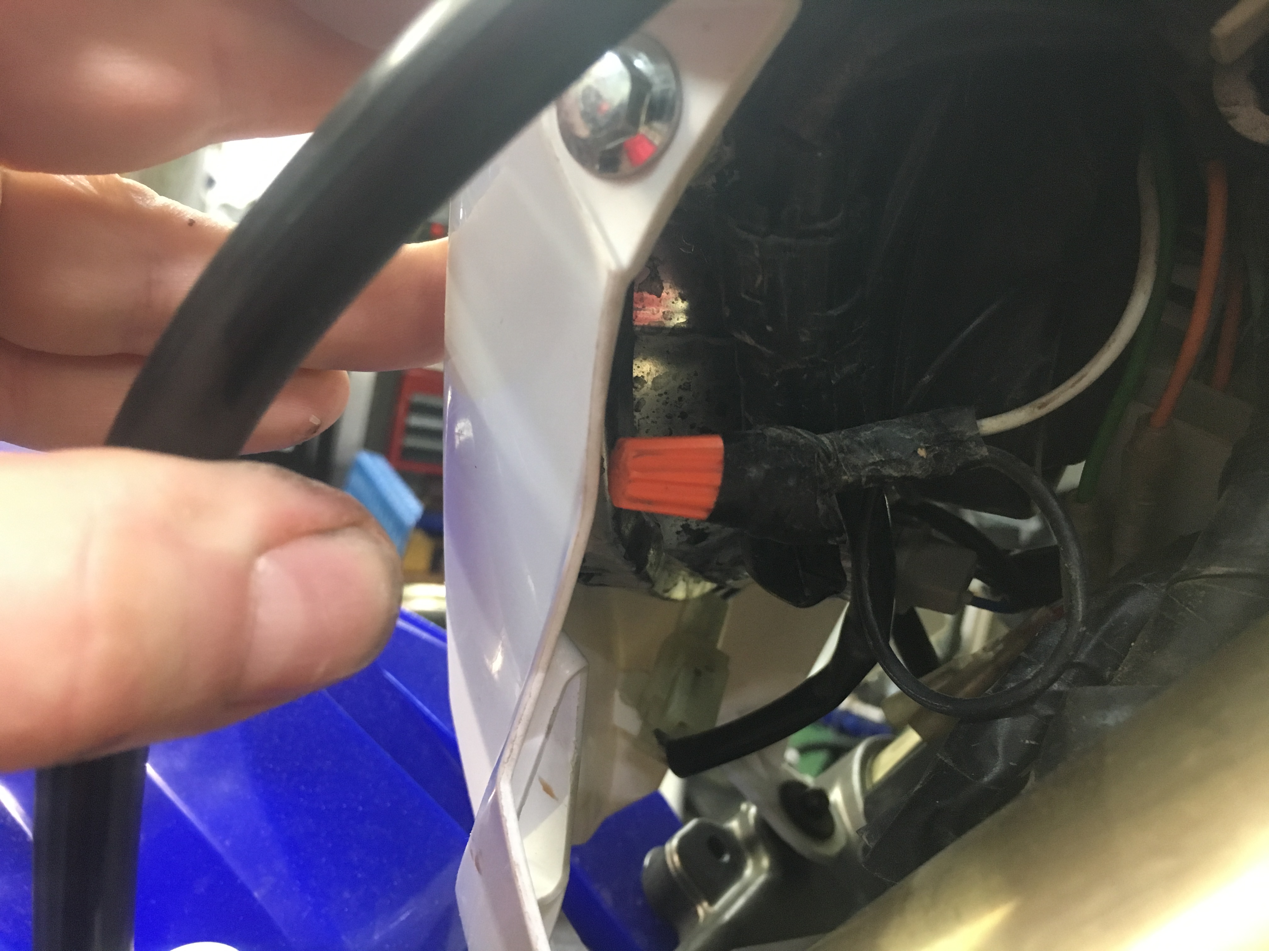

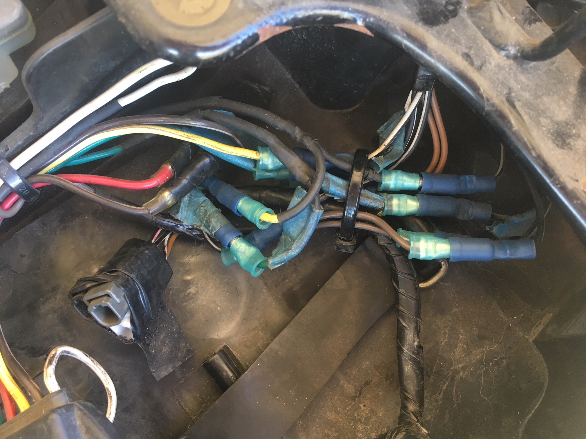

This is what Im working on today
along with the same guys "new" 2012 WR450F that is getting a refurbishment wheel to wheel to like new condition as well as a host of upgrades.. Poor thing has been worked on and maintained in like condition and ways that wiring mess is above

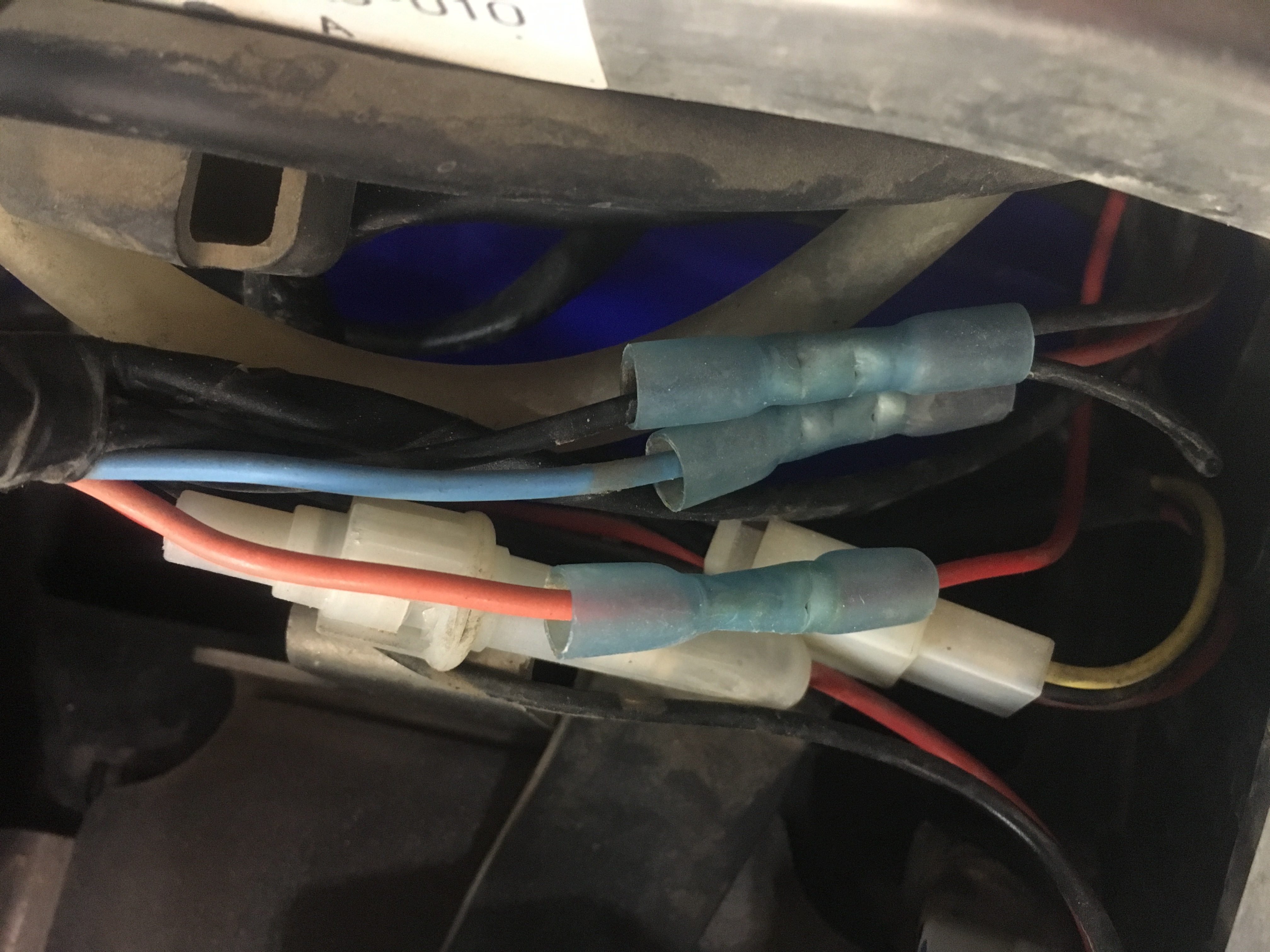

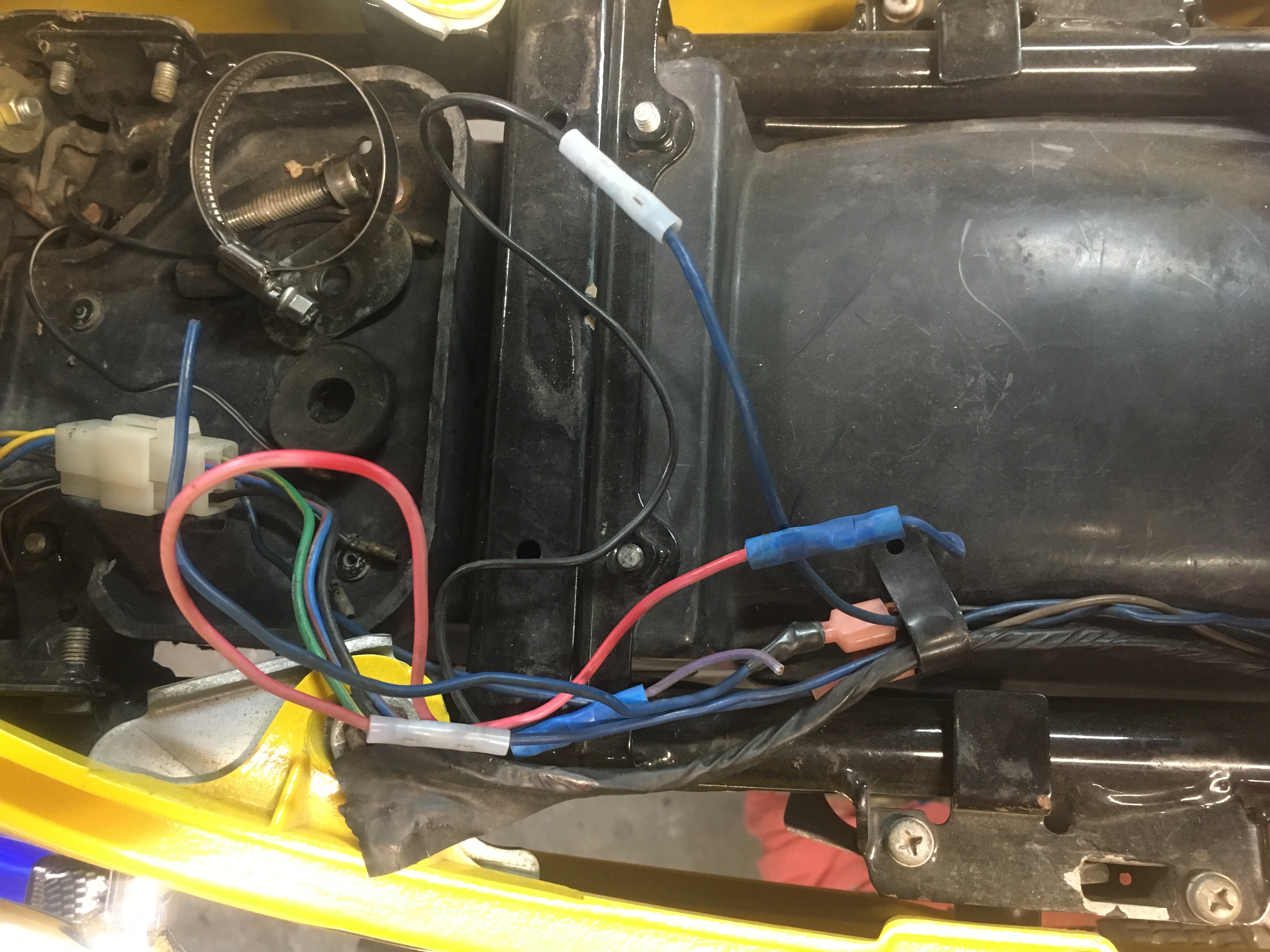

This was part of the wiring on my last Falco before I started fixing it.
Un-used ends finished off with the double heat-shink method -
Upgraded R/R unit installed with up-rated wiring -
