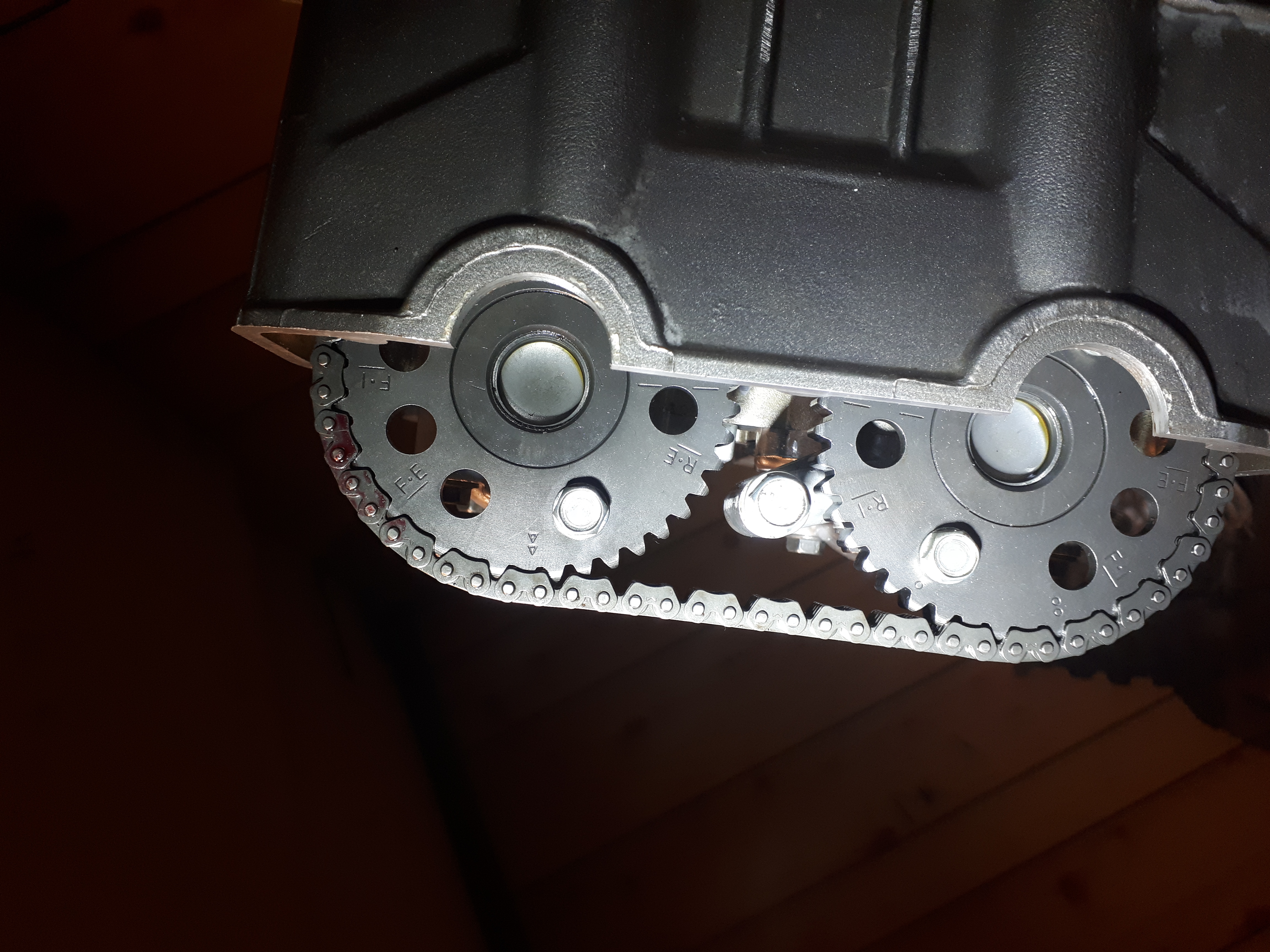

Anyone know what's going on here? I have the flywheel on the FT mark and I cannot get the marks on the front cams to line up with the heads.
If I move them one tooth they are facing slightly down if I move them one the other way they are slightly up.
I think maybe a attached chain. I also had .002 thou off the block.. not enough to change anything.

Just set it to the nearest one.
It makes very little difference.

Same on my 70,000km bike. I put the difference down to chain stretch.
Re: Timing marks not aligning
same here on the front pot. i just set them to the closest one..

There s another mark a little before the real FT mark on the flywheel, make sure you're on the correct one, it may line up then. If you do have it right then what the others have said :thumbup:

Thanks guys, I defiantly had the flywheel lined up right. Must just be streched chains. All put together now.
