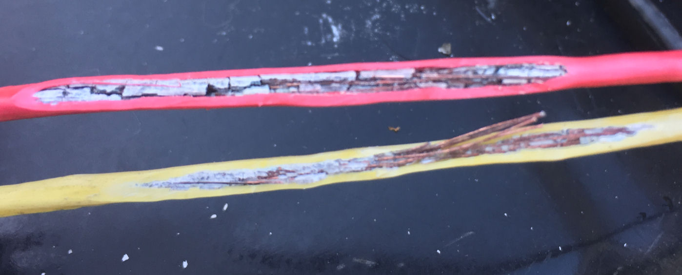

My bike took a crap while warming up today, ran beautifully yesterday, 480 miles. Starter a treat today,,,then just shut off.
Had body work off installing new radiators so took a few min to get off the what did I di now, kick and dig in and do a proper diagnosis, No spark led me to no power at the converter but power at the ignition fuse. So that means someplace between fuse and converter....that would be kill switch (or bypass I dont run a switch) and a bit of wiring.
So start cutting into the outer cover heat shrink tube and I find,,,,, water , cut into the paired wires heat shrink tube and I find...water.
Cut into the kill switch wires and I find.....corrosion and a broken wire.
OK well sure, water intrusion can do that....But I got curious about the other wire spliced in....
YUP, both sections of wire spliced in, the entire add on length, corroded and trashed.
The OEM wire soldiered too was fine other then right at the connection.
So its just the aftermarket wire, which was supposed to be decent quality

VTRDark wrote: Wed May 09, 2018 10:02 am As it's the ignition cut the wire could be the remains of an old alarm or hidden switch that as been reconnected to the other side of the ignition cut. :think: That's what comes to mind first.
No nothing like that..
The harness was in factory state before I removed the factory kill/start buttons and added different ones, then later removed the kill switch.
The corrosion seems to have started at the "bottom" and wormed its way up the wire.
An educated guess is, water was driven in the triple protected wiring by wind and water pressure while riding in the rain.
Looks like I did not use adhesive lined tubing on the individual wires, which is weird as I always do.. I have 8 storages boxes of the stuff and use it on every wiring job I do..... All my heat shrink tube was in the same 60L container ..I must have grabbed the wrong type tubing in yellow and red when I did this job.....Picking non adhesive lined by mistake.
