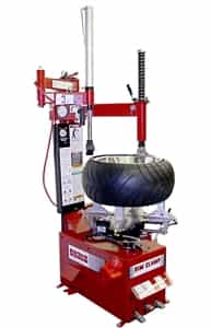

This is what you want for DIY tyre changing:-

Thanks for the advice. Excuse my ignorance but what does the tyre changer do and what makes it hard work with just the bead breaker and tyre levers?

jchesshyre wrote: Wed Aug 01, 2018 10:39 pm Thanks for the advice. Excuse my ignorance but what does the tyre changer do and what makes it hard work with just the bead breaker and tyre levers?
It can be very hard work removing and refitting tubeless tyres with just tyre levers.

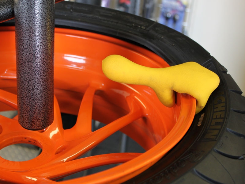

I change a LOT of tires .. 90 training bikes, 6 personal bikes, customer bikes in and out of the shop a lot...
Most of those are done with a manual bead beaker and tire stand, 3 levers and a tool called the "Yellow Thing" that holds the bead in place as you lever the new tire on.
If you get a manual breaker or stand, make sure the center hold down fits your wheel axle diameter for the common wheels(tires) you will be changing.
So wheel stand, rim guards (4), 3 levers( at least 2 long ones) a Yellow Thing
and spray bottle of tire lube, Dont skimp on the lube :p Not dish soap and water, not the stuff you and the misses use, but tire lube....Its not that much in cost and it works better over home spun make do.
Dynamic Balancing done on a Snap On motorcycle wheel balance I all but stole from a shop that had to upgrade in order to balance the ultra fat rear wheels that come on HD and some metric cruisers. Its an outdated one in today's market, but will handle any wheel I will let in my shop, so works for me.. There are likely deals like this all over as the fat wheel marketing craze continues at least here in the US.
If your not going to dynamically balance them after mounting, and we are talking street bikes, Id say skip the whole thing..Some will say static balancing works good enough, and I suppose, if good enough is ok with you, that's true. Personal I want it done right, the best way possible.
The only tires I wont change right now is on bikes with clean, nice and expensive wheels. The risk to the wheel finish is just too great.
