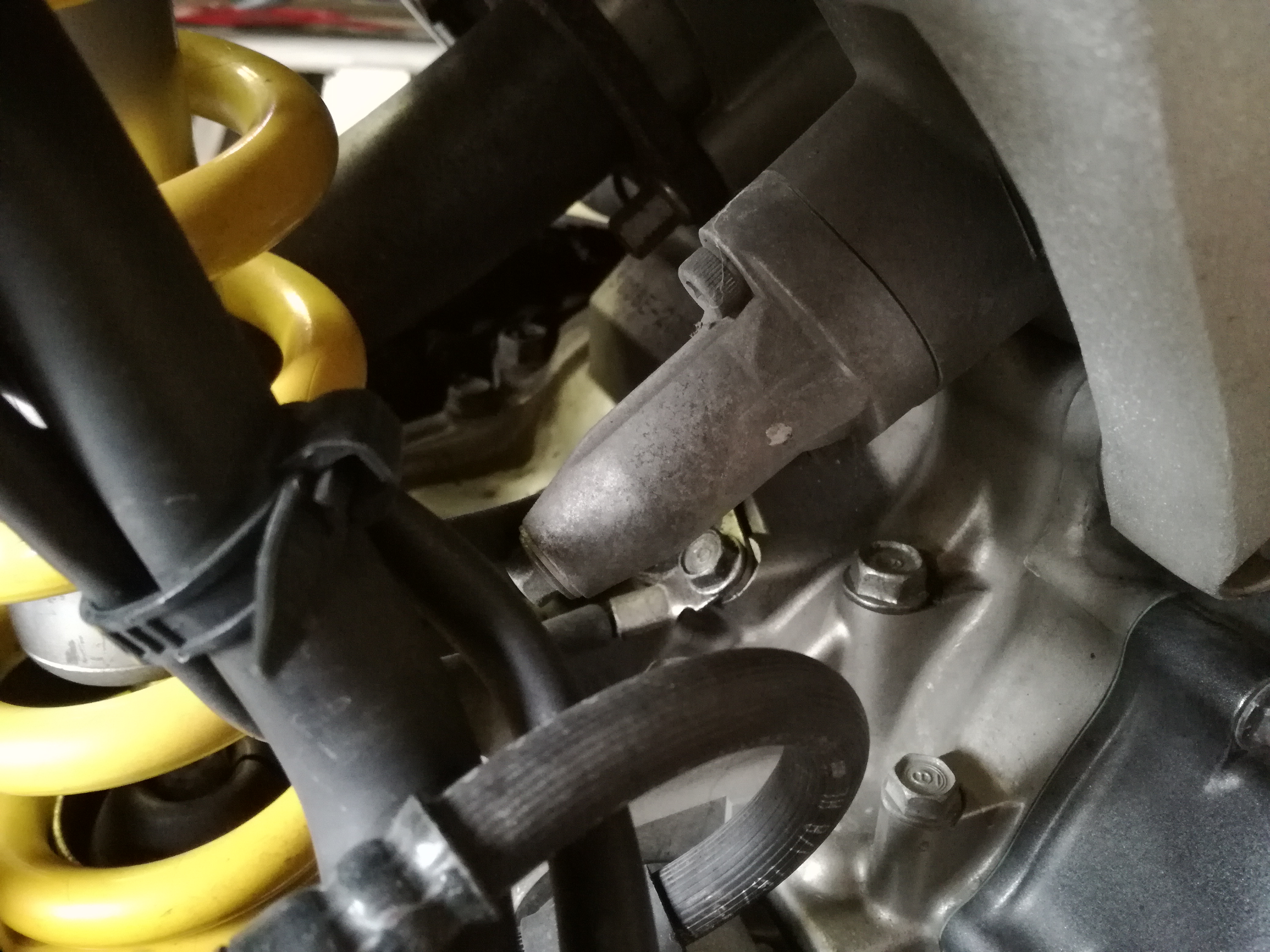

Get a picture up of one of the CCT's, rear is easy to see...
It will show if it's std or a manual... However it may have had whats known as 'stopper mod' done to it which other than taking it apart you won't be able to see.

Here is a picture og the cct.... Looks like it is an original Honda cct.
