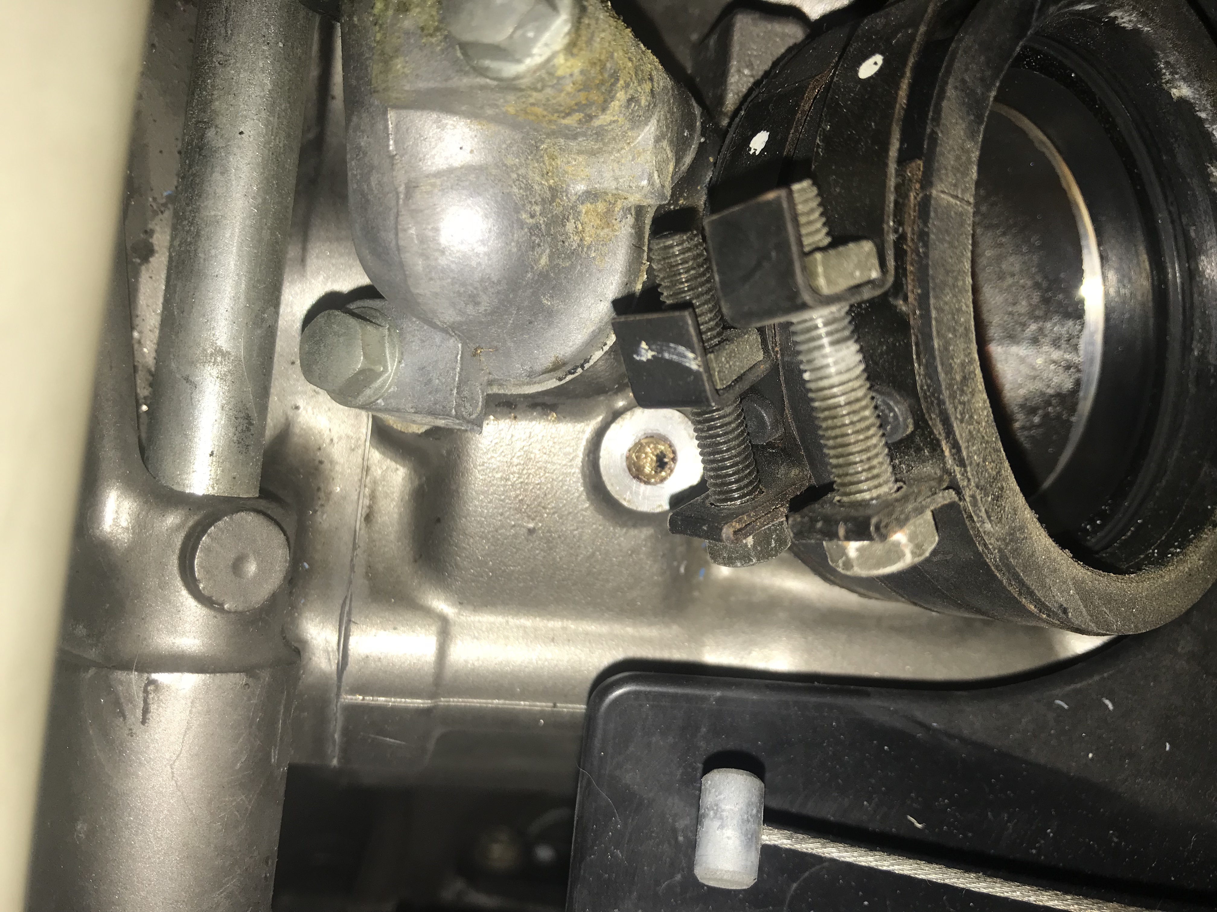

Obviously it appreciating how soft brass is relative to steel, I overtightened the brass fitting I was using to do the carb sync mod and snapped it off flush with the jug. Of course, I used loctite since it was never coming out. Any suggestions? I’m dying over here! Ugh

EJamesJr wrote: Wed Aug 15, 2018 5:11 am Obviously it appreciating how soft brass is relative to steel, I overtightened the brass fitting I was using to do the carb sync mod and snapped it off flush with the jug. Of course, I used loctite since it was never coming out. Any suggestions? I’m dying over here! Ugh 7AF12D8D-5864-4FEB-A77B-60BF81D790FF.jpeg
Left hand drill bit...
Engine out to get at it tho unless you can find a 90* adapter for your drill...
Good luck trying... It will run a bit pants with it open to to air, so as a fix so you can ride whilst you seek a solution, block it off with epoxy...
Re: Broke off brass fitting in front intake. Ideas?
A bit of mild heat to soften the loctite (what colour loctite did you use?) and a fine screw extractor - careful as you as brass will be quite a bit softer than the extractor.
Access will be fun bit if you haven''t already removed tank, airbox & carb. If you need to temporaily seal it to run about before removing the broken part I wouldn't use epoxy as that could run inside before setting, just plug with say a cut down rounded match, golf tee or something softer than the brass and easily removable but capable of making an airtight seal.

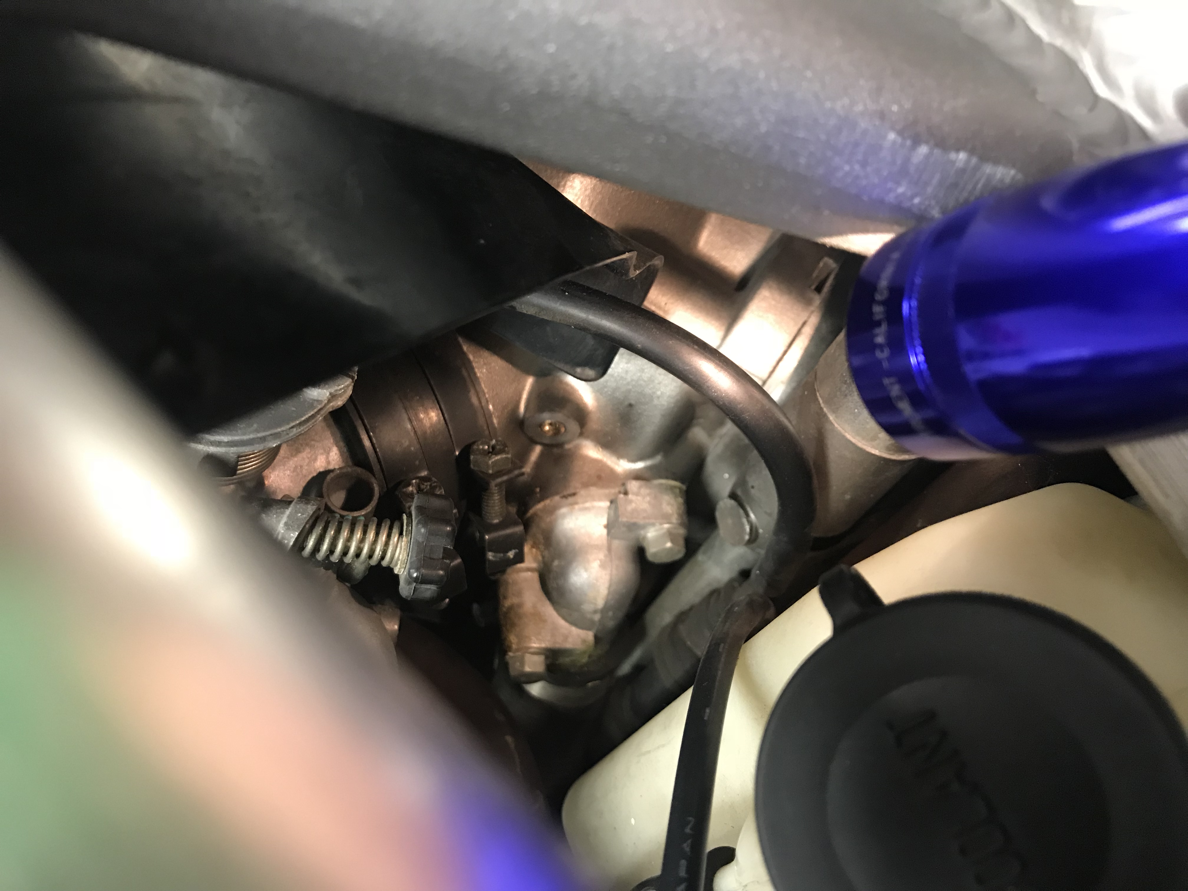

If I remove the carbs, is the back of the opening accessible from inside? Seems to only be about 1cm or so from the black carbs seal. Just thinking if I have to tap it or have risk of filings getting on there, I could do some preventative measures by accessing the back.
You just need to gain access - it is a long stretch from the top. Brass fitting just need unthreading back out - it'll already have a hole to gain purchase so one of these extractors (see below) warming up the fitting & softening the loctite. Cobble togther a long handle so you apply good pressure when turning with possibly another hand down below to guide it in.
Yes pack some lint free rag into any critical openings - esp if you need to recourse to drilling (keep hoover handy)

Thanks for the help. Going to try the heat and easy out. Praying that does the trick. Will remove the carbs to free up some room. The bike was running fine so wasn’t going to touch them.
I literally rode the bike home from buying and have pulled it apart to maintenance everything. I have done the coolant flush, clutch flush, front and rear brake flush, new air filter, new plugs , oil and filter. The carb sync was the final thing. I’m so annoyed at myself.
I’m in New Jersey, USA. My son is a mechanic and had a set of easy outs. He’s going to help tomorrow. Fingers crossed.

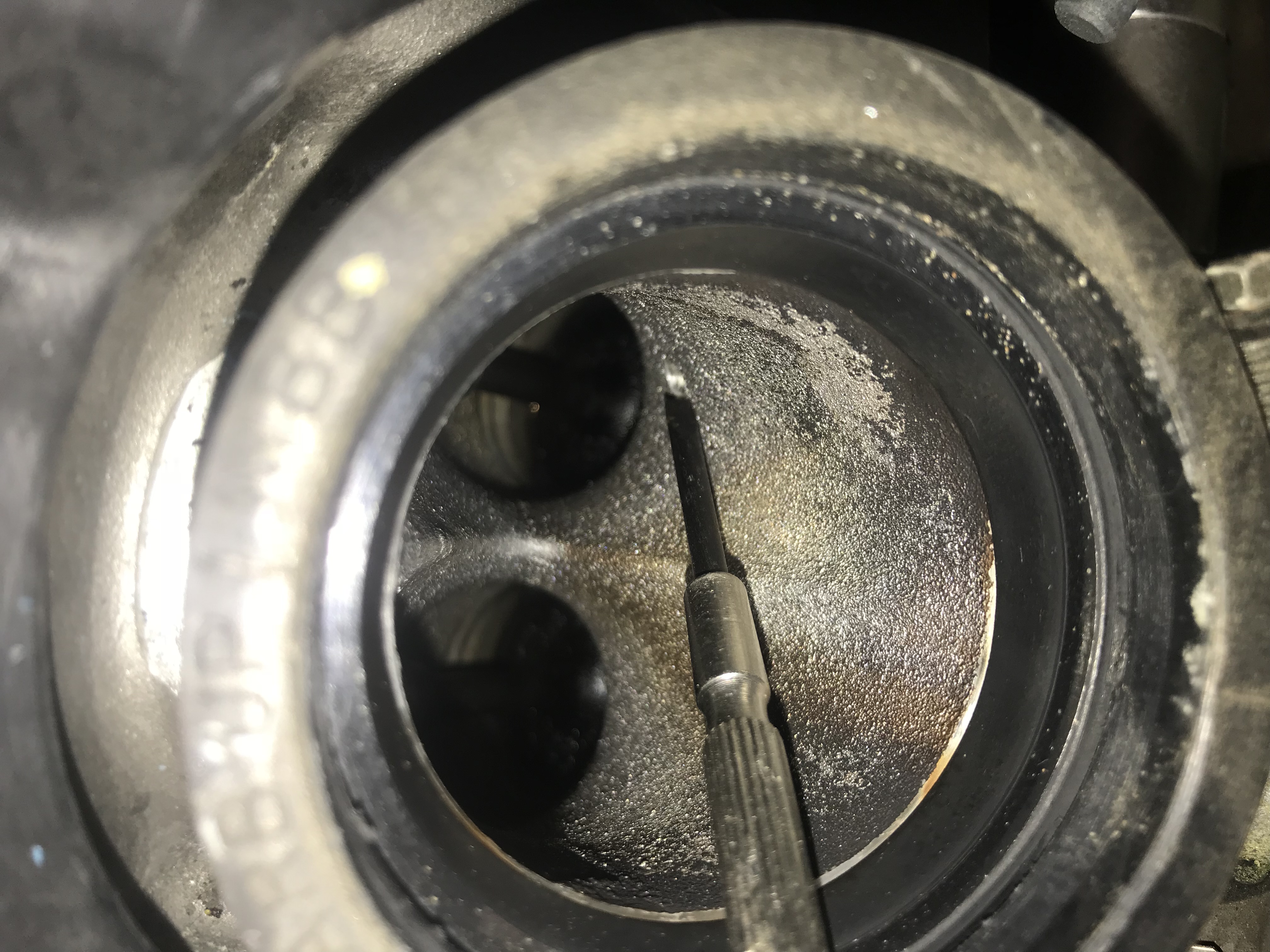

Pulled off the carbs and happy to see easy access to inside right where the brass screw is tapped. Should be able to keep any debris out of engine and lots of room to work.

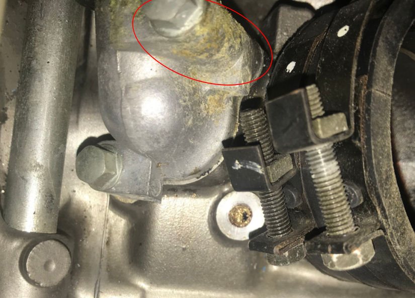

BTW, I forgot to mention.... Might want to address the coolant leak you seem to have.
the crud in the red circle and other spots near is is dried coolant deposits... Likely just an old hose not sealing well or a loose clamp, or both

Didn’t get a chance to thank you for your advice. Thanks! Was able to mostly back out the broken brass fitting. A little remained in the threads so I retapped the threads with the same size to clear the remaining bits. I was able to block off the hole inside so nothing got it. Used an air hose from the inside to blow out any filings. In the end, was able to install a new brass fitting and complete the mod.
Completed all the maintenance and all back together. Thanks again!
