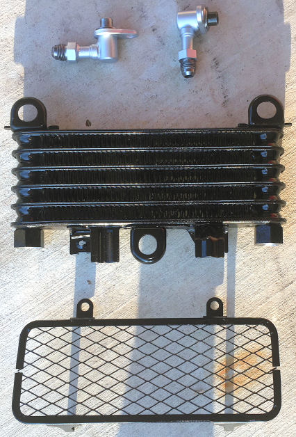

The #2, 2003 cooler looked great in pics, and was either damaged in transit, or was a bait and switch.. Seller went poof after sale,so I ate $30.
#3 cooler though a early year came in overall good shape. The cooler comes with a rock guard, but that did nothing to stop 1~2mm sized rocks from getting in the fins. about an hour in the sonic tank, then an hour picking rocks out with a dull dental pick did the trick.

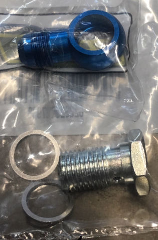

The ZG1000 cooler uses banjo bolt fittings which makes it nice, and not need adapters of any kind.
standard 14MM X 1.5 banjo bolt and #6AN / 14mm banjo fittings work perfectly, available commonly and relatively cheap.

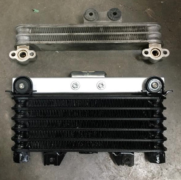

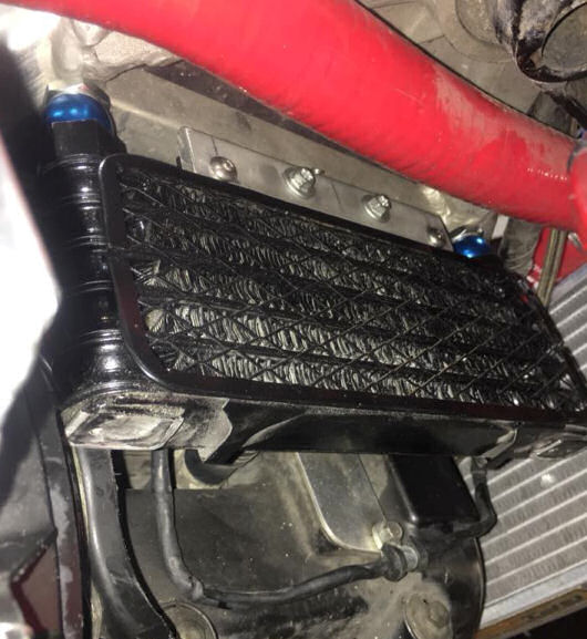

This in my opinion is as large as you would want to go in this location. There is .25" clearance at full suspension compression (springs out)
Any larger, or mounted any lower and you will have contact as well as block airflow to motor and radiators.

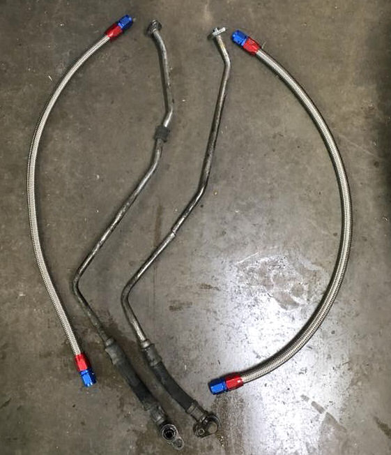

Even in sunny Texas with limited riding in the rain, the stock chrome plated steel lines were starting to show rust spots.
If seen pics of oil lines on UK bikes that the line rusted so bad it broke in half.
So out with the old, in with the new. Stainless steel braided -6AN lines and fittings. -6AN has the same ID as the stock hoses so is a prefect replacement size.
2 row vs 6 row.jpg (64.84 KiB) Viewed 5248 times
It is a tight fit..this pic is actually no longer how I decided to mount it, but it still shows the limited room to work with.
Hose path worked out better with the fittings at the top, so I rotated the cooler and made a new mount. Such is the deal with a custom install..... Folks only see the final product and ask why its so expensiveness to "just mount a cooler for them?" Why, because it took 18 hours to work the install till it actually fit and worked as needed, three mount revisions, two hose revisions and a lot of just looking at it to get inspiration for the next move.
