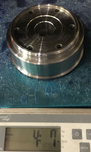

Do do it right?
flywheel pusher tool to remove flywheel without damage
A machinist with a lathe and a specific custom mandrel to mount the flywheel and adjust position to less then 1/2 thousand run out, live center that fits the custom mandrel
And then you can turn out this
finished 4_7.jpg (46.71 KiB) Viewed 4756 times
Fabiostar is your guy on that side of the pond.

hello bobbler ... as has been said. two options, get a proper mandrel to mount it on with the same taper as the flywheel..
or option 2. i have one sitting here iv just finished. you pull your off. send it to me with the bearing still attached. and for £70 crispy pounds i send you this one back with your bearing fitted. chuck it back into your bike and wheelie of into the distance.
