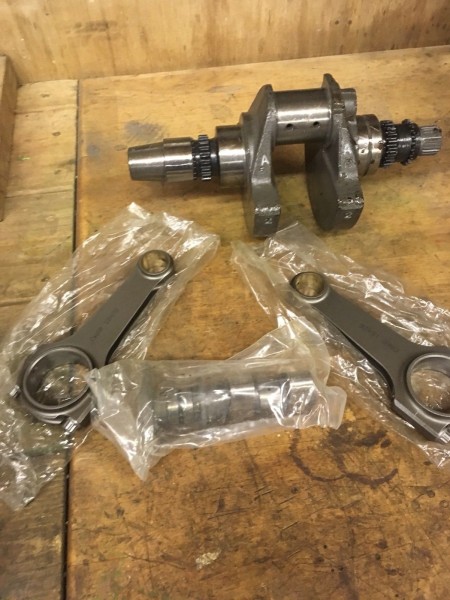

I've just came in possession of some stage 2 cams, H-beam Carrillo rods, and balanced polished crank..
I'm looking for some advice on valve springs.
I've found springs for moriwaki from Hpower, but they're very expensive for springs.
I'm thinking of buying the performance springs from webcams instead.
Any words of wisdom on this subject?

I bought them from a fella on kijiji (classified site). He said he had planed on building a race bike from parts he recieved from a previous owner, but he never did the build.
Im currently waiting on the parts... should be here Monday
Not sure if they are Moriwaki or not. He did not know!! Just said they are stage 2 cams. Custom H Beam Carillo rods, and polished balanced crank.
Anyone know if there is a way to identify moriwaki cams?

would you swap those rods for a nice kidney? low mileage with full service history lol..
regarding the mori cams i scratched my head and ended up getting the info from roger and i got a man who knows more about engines then me to measure them to confirm they were infact mori units.
the mori cams will let it hold onto power higher up but will need the mori or HRC ignition box (which i gather is the same thing) as mines not marked in anyway. but they also give a great boast through the midrange power and torgue wise. from memory mines at 78 flbs from just over 7.5k.

you can get Carrillo custom rods from them. They made a custom set for me a few years back and surely still have the specs. If you want more info PM me.
also, from what I remember from Roger, the HRC and Mori boxes are not quite the same. Remember that the HRC box does NOT have a rev limiter (found that out the hard way). An Ignitech box could be the best way to go (programmable - tried two back in the day but could never get them to work, though others have)
