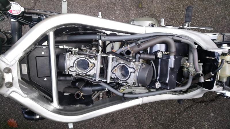

Do what Tony says above for fitting it. Here are some photo's that you obviously didn't take before pulling it apart :wink: :lol: I hope they help,

Mines an 03 and have had this off plenty of times the last 4 wks. There is a bulge on the plastic over that boss, you can just see it here....if you magnify the pic.

yes i can see it in your picture , i took a dremel to mine so it now fits :D
