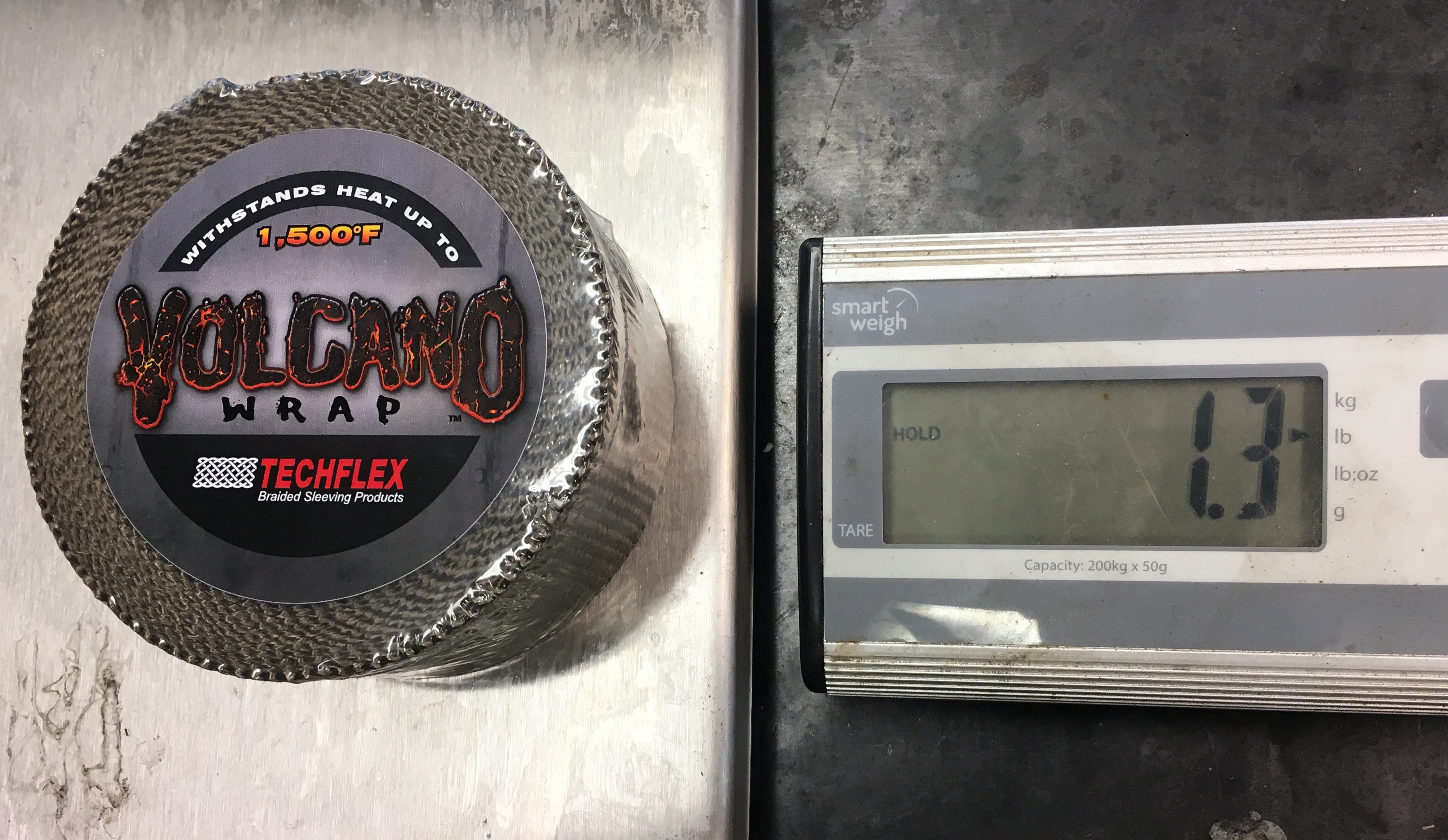

Volcano Wrap arrived, 25 ft roll
it weighs a bit more than I expected coming in at 1.3
pounds.
In the scheme of life 1.3 pounds on a street bike is not that big a deal
on a track bike you have to weigh the benefits to the detractors to decide
For me keeping the heat where I want it and away from things I don’t want it on it’s worth a couple of pounds

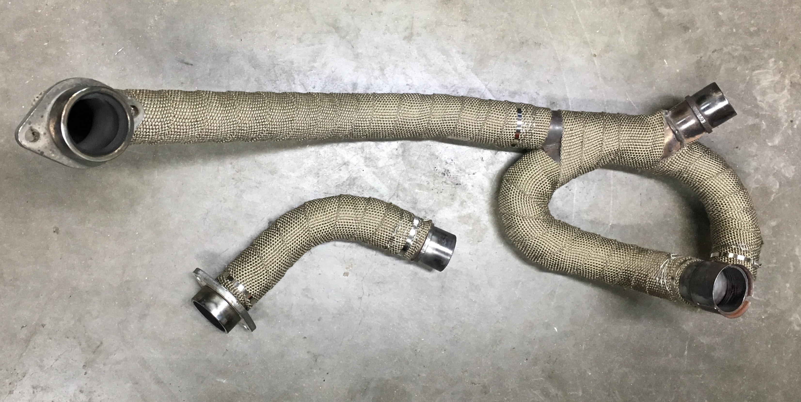

I’ll use 6 stainless steel bands to secure the wrap inplace
So I used most of the whole roll, about 24 of 25 feet.
Overlapping 1/2 width in most places going down to 1/3 overlap on the bends for a better wrap.
I did use all 6 stainless steel bands I ordered and the wrap absolutely secured in place. The wrap however, due to the nature of this kind of material, a wrap it tends to fray if not secured better.
So I used stainless steel safety wire to double wrap in addition to the stainless steel bands

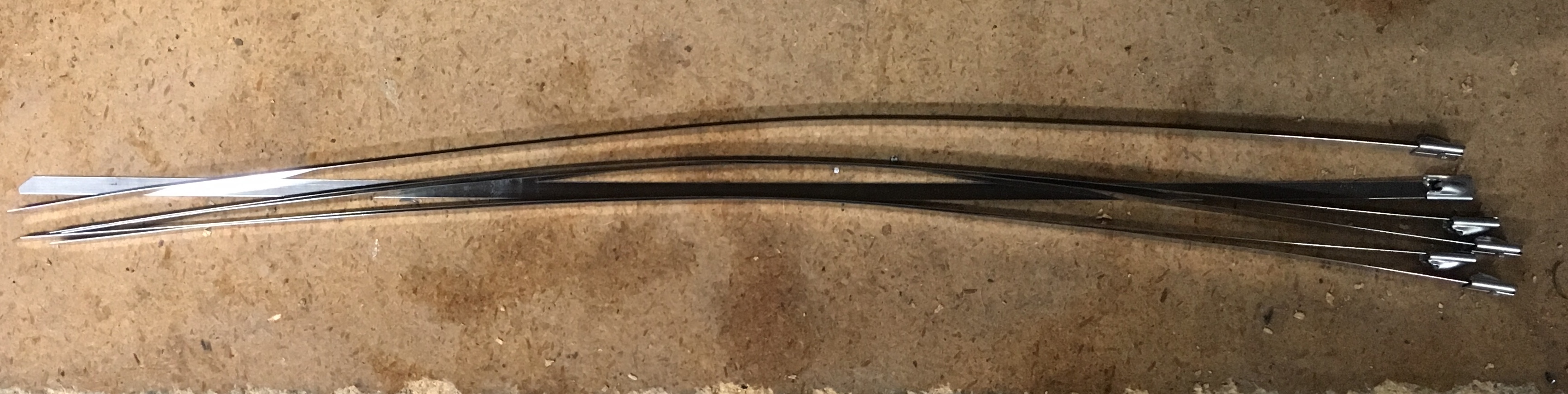

The steel bands give me fits.. The ones I've used and seen are a type lock with a steel ball..
On compressible stuff like hoses or hose overwrap they work fine.. but on non compressible stuff like say vacano wrap over a steel tube, the small back travel the steel lock ball makes to lock up, leaves the band looser than i want on the wrap.
